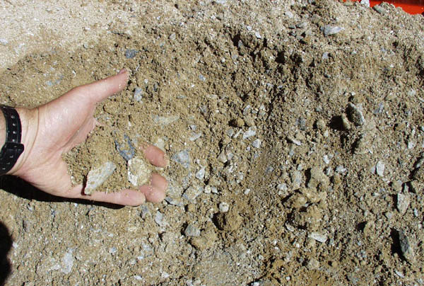

MossRoad is right about gravel. You want something much more angular which will stay put, so some kind of crush would work best. The "crusher run" that I have used is called "non-spec'd limestone". It contains a lot of fines, like grains of sand (see attached picture) and packs down solid, making a very good surface layer.
