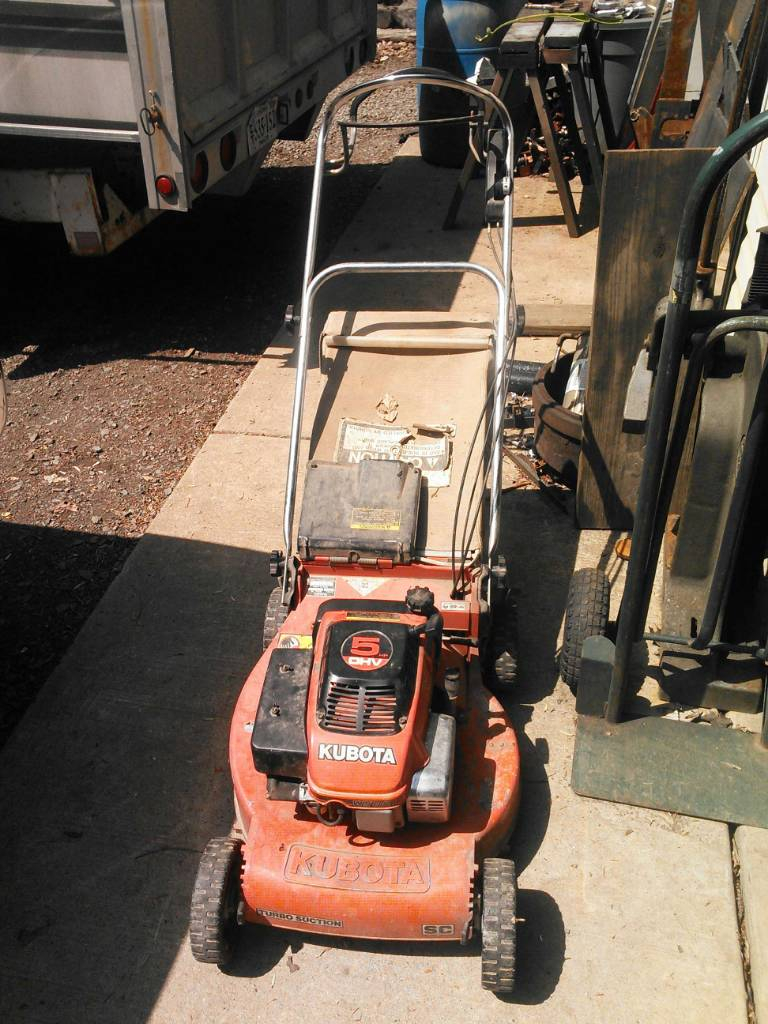

Toro? You need to upgrade to a Kubota to match your other mowers!
I think I've had mine for about 25yrs and still going strong.View attachment 705414
Those Kubota push mowers are very hard to find. I looked for a long time and never even got close to getting a crappy one.
I bought this one used from a pawn shop in 94 I belive, they were still being sold new as I remember seeing one in the showroom at the dealer.
It was the first Kubota product I owned.
They actually just came out with a new model fairly recently that is pretty impressive, although expensive, but it appears to have fixed the few shortcomings with my model.

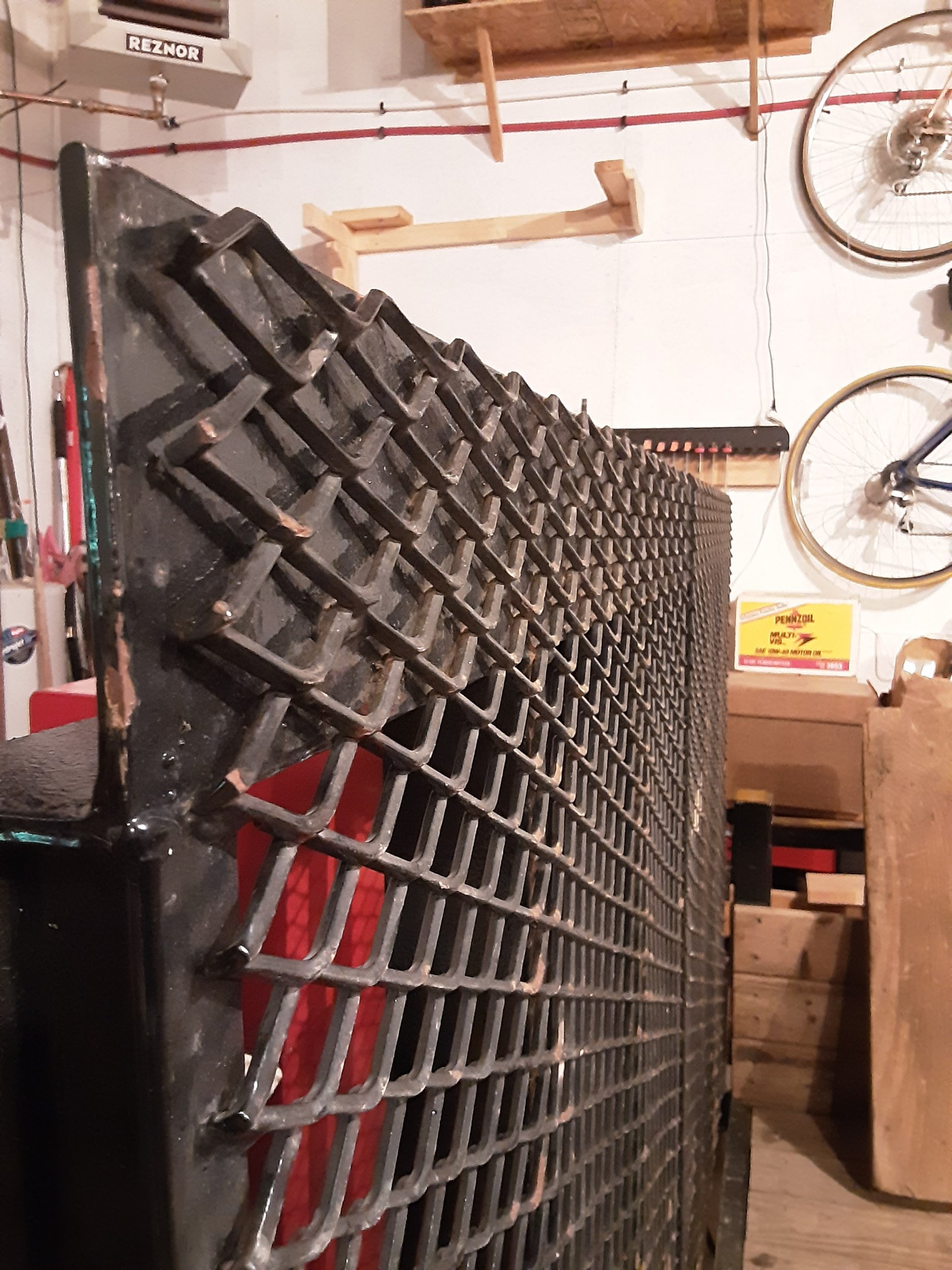

This is an edge view of the expanded metal on my equipment trailer. Length of the diamond is about 2 1/2", while thickness is about 1/4". Each gate half has 4 pcs of 3" channnel on end. The narrow side of the channel supports the expanded metal.. Channels are about 1+ft apart. Your ramps may need to have this expanded metal placed 90 degrees from mine. Good luck OP with your trailer dilemma. Jon
