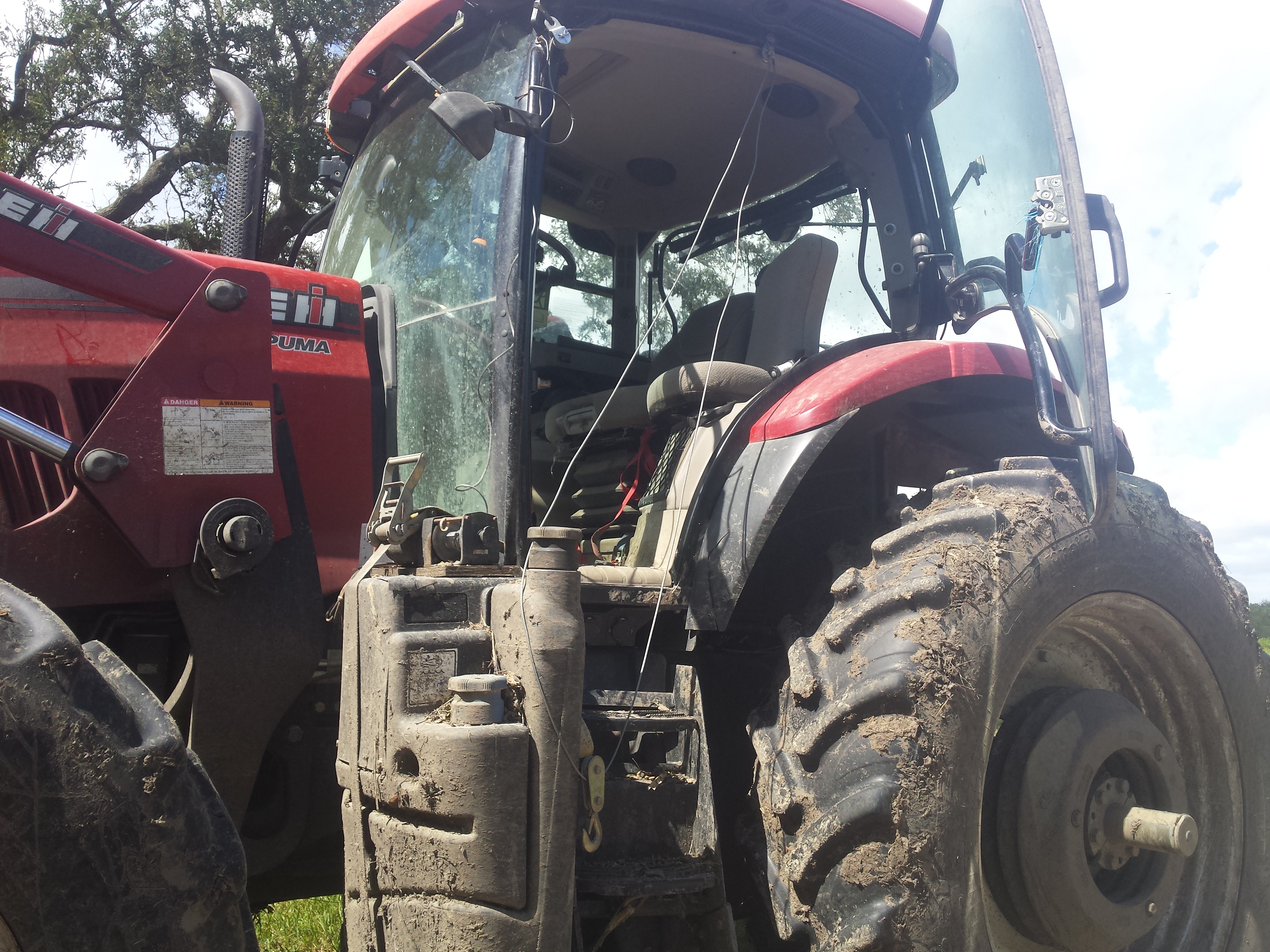

I've been paralyzed for 18 years and started farming 6 years ago. The only mod I have on my tractor is a winch and pulley setup to get in it. I'd like to add more mods such as a clutch/brake lever, an electric actuator to release my quick hitch, and some sort of rear quick hitch. I also have a powerchair rigged up to be remote control and a RZR with a single brake/accelerator lever. Anyone else have any mods to make any equipment accessible?

I currently have a Puma 160 with loader. I have been plowing my own rice fields with a 17ft Krause for the last 4 years. I also have a levee push, ditcher, and leveling blade. I need no help getting in my tractor, but connecting implements, right now, is super exhausting and time consuming if I don't have assistance. Connecting hoses to the tractor is difficult also because the ports are too high. That's why I would like to rig up a rear quick hitch on the draw bar and have permanent hoses connected to the tractor ports that I can connect to separate ports that are on all my implements. I only use the clutch when starting my tractor and I don't really use the brakes when I have the Krause dragging behind me, but when doing loader work it would make my life easier to have both. I am trying to push the limits of my independence. I am actually a C5/6 quadriplegic which means my hands and triceps are paralyzed. I rely on a powerchair to get around, but I live alone on the farm and do almost 100% of the tractor work. I have a 1660 combine I'm looking to get customized for me as well. I'm not necessarily looking for help, but any advice is much appreciated. I'd like to get in contact with more wheelchair-bound farmers and see how they overcome the tremendous hurdles of farming.

C5/6 and farming by ones self is a tough one. I have a couple of friends that are in the same situation that do a lot of things but hooking and unhooking 3pt implements isn't easy for someone that has full strength in there whole body on a big tractor. I'm a para T6 and I do it but it isn't easy and I need every ounce of strength I have to do it. I find hooking a PTO shaft up to the tractor is a real PITA and it takes me hours sometimes to get it on there.
The ideal setup would be to hook what you use to each tractor and leave it there, not always possible but that would be the perfect thing to do.
I'm not sure how you are clutching your tractors without an extension of some kind? Brakes, clutches hand controls are easy, the 3pt hooking and unhooking is the problem.
Do you have pictures of your tractors? cab setup, transmission, pedals, seat, winch, pulleys etc?

I don't use brakes. I just downshift then shift to neutral because it's so flat around here. I don't care for adding hand control linkages to the pedals because my legs would get caught up in them. I have muscle tone so I can hold the clutch in if I put my foot on it. Letting off is another story sometimes. Only mod I have on my tractor is this winch/pulley setup:
The winch cable runs up to a pulley at the top/front of the door, then over to another pulley mounted over the trainer seat, then through a pulley hook and finally back up to the second pulley. I have a wireless remote that I press with my teeth as I guide myself up. It's really simple. I wear a mountain climbing harness to hook to.

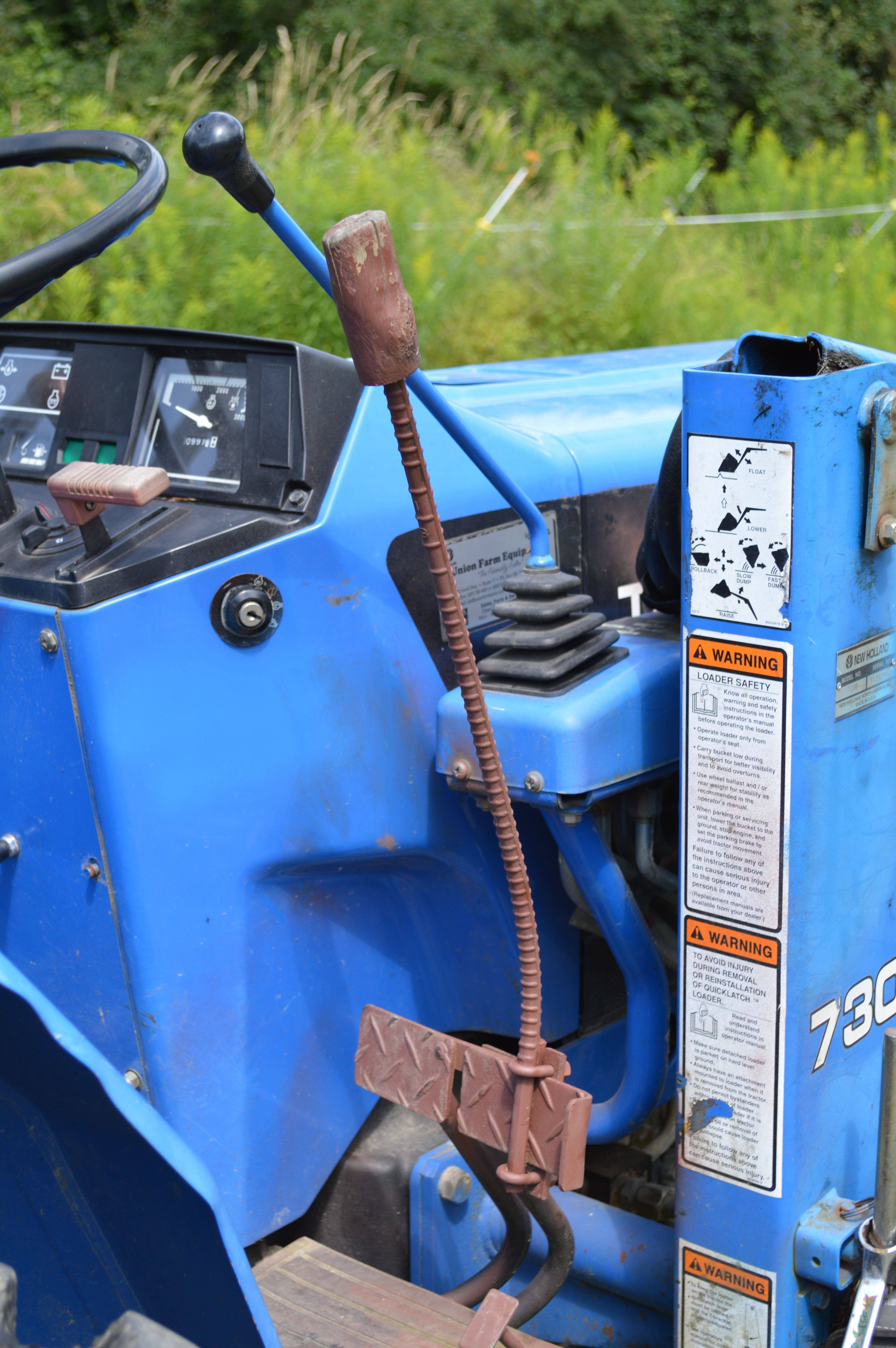

I walk with 2 canes and this summer I started toting an oxygen tank around with me. I use a scooter to save my breath.
I have two steps to climb up onto my tractor (1st one step then I added the lower step) and a hand lever attached to the pedal for braking. I've mounted the seat further back because I can't fold my legs and use them spread apart..40760788_10212790698537574_757520201087451136_o.jpg42510404_10212920020010530_8058548434841370624_o.jpg
