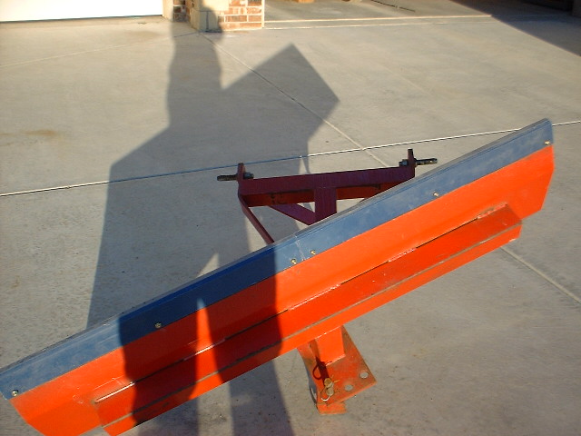

You mean like this? J

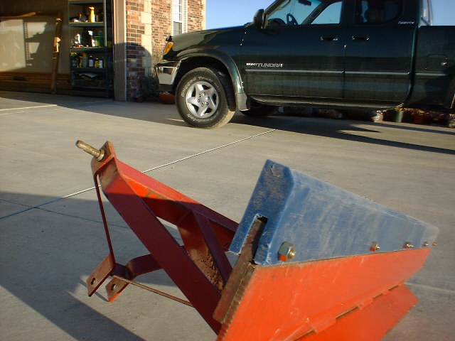

and this? J

   / Disappointed with rear blade #33
Trescrows
Looks like that would do the trick!
Does that replace the cutting edge on the blade or go over it?
That's what I was thinking of for the loader bucket edge as
well.
Where did you acquire such a beast?
thanks
del
   / Disappointed with rear blade #34
My cheapo back blade was purchased strictly for our occasional snows. The cutting blade is not removable. I attached the nylon material over the blade with several bolts drilled though the blade. The material is high density nylon type stuff I bought at a local surplus store . It cuts nicely with table saws and routers. J
