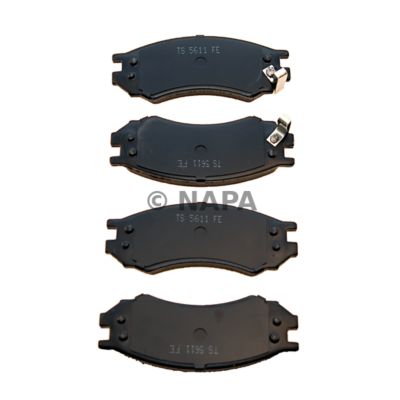

I have every intention of calling and getting an explination.
Because that retainer/squeaker retainer has the little tab from the hardware (antirattle) stuff that goes through it. Have never been changed on this car and they are on the TOP. So I "assume" that is the technically correct way they go. AND thats they way they are installed.
Been awhile (6 -8 months ago) since I did these pads and have done several since. So I didnt recall just what these were like until I took it apart yesterday.
I am used to their being NO little retainer thing, let alone it being part of the squeaker.
Just used to two tabs. And IF a retainer is present its part of the backing plate and no regard to orientation.
The fact that these pads have the retainer/squeaker that get sandwiched by the pad and caliper on the one side....maybe it makes a difference? But I dont forsee any issues even if wrong.
I am used to pads like these for my saturn That the only dilema is, squeaker on the inside or outside. But given the pads are identical, One will be on the top, one on the bottom if they are both put inside, or both outside. To keep both on top (or both squeakers on bottom) one will have to be on an inside one on an outside
And pads for the wifes truck make it easy. 4 identical pads, all 4 with squeakers

Found a good 1 min long video that shows what I am talking about with that retainer and squeaker and the little tab from the hardware clip
Nissan Altima Front Brake Pads and Rotor Replacement - YouTube
Still puzzled though. Because thats exactly how they are installed? So what made the dealer think they were upside down?

Appreciate your concern.
But I got a college education for automotive mechanics. Never went into the trade because I didn't like the fact that being a salesman, and trying to upsell the customer and nickel and dime them was a part of the requirement to fix cars. So have held many titles since then including electrician, multicraft mechanic, machinist, millwright, etc. Have rebuilt dozens of motors from the ground up, including my own machine work, boring blocks, grinding cranks, etc. So no, I am not a "backyard mechanic".
I do many brake jobs a year. Most times its 4 identical pads so orientation don't matter. On these, the only difference is which way the squeaker is oriented and that an anti-rattle clip hooks into it. No safety concerns at all, just convince. The pad would operate just fine even if squeakers weren't there. And the fact that they ARE installed correctly.
