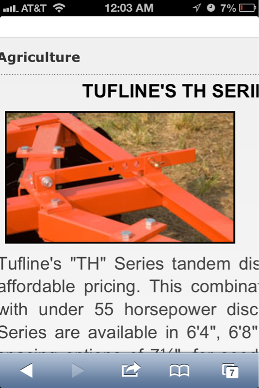

I have the notched blades.
Here is a pic from website. I don't know about lever adjustment, but I simply pull a pin and slide the gangs to the desired angle and reinsert the pin.
Here's a picture from their site:
