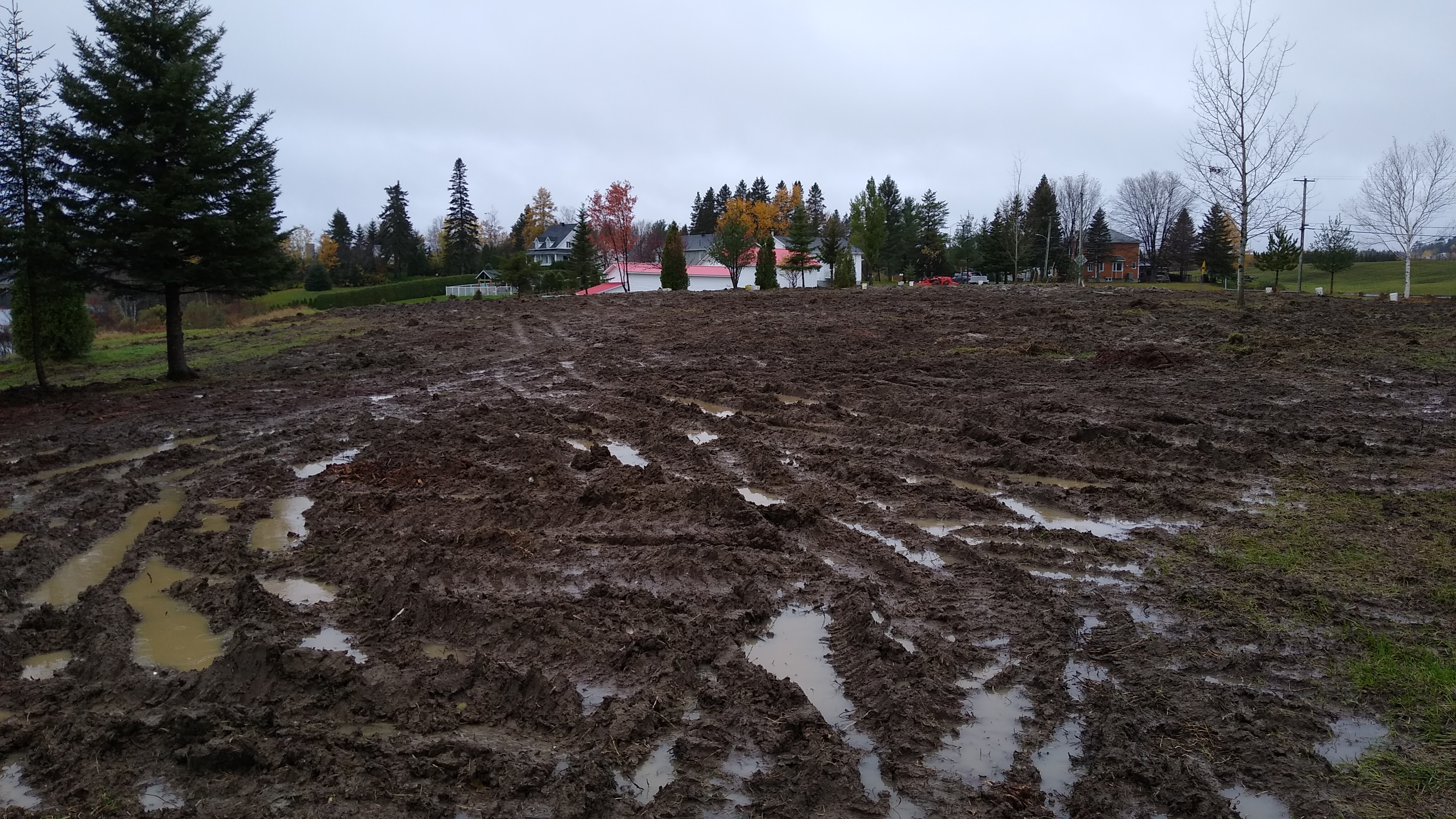

Disc Harrow or Foward Tiller new field with rock & root after passing with Box Blade
I just bought 2 acres of land that was full of small cherry tree , weed and grass. i cut all the tree , removed the stumps and passed many time with a Box Blade BB2560 behind my L2501 25HP Tractor 62'' wide. There was a lot of rock in MG112 gravel on top of existing natural clay soil from golf ball to Grapefruit and some bigger like Cantaloup. There is not much roots left but still some. I have a Tiller brand new Gear drive RGA1258 coming next week. most soil type is clay under the roots and rock. i am planning to seed grass in two years as next summer i want to prepare the ground with the right tools. I dont want to damage my tiller that cost $3k with still lot of Rock left. A Land pride disk Harrow DH1560 cost also $3k but only has 38lbs per 18'' disk. Many Expert on this forum mention to have at least 45LBS per disk minimum size 20'' that are hard to Find in Canada. My question is : is it recommended to buy and use a Disk Harrow 60-66" 600lbs-900lbs with 45lbs per disk and 20'' diameter Disks for my needs, or should i just use my tiller and may be till shallow to level the ground and break all the big chunk of grass left by the tooths on my box scrap that i passed and possibly repair the Tiller. IMG_20201011_141841349_HDR.jpgIMG_20201010_113840709_HDR.jpg20200918_085150.jpg

Bon Jour Monsieur Dumais,
Giles, the first thing you should do is go to your kubota dealer and ask where
you could hire a farmer and his tractor and rock picker to remove any hidden rocks.
If he knows of anyone with a Schulte or Degelman rock picker that you could hire
it will not take very long to clear your plot of rocks. Pizza and beer bribes
are always welcome.
After that you can spread 6 bags of gypsum to dissolve the clay and two weeks
later spread 4 bags of pelleted lawn lime and till that in in one shallow pass and
then plant grass seed this year.
You need gypsum to dissolve the clay and pelleted lime to bring up the soil PH so
you can plant grass this year.

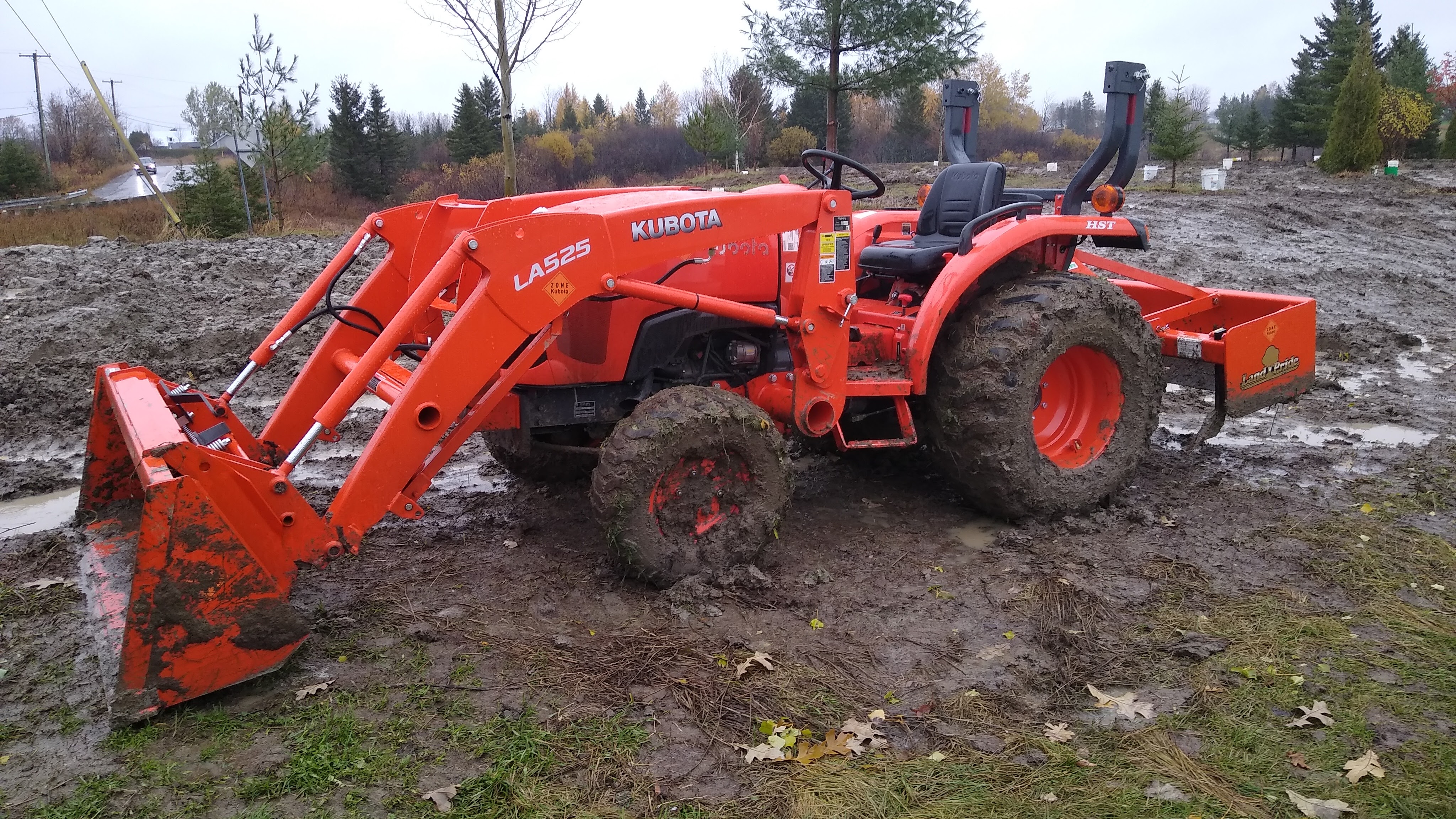

Use your new tiller. Assuming your tiller has forward rotating tines you should not worry overmuch about damage. If anything breaks it will be a relatively cheap and easy to replace tine. With prudence, which means tilling moist soil, tine breakage is unlikely with moderate use in just two acres.
A 2,700 pound L2501 is not heavy enough to pull a Disc Harrow with 20" diameter pans at sufficient speed to fling dirt, thereby leveling.
A Disc Harrow with 18" diameter pans will float over your soil, rather than smooth. 18" diameter pans are relatively thin and always scalloped. Thin, scalloped pans are as likely to be damaged in your stoney soil as roto-tiller tines. Roto-tiller tines are easier to replace.
Disc Harrows for compact tractors have pans spaced either 7-1/2" apart or 9" apart. When the gangs are set on an angle to move dirt the gate between pans is reduced in width. A Disc Harrow with pans spaced 7-1/2" apart will likely clog/jam frequently with with the rocks you have pictured. I believe all Land Pride Disc Harrows have 7-1/2" pan spacing.
PHOTO #1 Never transport a heavy load like the stones pictured without the ROPS up and your seat belt securely fastened. The scenario pictured is courting personal injury. Bad practice will get you, sooner or later.
When the tractor is righted, being a diesel, the engine is unlikely to start.
As Three Point Hitch counterbalance to FEL loads your roto-tiller is likely heavier than your Box Blade.
You may wish to consider a $/US400 Middlebuster to loosen particularly tough areas and feel for boulders.

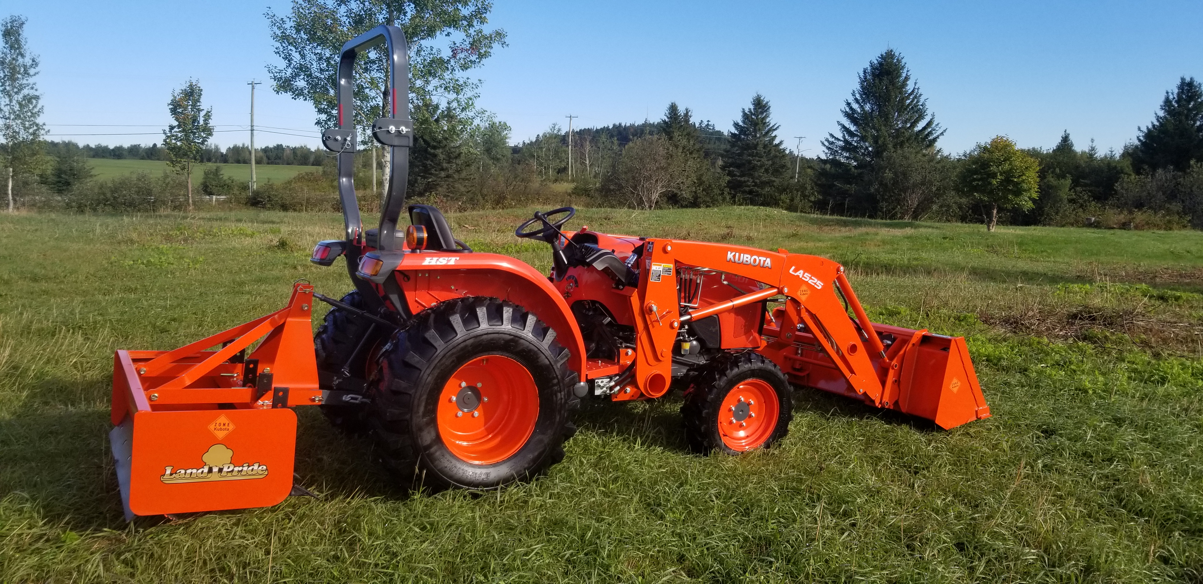

So after reading many Forums i was questioning myself about the pertinence of acquiring another attachment to save my Land Pride RGA1258 Tiller 525 lbs , but they seem to cost the same or more and being as much fragile and not adequate to do the job by floating and requiring many pass. i first looked at Chain Drag Harrow, then at Spring Tine cultivator then finally at Disc Harrow. Also once my 2 acres level out and seeded there would be no more use for that extra attachment. My tiller was bought for my 1000 sq feet garden , in replacement of my small F501 Honda tiller.
So Finally i should do more passes with my Land Pride Box Blade BB2560 471 LBS with the spike teeth (scarifier) all the way down like the beginning and with the top link shorten so the box blade is angled forward quite a bit in order to have the rear cutting blades just barely touching the ground. This way i will hit and pick most of the rocks and root before the Tiller do to limit his damage. And tilling would require only one slow single pass thereafter versus many pass with Harrow.
Here is my question: should i limit the tiller depth to few inches only when tilling to only level out and limit quantity of rock being hit has there will be no more tilling in the future on this lot. Should i also have the back panel all the way up to have the rock spilled out in the back on top of the soil so that i may pick them up after. I presume with back panel down the rock may return to ground mixed with the dirt and some dent cause on the back Panel. Should I also lower the RPM when tilling and or drive slower to hear the rock or root being encounter.

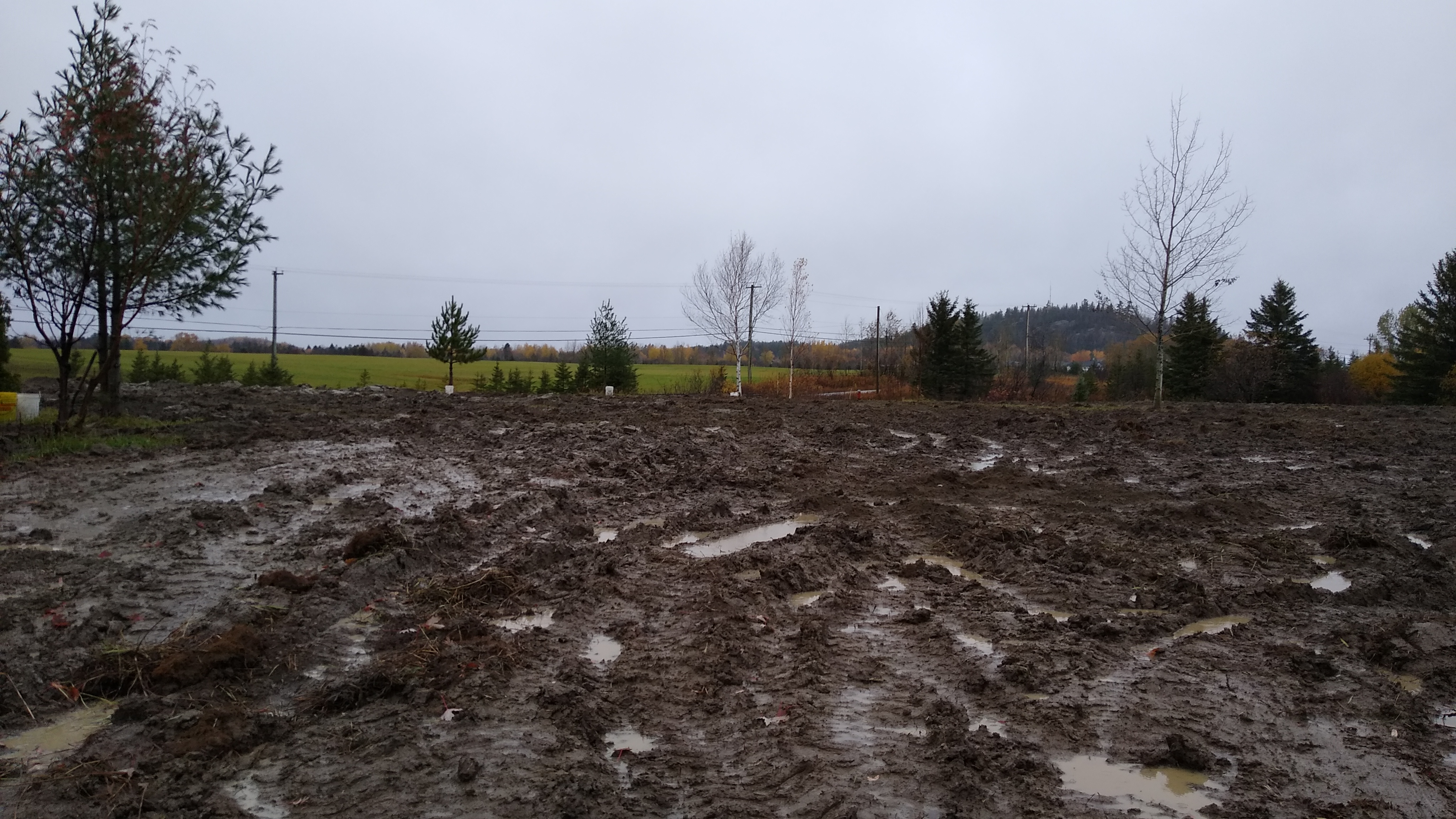

A few observations:
1. Your only clearing 2 acres.
2. Farmers have been clearing land with horses and small tractors for 100+ years and didn't have 20 inch disc blades with 45+ pounds per disc. This size is not a requirement. No requirement to "fling" the soil to be effective.
3..Once the top is loosened a heavy drag will do much more levelling than a disc harrow. Many pull the drag behind the disc. Use the box blade for big leveling and the drag for the smaller. A drag can be simply a heavy lumber beam or an I beam. Many times I pull a drag behind a box blade. Often with blade slightly up and rippers a little down.
4. Running a tiller in this land will sound like you're processing at a rock quarry. HD tiller can take it but it will take a beating.
5. Bobcat with a soil prep device can level and pick rocks and roots in quick order and your only prepping 2 acres. Are there rentals in your area? Even better maybe a contractor that has reasonable prices?
6. Noticed in photos things look wet? Don't expect great results working wet.

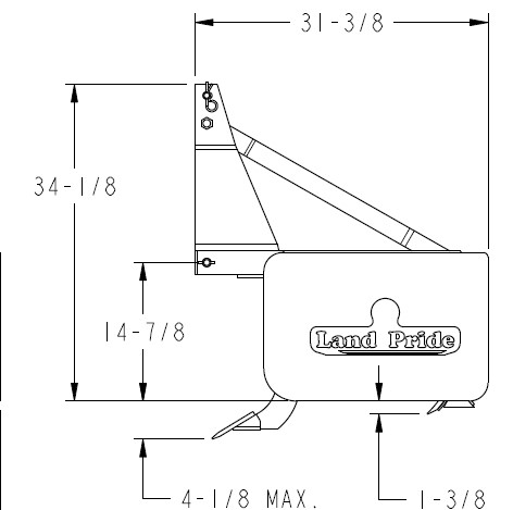

It is very hard already to pull the Land Pride Box Blade BB2560 471 lbs behind my 3500lb tracter loader HST L2501 full throttle 4WD at low speed with only the Ripper , Shank , Scraper or Scarifier touching the ground being setup all way down and angled foward to prevent the cutting blade to touch down. It is a good thing that at last minute i changed my order from 66'' to 60'' box blade both with still 5 shanks on itbb2560as.jpgIMG_20201020_092052408.jpg
I had to weld the tips on 3 of them already as they came off by hitting the rock. So yes i could may be go deeper by tilting forward the box blade further to have the ripper go down more. I guess the more passes i go through the easier it will be for the Tractor as the ground would become looser. For now it is big chunk of solid grass with some small thin roots. But the more i go over the smaller they'll get.
Now it is rainning all day long and winter is coming. Cannot work the lot anymore in full wet Clay as the wheels are spinning with attachment up, not able to move foward or reverse. will have wait next summer.IMG_20201020_104109625.jpgIMG_20201020_104330447.jpg
