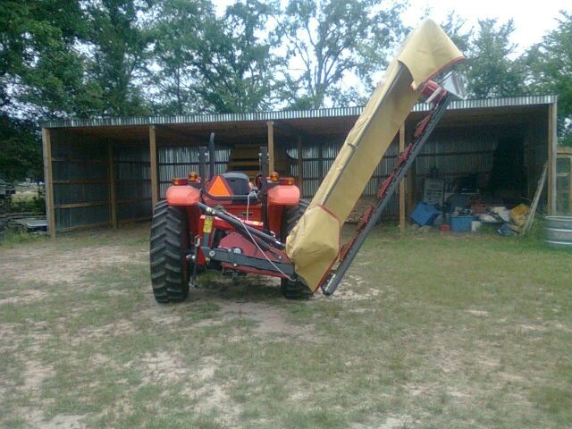

/ disc mower advice #25
Simple solution is put disc mower on a caddy. Easier to attach to tractor,easier to transport with a tractor or pickup and IMHO follows contour of ground and corners better.
/ disc mower advice #26
That would be a easy solution:thumbsup: cutter up all the way.JPG I now run the cutter behind a 7040 and it does fine without the loader on...
