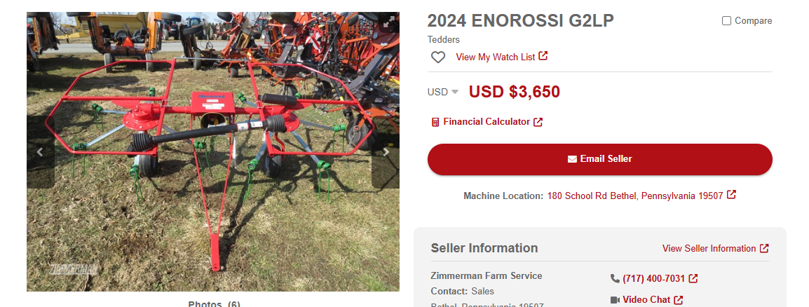

I might even try a Pequea 8’ fluffer type tedder since they’re dirt cheap.
Not leaving any ideas off the table.

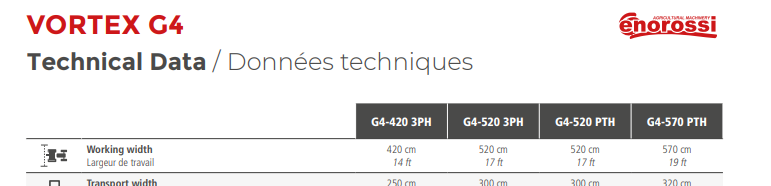

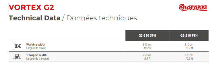

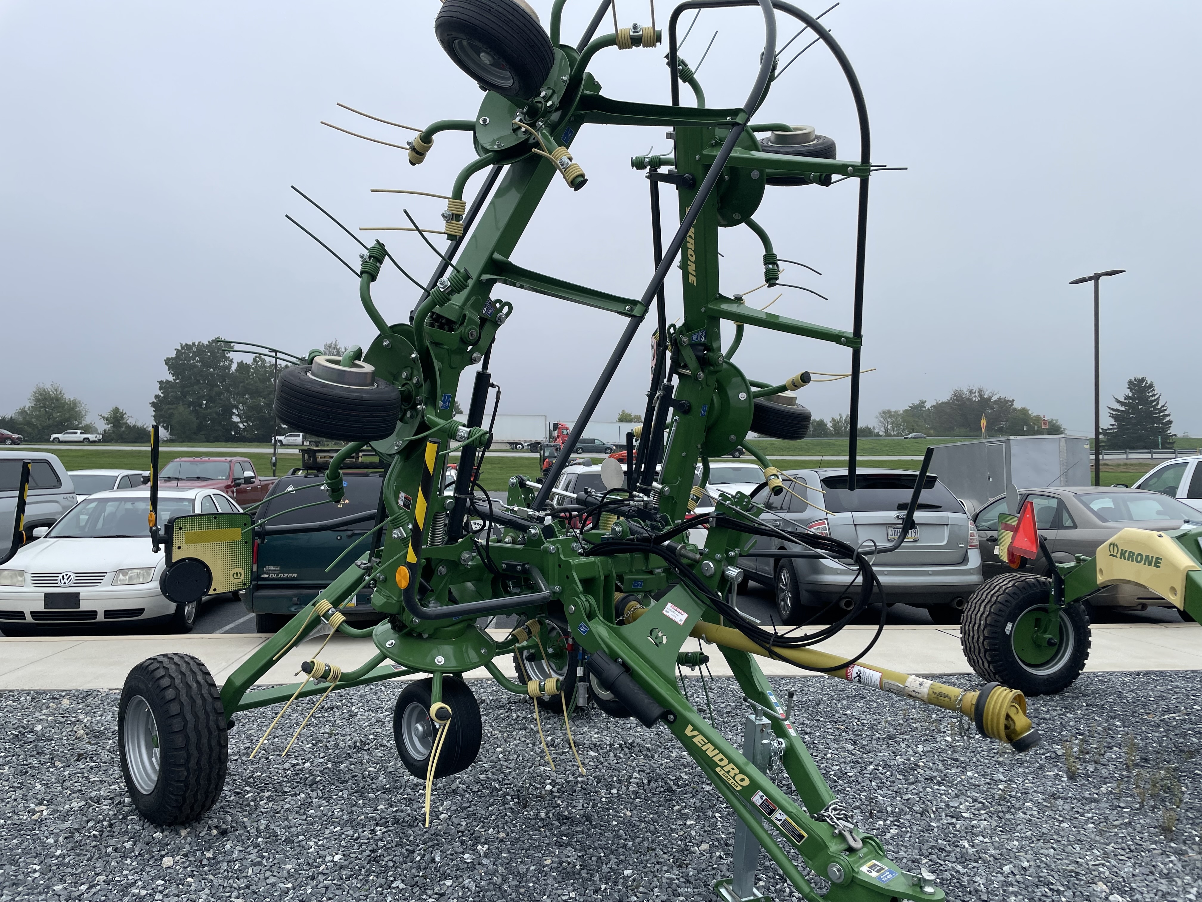

Our 4 rotor Kuhn trailing tedder does a good job of tedding, traveling can be another story. I see that they have a 6 rotor 21'4" which would give just a bit of over lap and it is 3 point mounted so the transport should be much more stable then a trailered unit.

2 rotor brand new, 10" wide.
They have a four rotor vertical fold at 19'
