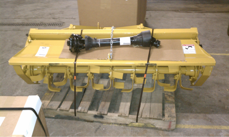

Nobody has more rocks than us in the North-east..I have miles of stone fences and lots of rock piles...farmed since 1850....tiller does work but you must keep the discharge flap full OPEN.Kicks 99.9% out the back.I had one flat rock about 15in. jam my tiller up....the slip clutch worked!I have a cultivator too.....takes a lot more passes with that to break up plowed ground.

I would lean towards a tiller. Minimal passes, usually one or two and all is good. Even if you did not plow first in your established garden
A disc will work, but many passes would be required. And it would not be as nice and even and fluffed as a tiller would leave it.
If breaking new ground or expanding the existing garden is on the list, I would still lean towards the tiller even after using the plow.
Rocks and tillers dont get along but, the worst things I have had happen is a brick one time and a rock another time stopped the tines cold and the slip clutch on the tiller went to work and Nothing broke. HIGHLY recommend a slip clutch for any tiller.
TSC sells king kutter tillers I believe, and that brand if you do a "search" on them and read up they are darn near bullet proof.
I am going to be upgrading my gear drive maletti 48 incher to a 60 inch king kutter before long

I'm in the exact same situation. While my plow and a disc sure would be lots of fun, think of this: What if down the road, the garden is all established and you wanted to till just select areas and leave others undisturbed? I think you'd have a great deal of difficulty with a disc. Piece of cake to run down a row or two with a tiller. I'm going with a 60" King Kutter tiller myself.

Well........ordered! Everythingattachments has the 60" kk tiller for a good price with free shipping within a 1000 miles so I went ahead and ordered it. Now I can't wait to get it. Thank you for all of the responses!

Myself, I won't be going back to the Disc set....The tiller does a very nice job of pulverizing the soil...Not sure about big rocks?? It does have a shear bolt on the drive shaft. if it becomes a problem then I will buy a slip-clutch for it..

Guess what I ordered? Came in yesterday......can't wait for good weather! Thanks again everyone!
