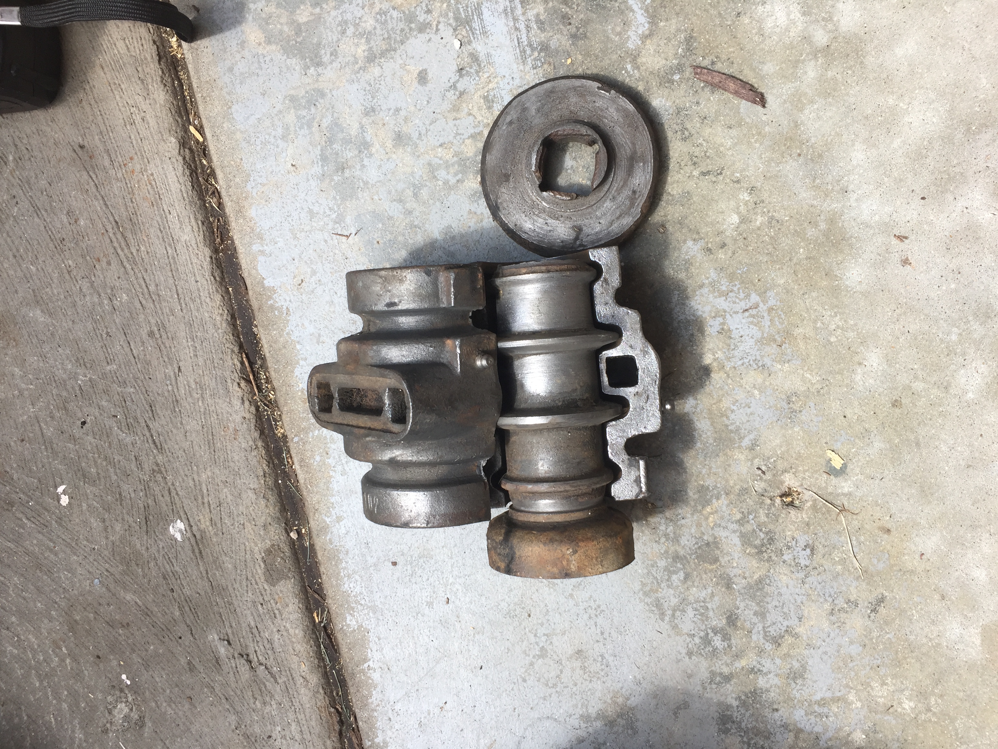

OK, I got the nut off and the gang apart.
So it appears the busted part is the bearing spool 7-1/2" Ribbed Bearing Spool
The blades, the bearing, and the spacers all have square holes, I have a round axle. Is that right? Seems like I need a square axle to go with all of these square holed parts?
Thoughts?

Yep you're right you need a square shaft. Gotta be the right length because you only have a few threads to play with on the nut side. On the end with the square plate there is usually a round part called a bumper, it"ll have a square hole also and the shaft will have a square head that fits the hole in the bumper. At least that's the way mine is.

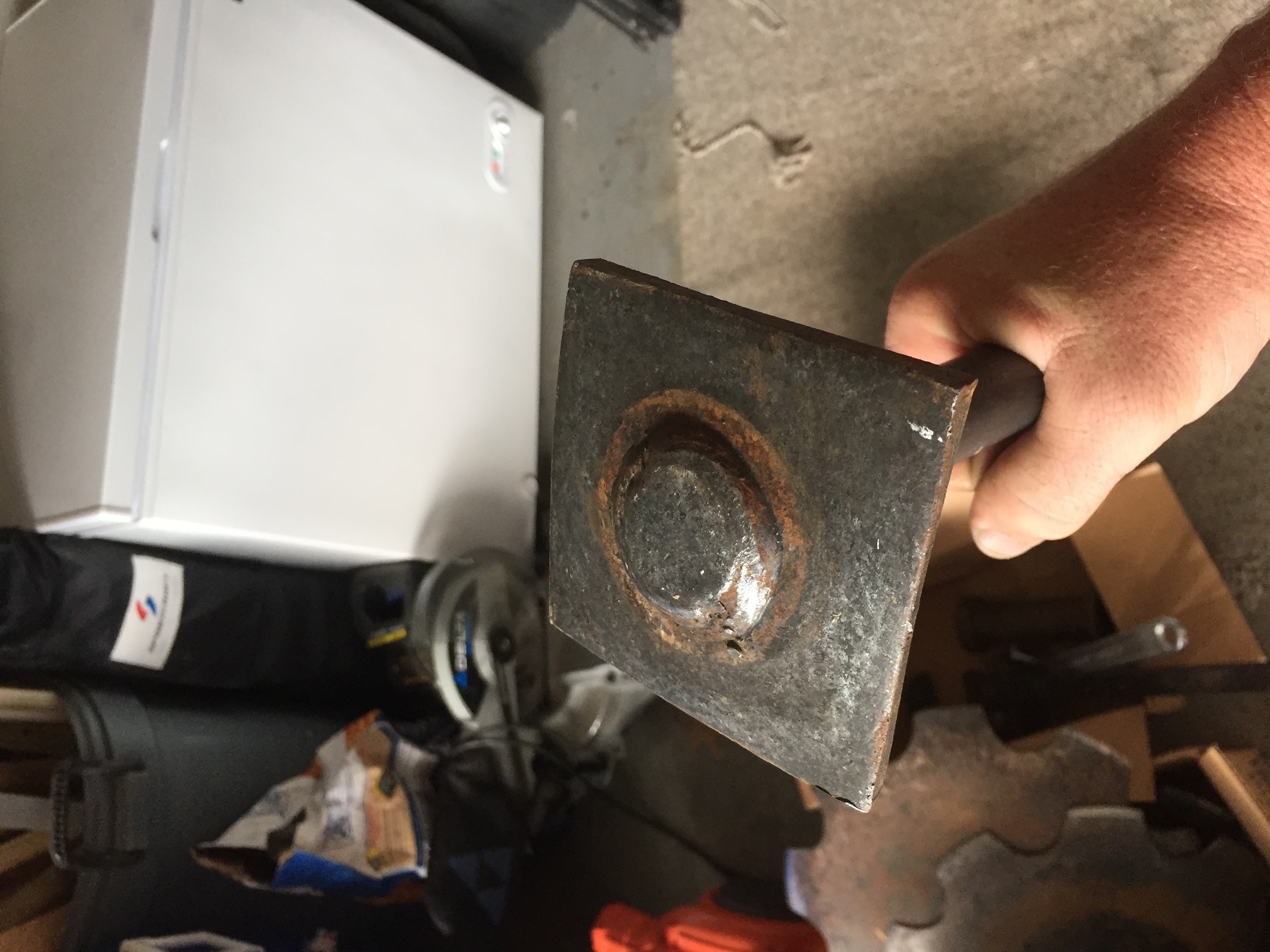

This axle is a 24 and 1/4 in long

I wonder if this gang is a total mutt. I had an inch or more of thread to play with, and it was sloppy. Some of the slop could have come from the busted spool bearings. Need to get the disc and check how the other gangs are set up

kthompson....not sure what you mean by the axle head. The only thing to grab onto is the nut, the threaded stub of the axle protruding from the nut, and the flat flange on the other end, that is almost totally flat... I can't see anything to grab onto to turn against when I am loosening the nut.
I am being dense?
No you are not, I did not word the best. The flat end of the axle to me is the head end. With round axle don't think there is any other option unless a good impact wrench can turn the nut faster then the axle can with at least some drag on it by the blades and spacers.
