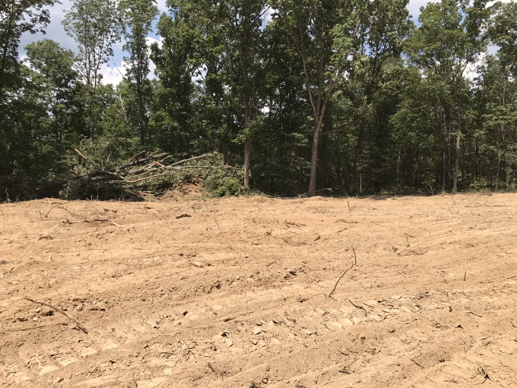

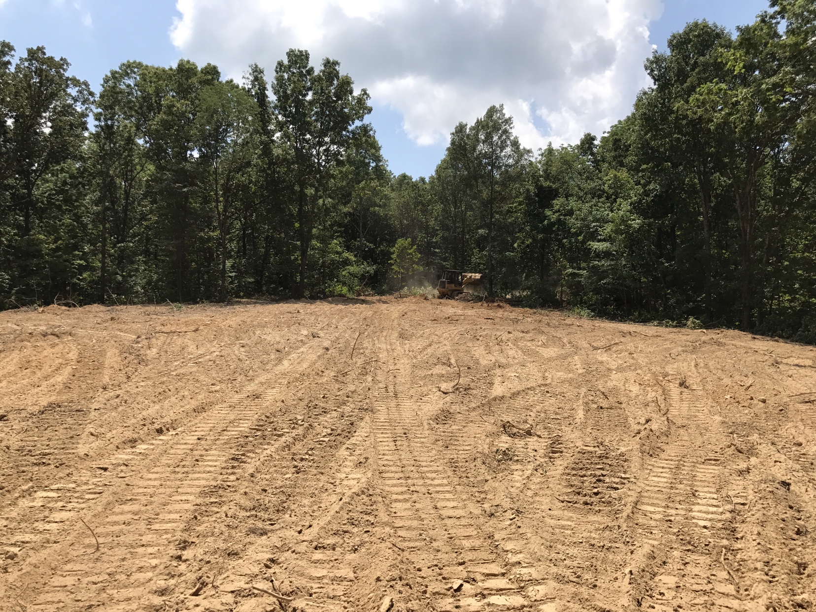

Here are a couple pictures of my cleared food plots so you can get a better idea of what I'm working with.

Thats pretty sandy soil from what I can gather from the pics. So you shouldn't have too much issue.
I do all my discing with an old Oliver Super55 34 hp and about the same size/weight of an 8n. I got one of those economy grade 18" 6.5' disc from TSC and it handles it no problem on the most aggressive setting. It is light so I had to add 400# of weight to it to help it dig. My soil has very little clay in it so it is pretty easy to cut into and work.
Your 950 while having less hp than my Oliver probably has a better torque curve than my old gasser but Im guessing my tractor beats you on weight. If anything I think you might loose traction before you loose power to pull a 6.5' disc still downsize to a 5'.
Run that plot a few times with a disc and then go over it with a chain harrow and you will have a bed good enough for seeding.
