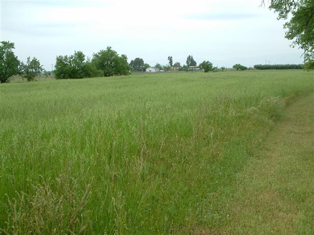

I plan to buy a leinbach 20 gang 18 inch disc (B245 - 20 -18) for use with a Kubota L3430. I have 34 HP, 4WD with loaded R4s. I'll be plowing and discing about 7 acres of unused (mowed) land to turn into pasture. Do I have enough tractor? and is $909 a good price for the disc (new)?

I'd say it should be no problem but we don't know what type of soil you have and if it's clay or a hard soil with stones expect to be there a while if you don't plow or roto till first!

It's mostly clay, plan to catch it with the right amount of water. hopefully my old 2 bottom plow will hold up. and it may take me into next year to finish. but the weeds in this field are decades old and very established. only good news is it was farmed long ago so most big rocks should be gone....I've seen stacks of them in the wood line.

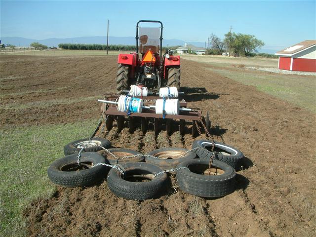

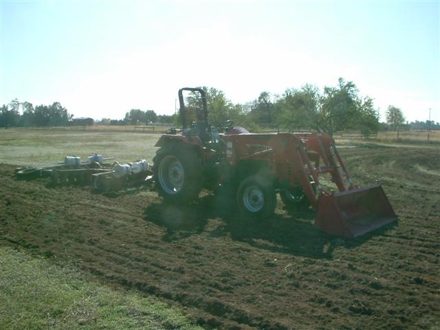

I plant oat hay on 6 of my 10-acres (flat valley land). The top soil is thin, gravely loam 4-6 inches deep with a lot of clay underneath. Plowing in this case is not advised since I would just be inverting the layers and burying what decent topsoil I have. So I use an old 6.5 ft wide Towner off-set drag disc (a gift from a neighbor plus about $75 in new parts) as my primary tillage implement. I hook a homebuilt drag onto the rear of the disc to bust up the clods. My tractor is a 2008 Mahindra 5525 (54 hp engine, 45 hp pto, 2WD, gear tranny, power steering) and has no problem pulling that small disc. Your tractor should be able to handle that 6-ft Leinbach disc with its 4WD and loaded tires.

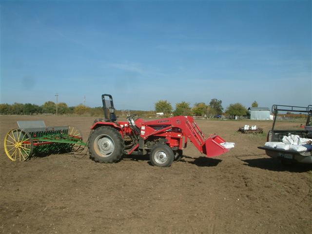

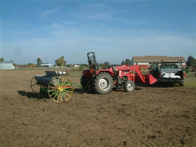

I plant with an old Minneapolis Moline P3-6 grain drill (10 ft wide, 20 hoes) that I bought from a neighbor- $275 for a pair of these drills and about $200 in parts.

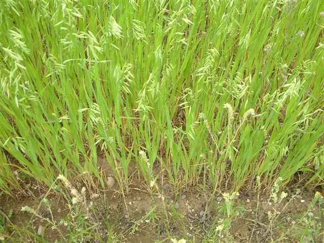

Planted Kanota oats--turned out OK in that thin soil
