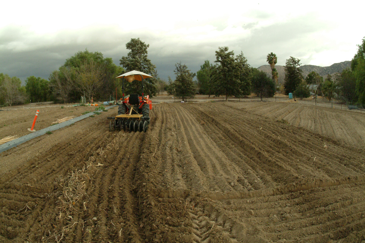

I guess I can give you some good feedback because this is what I have been doing for the past two years. Well pretty close.
I have a B7800 Kubota, I pull a Gearmore 60" Tandem Discs weighing in at 525#(http://www.gearmore.com/catpdf/Cat_P25_P26.pdf).
The B7800 pulls it without any problems. During the summer it takes a couple of passes here in Southern California to break the crust layer.
Some things to note>>The discs stick out pretty far in the back. When lifting them you notice. I have a bucket on my 7800 so I have no problems, but without a bucket you might need some weights in the front.
Regarding traction. Maybe 3 or 4 time I have gotten the dirt really soft where the disc have just sunk past the 1/2 way point cause a traction issue. Easy to fix, just lift the discs a little bit. No biggy.
I try to disc after a light rain. .25 or .5 inchs. Work great the next day. If you get a lot more, then you may have to wait a day or two. Mud just doesn't disc well.
Hope that helps. Let me know if you need anything else.
Chuck
