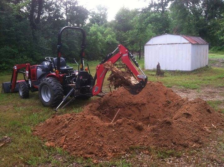

Purchased a new 4540 Mahindra tractor with front end loader and backhoe this spring. The hoe had multiple issues. I kept breaking teeth on the 16" bucket digging tree stumps. Mahindra told me the backhoe wasn't designed to dig tree stumps. However, they gave me bigger teeth and solved my issue.
Next I broke the subframe. This time they told me I abused my equipment by not torquing the bolts and didn't grease the backhoe. I informed them I was a mechanic for decades and that I followed the manual for torquing the bolts at 50 hours and I greased the thing every 8 hours. Just like the Manuel said. They informed me they found one or two bolts lose and that I should have greased about every 4 hours. Long story short, I was stuck with just With about a $700.00 bill. Beware buying Mahindra backhoes. I recently tried to buy a boom cylinder rebuild kit. I was told they didn't sell those. But I could try and find someone who could possibly rebuild the cylinder on my own.
You might want to look into getting a ripper tooth to dig stumps. I don't have a whole lot of success digging stumps with mine either. It's an ornery task for a light duty BH. If you get a ripper tooth get one with teeth on it.

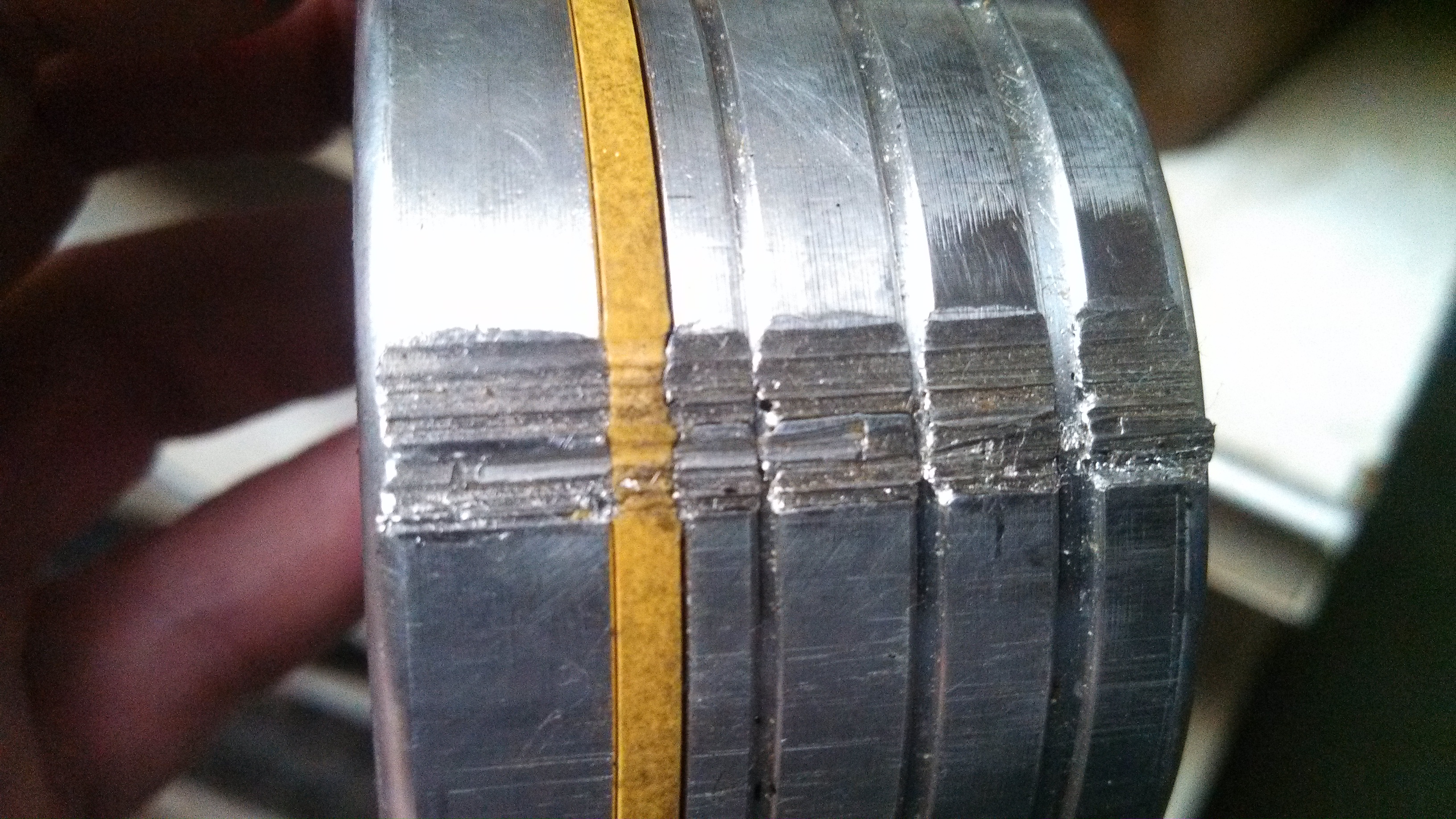

I bought a Backhoe for a older 3510 few years ago. First time I actually used it, while digging up a old rusted culvert, the boom suddenly dropped and I had to hold pressure on the lift to dump the bucket of dirt. It was very tough but I finished the project.
With the tractor running at PTO speed, the boom would just drop to the ground slow and not hold itself up.
Returned unit to dealer, after trouble shooting valves, pump, etc. the lift cylinder was removed and there was damage. Seems a stray piece of metal was in the system and damaged the seals, rod and cylinder enough to not hold pressure. It has been 4 years now with no issues.
Replaced under warranty.
