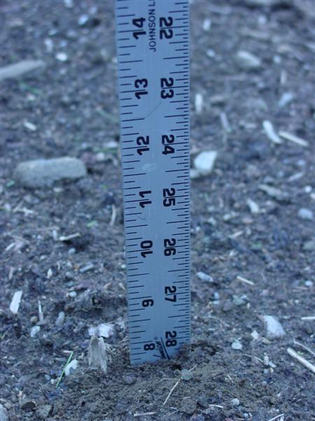

Mickey_Fx said:
Take a look over in the Yanmar forum for a thread on pto speed. Just posted a couple pics with a tiller in action and what soil looked like afterwards. A disk will not produce this kind of results.
This was an old post of mine about tilling depth with a CCM tiller. This is how my soil looked after tilling. Jay

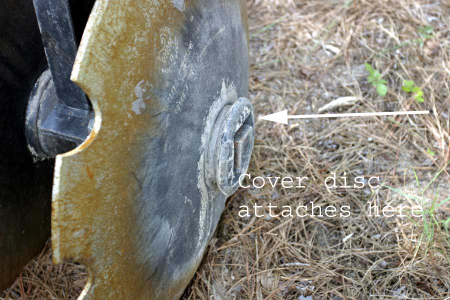

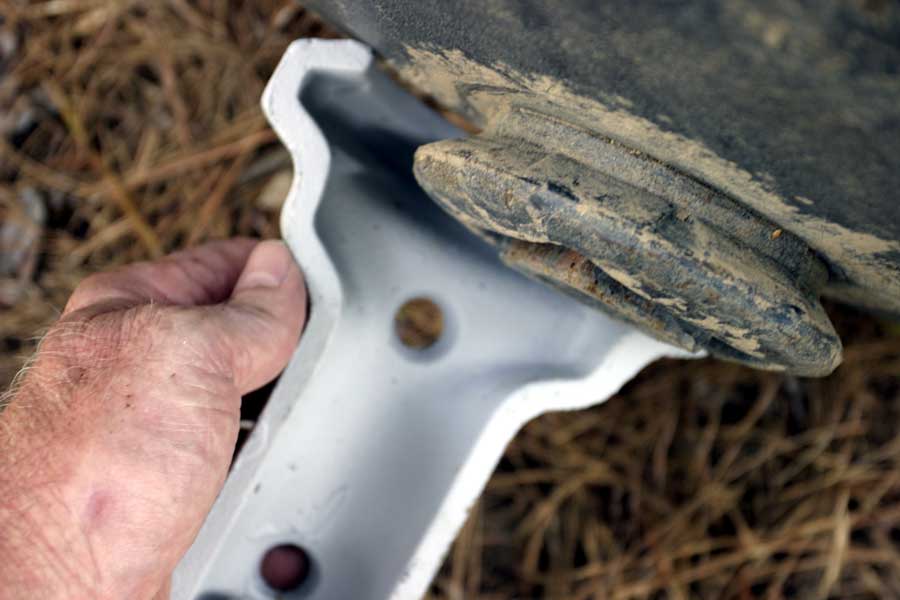

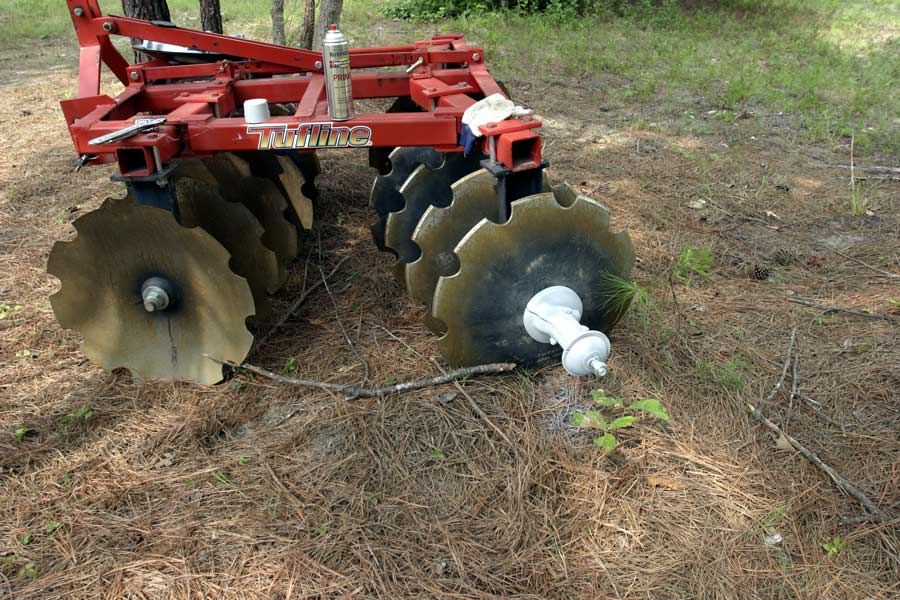

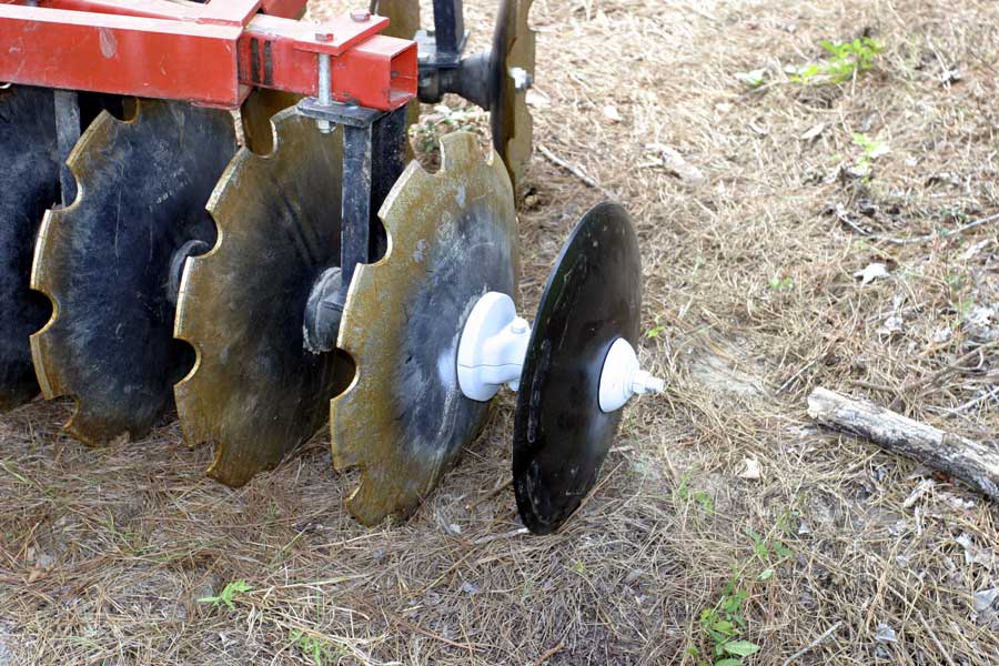

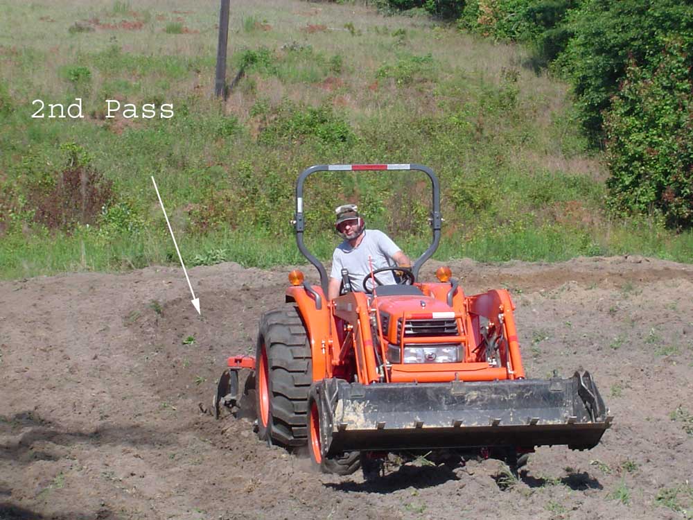

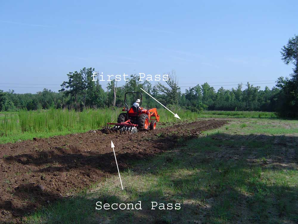

[/ATTACH]Disk picturesCoverDisc3378.jpg

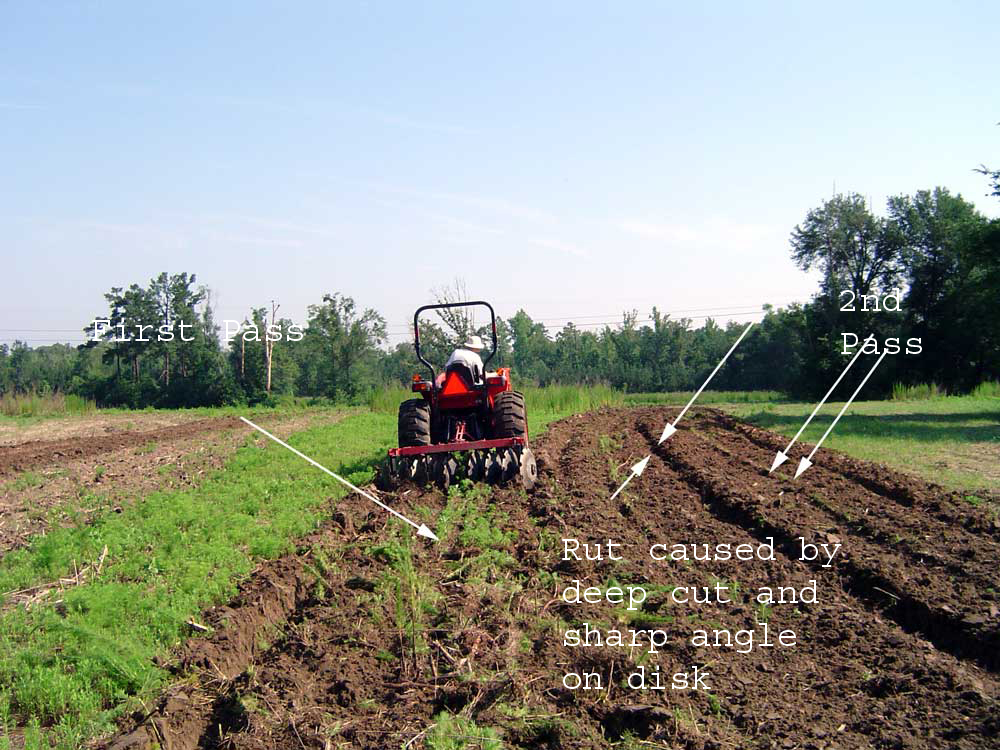

   / Disk = Harrow? What do you call a disk? #26
Nice disk Hugh. I really like those Tuf-Lines. They look to be a notch above the rest.
But, you didn't put any text in your post.....maybe you're adding a second post as I type this one. I think I get the point of the pictures though. With my new disk I could not get it set up so that the outside rear disks would not leave a deep furrow. I tried several angles and even changed the location of the disks along the rear gang.
I'm assuming the device in your pictures is a disk for covering that furrow.
So, does it work? If so, where did you get it? How does it attach? How much did it cost?
And I guess the last question is does it matter if the rear outside disk leaves a furrow. It aint pretty, but is it really a problem?
   / Disk = Harrow? What do you call a disk? #27

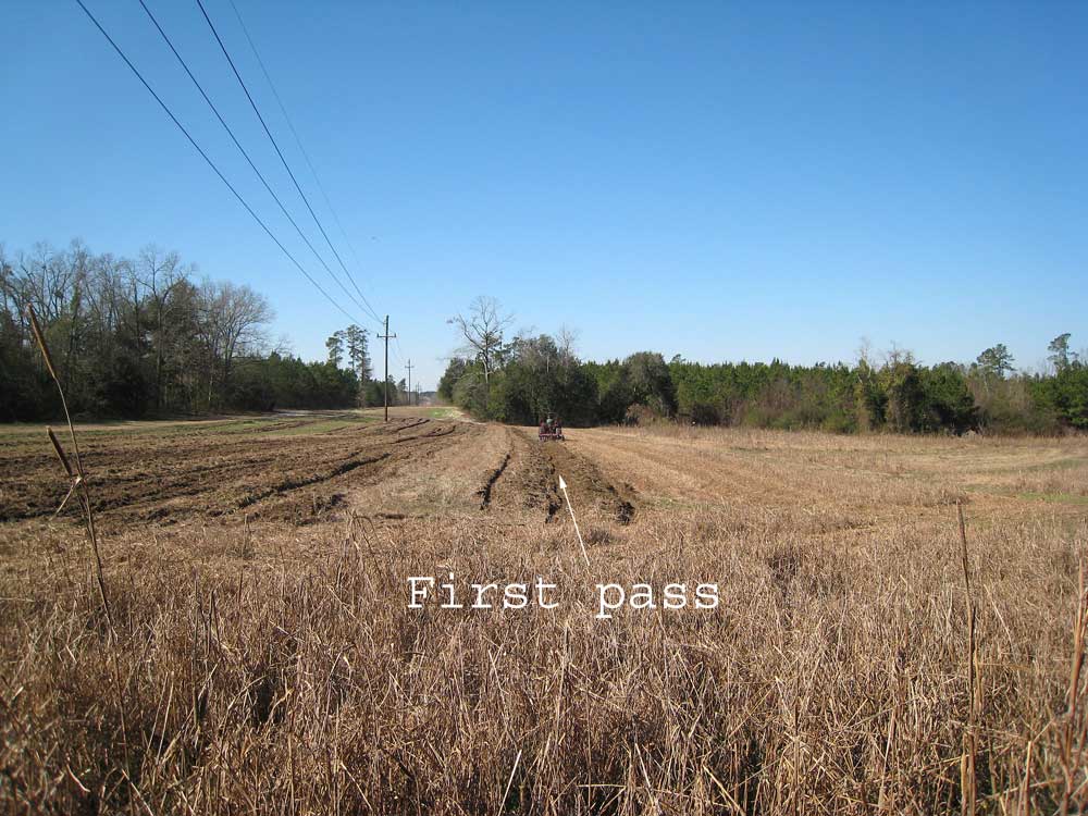

I am a rookie but my neighbor who grew up with C model Allis Chamers and now has a Ford Jubile just disc up his field nice and level. He uses a 2 disc plow. I will try to get some pictures as it is an interesting set up. It has 2 wheels that look like railroad wheels then disc with a standard looking disc pict included. He says the secret is using a mild angle make sure front and rear gangs are level and don't disc deeply. Usually I do the opposite and is why I get the deep furrows.
The picture with the deep furrows was before I had the cover disc. I will try to get some new disc pictures.

Hugh, where did you get that cover disk? Is it just for Tuf-Line disks?
   / Disk = Harrow? What do you call a disk? #29
GEORGE
The pict you posted is what my neighbor pulls witold Jubile but his set up is massive.
If the end of the rear disc has a knob, the cover disc can be attached. I ordered it from Wendall at Wilson Tractor, Newberry SC
