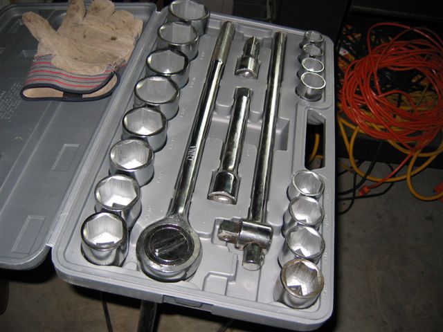

Yea, I got a breakover bar too. It was surprisingly strong getting those cutter nuts loose (I switched out my blades). I used an 8-foot 4 x 4 steel post as a cheater bar. I though for sure I was bending the breakover handle, but no, it actually turned the nut.
Attached is a picture of the set. It is some kind of "Made in China" brand but seems very well made. I needed a 1 5/16 socket for changing out my blades, and they wanted $15 for the socket and $20 for the breakover, so I bought the whole set for $80. I may find out that I coulda had it cheaper somewhere else, but I was in a squeeze, burning daylight, so I got it. Those big sockets are not available at Tractor Supply, Lowes, Home Depot, and most auto parts stores.
It has a ratchet, breakover, sockets sizes 7/8" to 2", and two extensions.
The "breakover" is not like I've seen before, maybe it has another name. Instead of the wobble joint, you turn the nut, the push the handle to the other end and turn another half turn.

Yeah, I'm not sure what they call those, but I think it'll be stronger than a breakover. Nice looking set.

I got the same socket set, same case at Menards for $39 a couple years ago. Good enough.
However, a disk needs some real power. A 3/4" air ratchet, or 2 big pipe wrenches with cheater bars.
