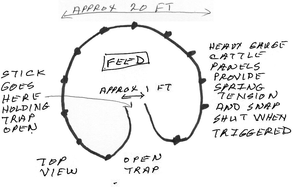

'nuther try... clearly am technically challenged... 35 years in computer business and I should know better than to use HP Scanning tools ... they locked the file and I had to fiddle with it.
   / Dispatching of Feral Hogs #64
texas john, that is way cool and cost effective, I paid $295. for my trap and I've only caught one at a time so far for the last 4 or 5 years. I'm going to have to try yours out. Do you have to reinforce the opening any way or just the two panels when they spring together are enough to keep them from crashing thru it. Our normal full grown sow will go 400lbs or so.
Steve

   / Dispatching of Feral Hogs #66
You need to cut the last VERTICAL segment out of each "square" of the panel leaving the horizontal wires sticking out as little daggers. The objective is that when the panels slam together it is seldom an exact match... and one set of wires will fit inside the other's squares. When this happens, there is a kind of latch formed. Also, the amount of overlap on the V entrance needs to be such that it cannot be pushed outward, thus allowing escaping hogs. The trigger I have seen used is simply a stick picked up from the local area which has noches/bumps on it so that it will hold the ends open until a sufficient bump happens. When the hogs slam into the closed end of the V, they are deflected toward the center of the trap.
Let me know how it works... and when you catch enough to have a big BBQ, let me know /forums/images/graemlins/smile.gif /forums/images/graemlins/grin.gif

   / Dispatching of Feral Hogs #68
I'm sure that the one way door works also... but is likely most effective for a large enclosure... and I like the large enclosure idea if you can do it. In fact, the larger the better and cover/water is a good idea too. I saw two traps of the size I indicated.. one with a swing door, the other with the V shaped cattle panels I indicated. The flat swing door presents a flat target for the hogs to hit, dig under and bend things instead of being springy like the ends of the cattle panels. The one I saw was being repaired for this reason... and the hogs had escaped.
Whatever approach you use, you gotta remember that hogs and other "domestic" animals have been tested for intelligence using a maze. Hogs are clearly the winner... the most intelligent of all critters that we commonly manage for food and pleasure. So, all you gotta do is build something that is stronger and outsmarts them. /forums/images/graemlins/grin.gif
