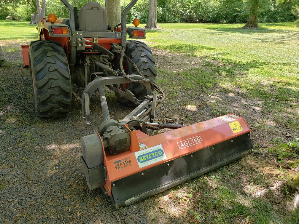

I have been reading up on ditch mowers for the past several years, and will likely end up with a Peruzzo Elk 60" flail. I am still concerned that it will be too much weight hanging off the side of my L4060, which is similar weight to the op's L5460. The Peruzzo weighs 860 lbs, compared to the 1540 lb mower the op was asking about.
You'll be fine, I have a Betstco AGL165 which is a 65" at just shy of 800lbs and my L3240 rops with loaded R4's handle it just fine.
I can even have it offset and suspended without a problem. I do have the LA724 loader on while using it, but even with the bucket off its still plenty stable.

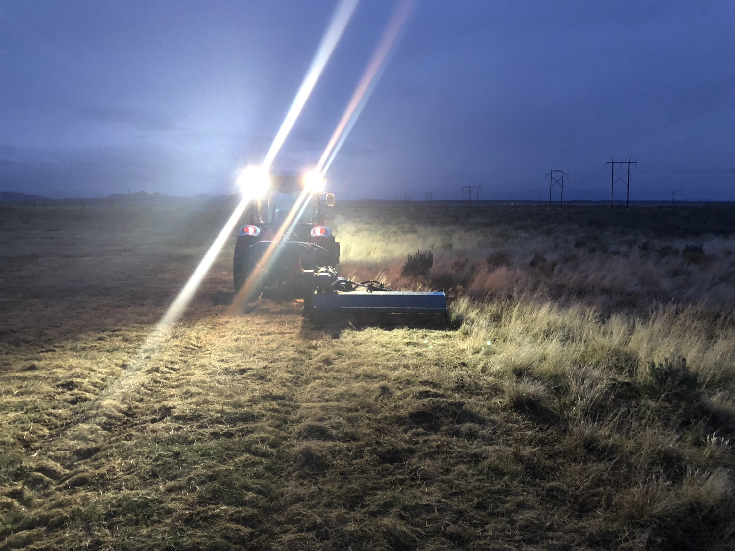

You can get away with it if you are careful. Once the roller is on the ground, the tractor doesn’t carry the weight.
I run a similar Berti 2 meter ditch bank flail on my 60 PTO hp LS. All totaled, it weighs about 1800 lbs.
You would definitely need the tires loaded and want them spaced out as far as practicable.
I mostly mow flat land, but I also mow the ditches next to the highway, but that has quite a bit more pucker factor.
