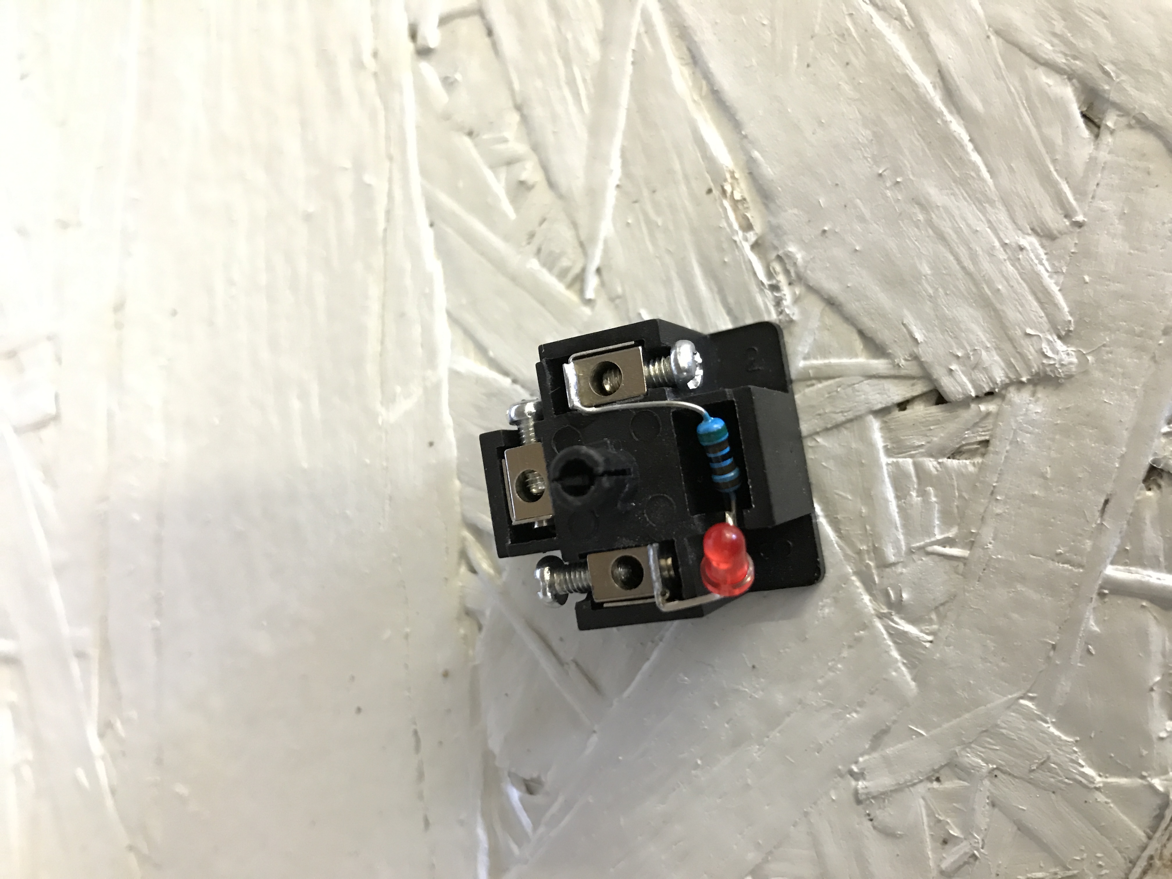

As stated above, wired in a diode and a new switch. Switch failed again in about 30 to 45 minutes of operation, maybe 25 or 30 cycles.
When I got the switch, I got an extra switch, and per the discussion above, I got a relay. My source for the diode is Radio Shack, and the switch and relay is Autozone. Diode is 50v at 6A, switch 8A. The diode is a little light for this duty. I have some 1000v/10A diodes, and a 5A switch coming from Amazon.

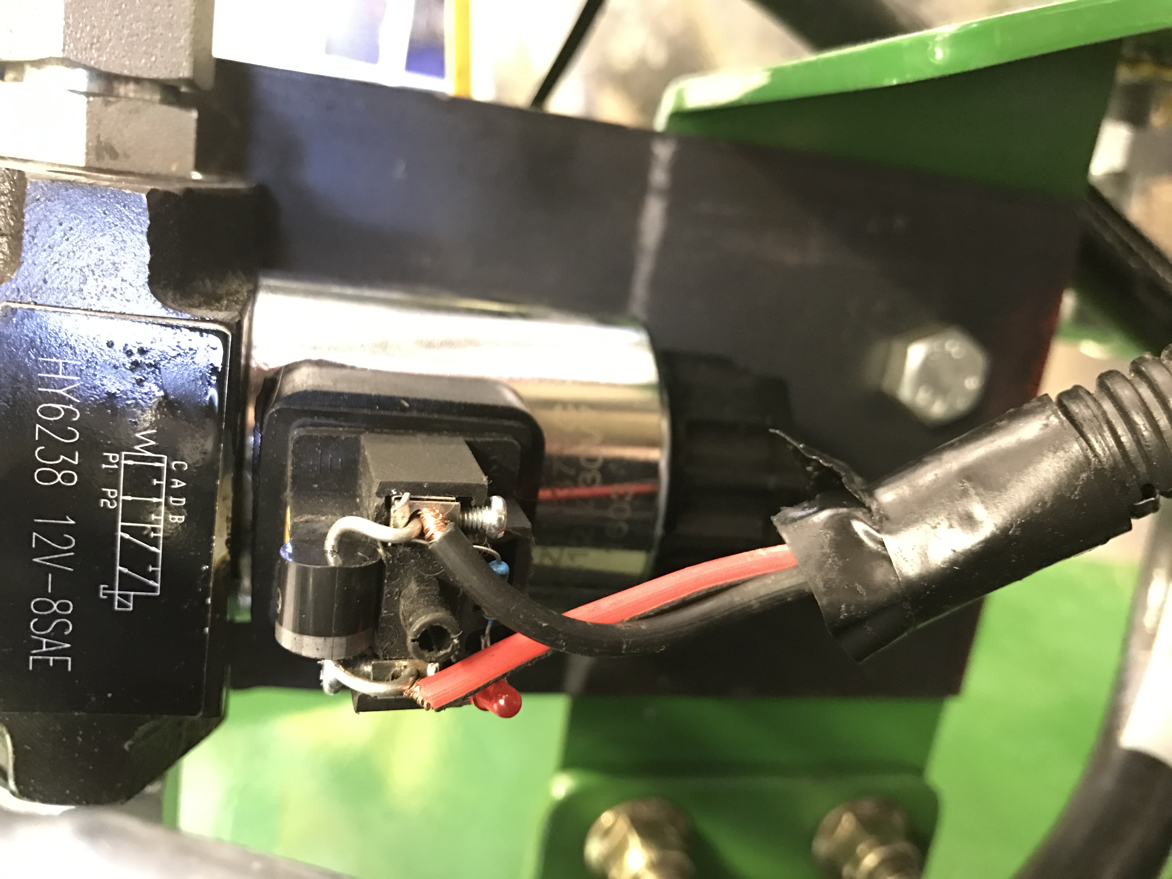

Some pics below of the diode install. Had to get after the connector with the dremmel - the diode is pretty big. The diode is installed so that it is reverse biased when battery voltage is applied to the side with the band (red wire is +12v when switch is pressed, black wire is grounded)
Given the difference seen in the arc, was really surprised when the switch failed again. I thought the diode had failed open (it is not up to the spec discussed above), and that caused the switch to fail. I tested the diode with my DMM (it has a diode test setting). Diode tested as open when reverse biased, and shows 5287 when forward biased. I'm not sure what this number actually means (diodes have a voltage drop and small forward resistance, so I'm assuming this is just how the meter reads that). Anyway, the key was that the diode I had installed and all the other diodes in the package (there were 5 total) read almost exactly the same. So they were all good (or bad) but the installed one tested the same as the unused ones. I must say I rigged up a little circuit to test the diode (diode and a resistor) and it worked as I would have expected - current flowed in forward bias, did not flow in reverse bias. I don't trust gravity right now either.
I did a test rig of the relay and it worked fine. The switch current will be 0.14A according to my meter, so let's hope it can handle it. I will leave the diode in the diverter solenoid to give the relay contacts as much help as possible. So tomorrow I'll install the relay and try to move some slash!

About 10 hours of run time and the relay seems to have solved the problem!
As many folks are talking about diverter valves, I hope this thread helps!
