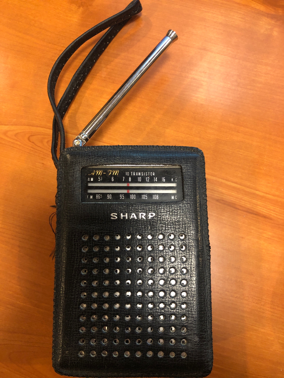

Okay went to Goodwill and bought an old handheld transistor radio for $2. Needed a little work on the battery tray and wiring but it works! First thing I found out is that my wife's food sealer is a big RF leaker!

Thats an easy one to fix, just unplug when not in use..:) The treadmill downstairs is a huge noise maker too, but fortunately the main on/off switch down near the floor takes care of that one too. One evening several years ago almost the entire band was wiped out with this whir.. whir... whir sound and it was the mother in law on the treadmill. That dynamic motor driver is a real polluter.
We used to go into clinics and hospitals to prep the area for MRI imaging machines, we called them magnets. They are very sensitive to rf and magnetic interference.
My job was to sell the service which included a site survey, simply looking for random emitters and possible problems related to magnetic and rf energy leaking into the site. All MRI sites are shielded, just depends on how much.
We also went back if there was a problem. We had jillions of dollars worth of test equipment.
A hospital in Europe was having problems so we went in. I was training so I went along, typically I wouldn't be involved in service calls etc. but good experience.
Our director of engineering and lead technical guy pulls out a $2 transistor radio and found the leak in about 30 seconds!
So much for expensive test equipment. It only worked for rf of course, not magnetic interference.

I quickly walked around the house and and found a few noisy things. This would be a good job for a blind person. :D
I confirmed all of the magnets in my TV and stereo speakers, the dimmer switches are indeed dirty, and my dryer when running is a monster. My modem and my PoE routers are messy too.
Looks like I will be investing in a bunch of ferrite toroids! :licking:
