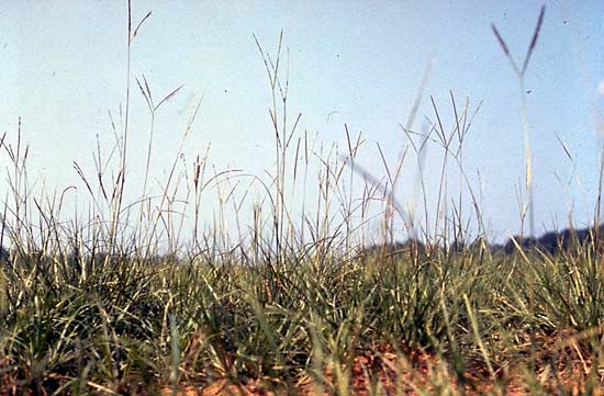

Carl - I have talked to several guys at the mower shop about cutting Bahia grass, and they've all said the same thing. Their high dollar mowers leave it standing, too. I wondered why a $6k piece of mowing equipment would miss these 'sprigs' of grass, but a cheapie push mower from the Borg cuts it fine. Now, what you say makes sense. The blades on these ZTMs are whizzing really fast and blow the sparsely distributed Bahia grass shoots over instead of cutting them (in fact, Dixie Chopper boasts the fastest blade tip speed). Next time we'll try running at lower throttle.
JJ - I wondered about the wheels mashing the grass down, but I don't think this is the issue I'm having.
For anyone who might not understand what I'm talking about, this isn't just grass that has grown high I'm trying to cut. This is otherwise normal grass but with shoots of [what I now know is] Bahia grass growing in it. After running the mower, these sprigs are still standing. The seed tops are sometimes cut off, but the shoots remain.
