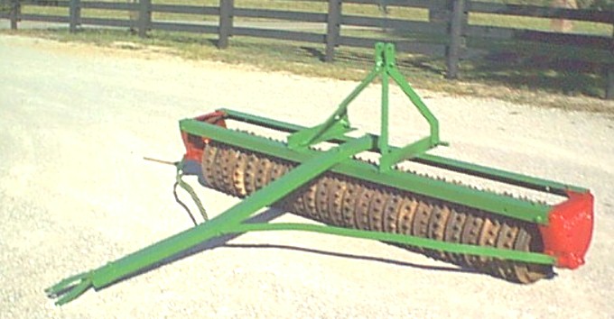

Here is a picture of a Used 8 ft Combo Hitch cultipacker that we sell. Ken Sweet

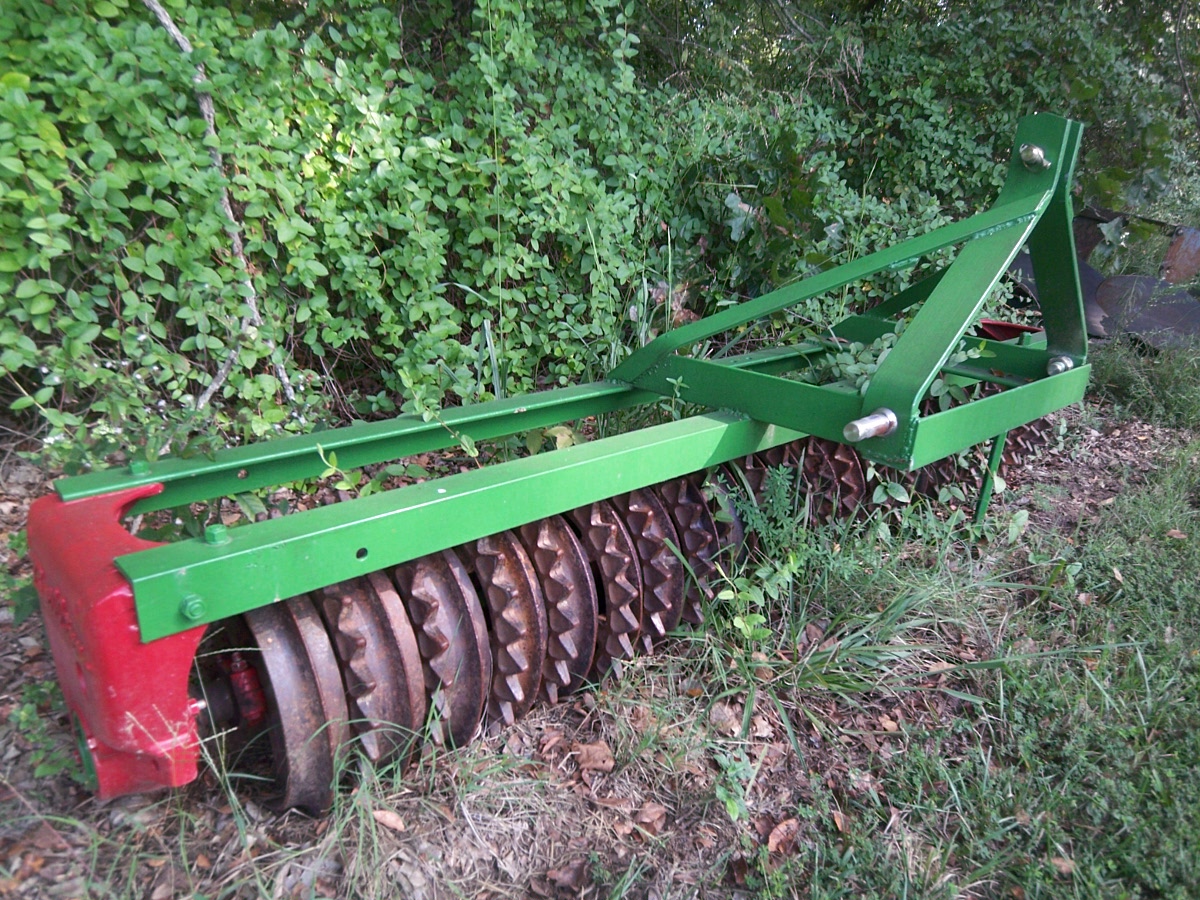

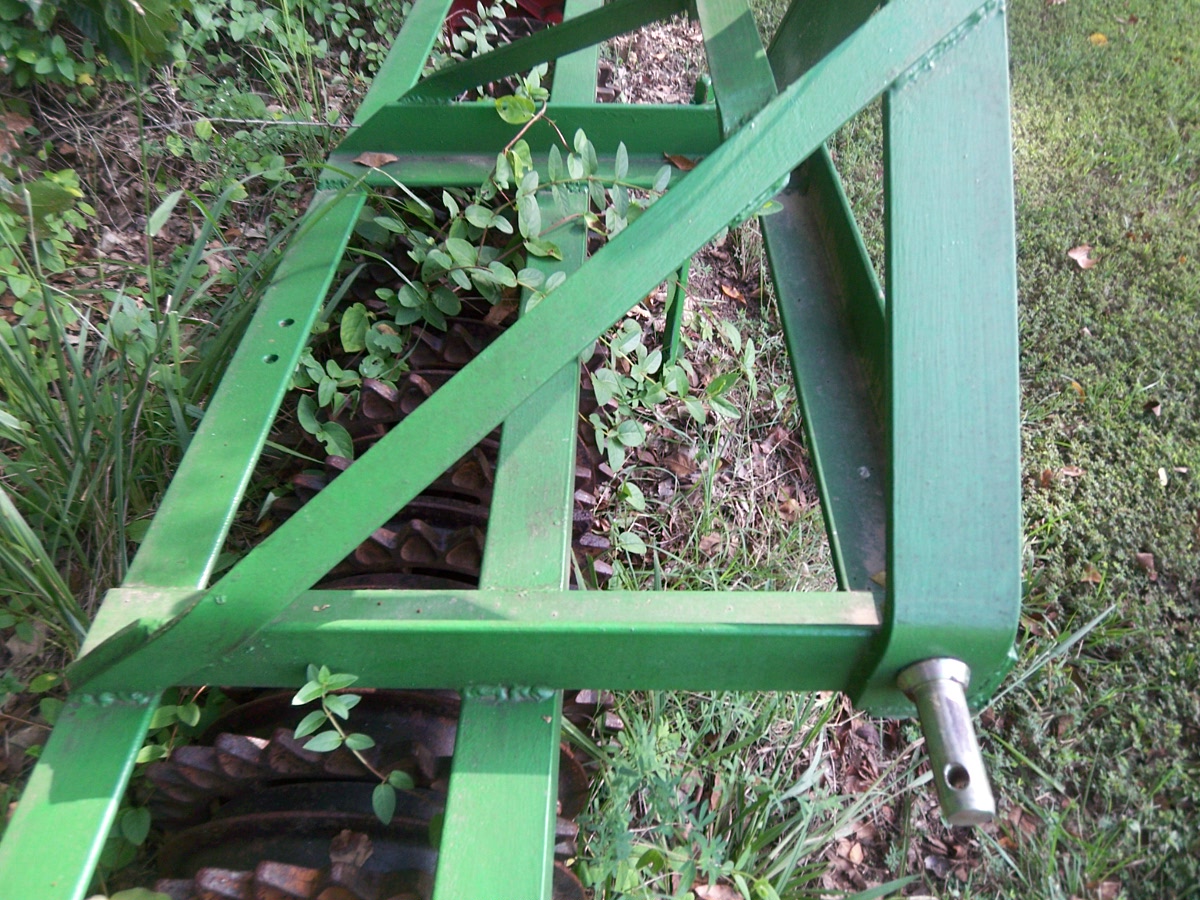

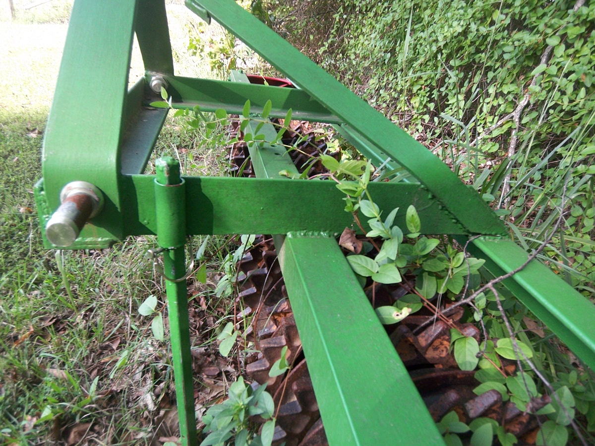

I converted an old pull-type Brillion cultipacker to 3-point last winter. Used it this past spring and it worked great.
Used an H-frame press & oxy-acetylene torch for the bent parts. Hand held drill & hole saw bits for the big holes (don't have a drill press). And a Lincoln Tombstone stick welder.

Man, that is a real nice modification. I would suggest to put a cross brace right under the toplink holes, to keep it from springing apart. Ken Sweet
   / DIY 3pt Frame for old Pull Type Cultipacker #28
That would not work with my quick hitch. There is a brace across the side angled braces that is tough to see in the pics. It is just below and behind the toplink holes. I've used it on five acres so far & it doesn't seem to be moving, so I think that all is well.
BTW, it looked just like the packer in your avatar when I bought it except it was completely rusted. Came with two three-foot packer pups. Bought it at a farm auction for fifty bucks.
   / DIY 3pt Frame for old Pull Type Cultipacker #29
Hey, I see the brace now. Cool :thumbsup: You bought the whole deal for about what 2 used Brillion wheels are worth. Ken Sweet
