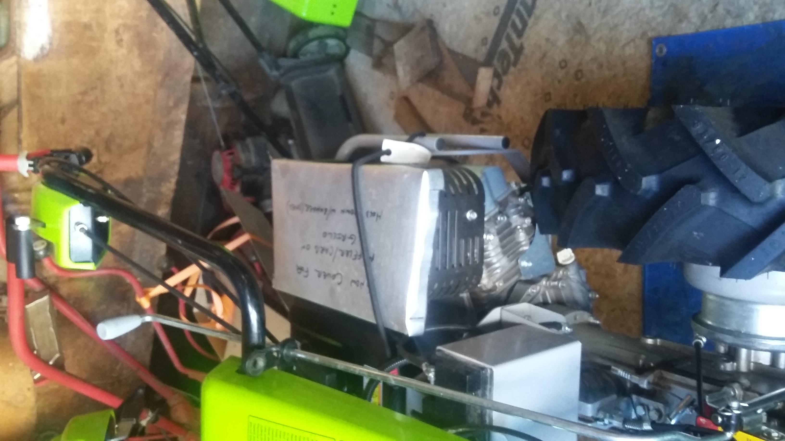

Overall if I had to do it again... I don't know, I might buy a dedicated snow blower instead of using the BCS, or save my pennies for a tractor with a blower. The air filter clogs up with ice, carb freezes up, weight distribution is funny, the whole unit is long. It sure hacks through snow when conditions are right, but a winter specific unit sure would be less grief.
While I won't likely do it, I'd love to try running my BCS with the air filter off for snow blowing. There's always some point where the motor gets stuck in the snow, and then I start losing power shortly thereafter, I'm guessing because the filter has frozen up.
I have a Grillo G110 and had the same/similar problem with light powder. It took a while to figure out what was happening, but I finally decided that the snow was blowing back on the muffler and carb along with the carb linkages. After blowing for a bit, I was unable to get the engine to run above idle because the linkages iced up. I guess the warmth from the muffler was melting the snow on linkages and then it was refreezing so that the governor was not working. I don't believe I had any problem with the air filter.
I came up with an inexpensive and easy fix using flashing I had laying around and used a small bungie to hold it in place. Since then, I have never experienced the problem.
Interesting! So you put flashing over the muffler that extends over the linkages? Makes sense. I've seen similar things. I can never pin point when it happens with mine, but with the last session, I had to do a tight turn through deep snow, dragging the motor through powder. Of course I was way out at the end of a path I was blowing, really happy I could make it back to home base without it dying on me.
   / DIY BCS snow blower weights #18
Yes, that is exactly what I did. I also think the flashing holds some heat in the area and melts anything that happens to get past the flashing. It does not take much to stop the governor linkage from performing its job. Once that freezes up, the engine can no longer request more gas from the carb so it can't run faster than idle and it takes a lot more power than idle to turn the snow blower.
I was totally convinced that my problem was with the air filter, but this sounds super plausible! I'll be keeping an eye on the governor the next time this happens to me.
   / DIY BCS snow blower weights #20
Be sure to let us know what you find. I imagine other folks may have similar issues and may be stymied.
