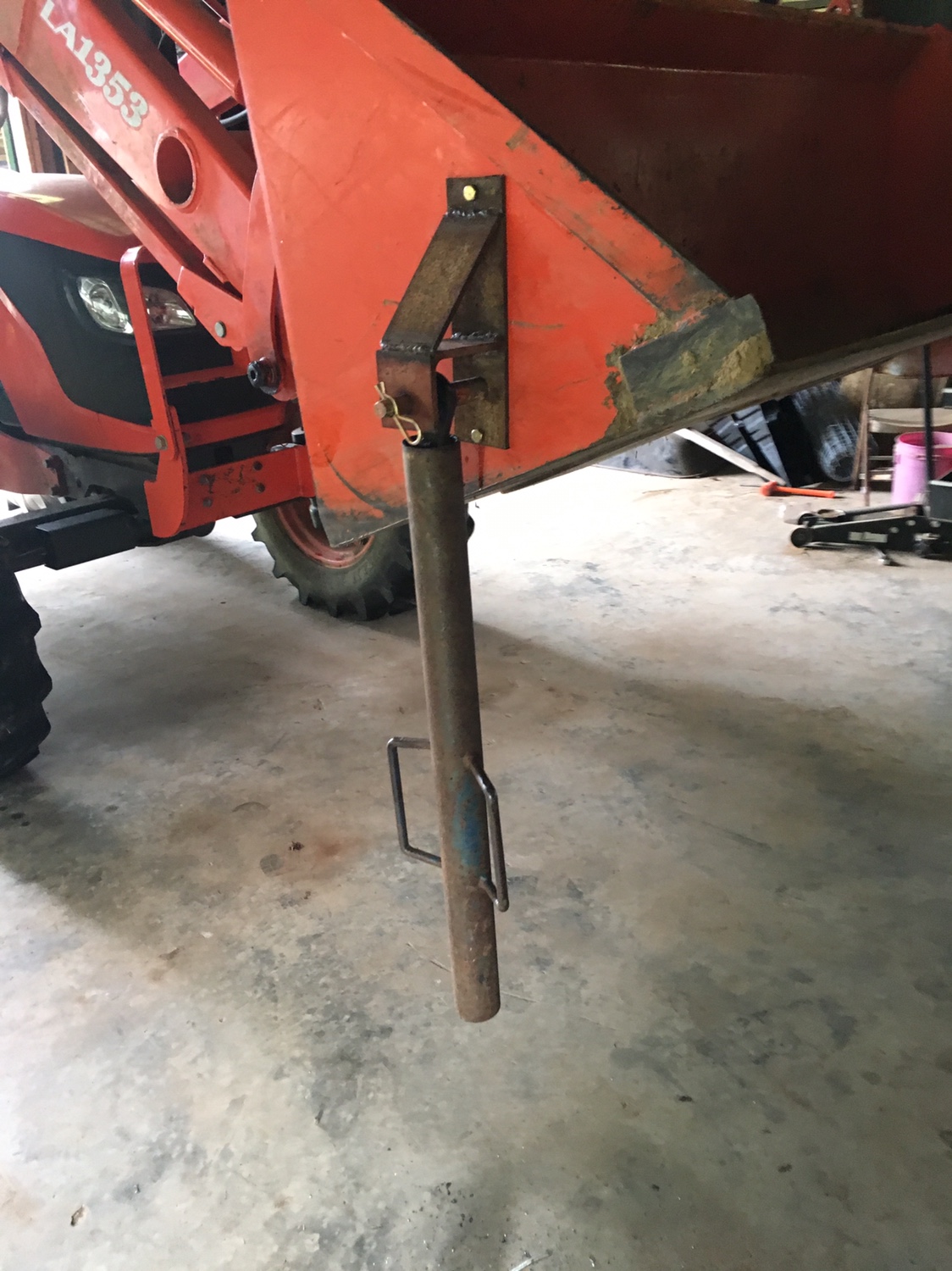

I saw the youtube video of the guy in Oklahoma.
Tee post Driver System - YouTube
Any concern in driving the t post in at the side of the bucket - unbalanced force on the front end loader. I would take a blank quick attach plate and rig it up in the middle so you get even load on the loader arms.
"or bend it". My soils are too hard except maybe in spring in some areas.
When you're driving it into soft soil its not a problem. Try some rocky soil and then you have a problem.
Yep that won't work around here regardless if you are on or off center with you FEL force. Glacial till is tough to dig or pierce.

After digging out there, i'm finding almost all soil. I had to dig over 3' into the ground to find rocks. I'm hiring out for the H bracing and corner posts (welded steel pipes) and line posts. We're going to fill in the lines with T-posts then stretch 5 barbed wires. I'm sure we'll find a few rocks and bend a few posts but I have over 300 of these to drive in... not interested in pounding them by hand. Looks like the fence project will commence later in Sept. We're quite busy for a spell then need to first focus on the driveway before the permit expires.

I don't need to "make something" to put in T post...
I load my loader bucket with everything I need, then I can get off the tractor and start a T post with a sledge, get back on the tractor and push it in with the bucket. Having a "helper" in a HUGE time saver...
Hard ground? For those, I use a bucket full of dirt to push them in, if that doesn't do it, then a post pounder won't do it either!
