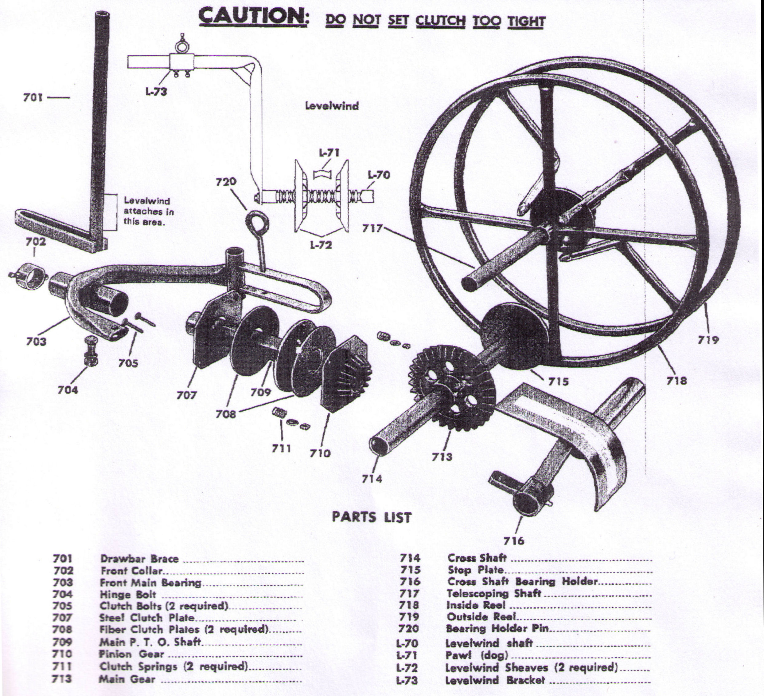

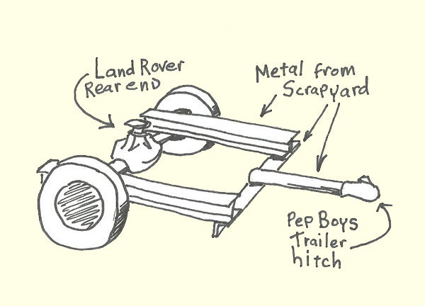

Since I have a few weeks before the grass even starts to grow, I have some time to design plans in the CAD software and then evaluate the framing and mechanics.
Looking at rotary equipment driven by a PTO helps to get the innovation rolling. There are some things in this Wilco diagram that has my mind thinking of either a tedder or the rotary rake. The other thing is to find parts easily at any TSC, Rual-King and the local hardware store that anyone can assemble.
