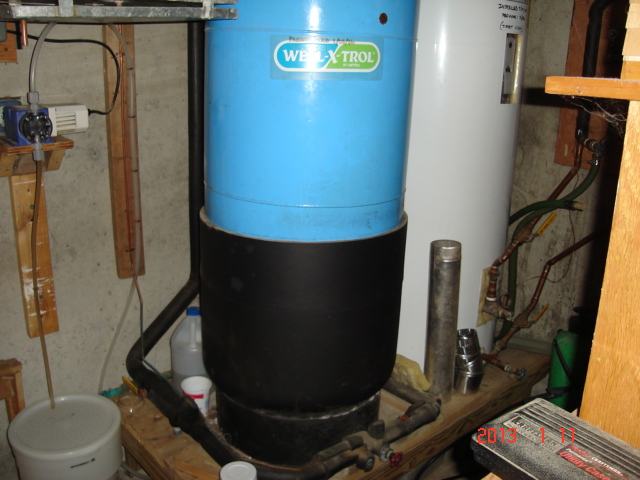

Both the stripping and the Armaflex should be available through a refrigeration (or perhaps restaurant) supply house; I used to work with the stuff all the time (previous lifetime).
Armaflex insulation is very good stuff, available in both tubes --for piping-- and sheets. Here's what I did to my extra-large domestic water pressure tank, to keep it from sweating in the summer; worked very well:

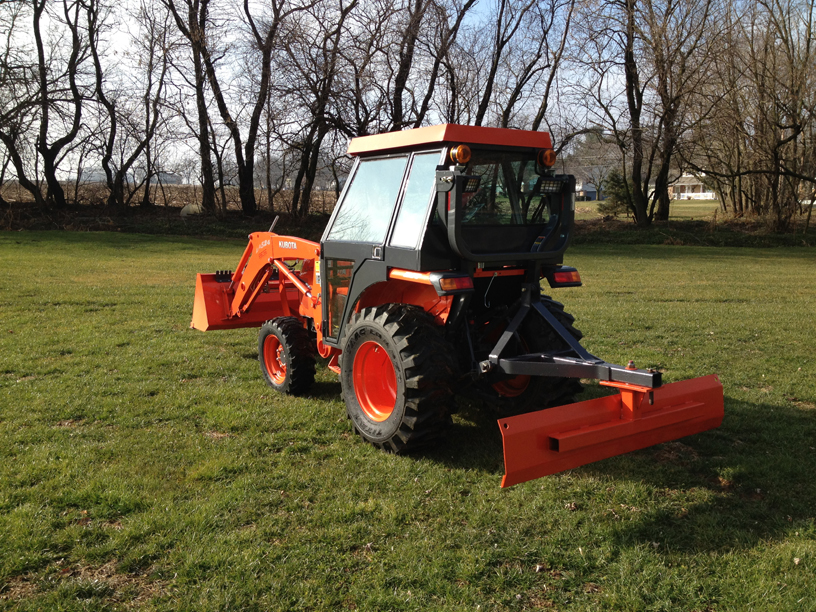

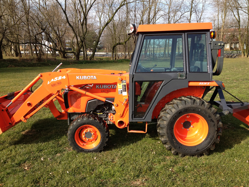

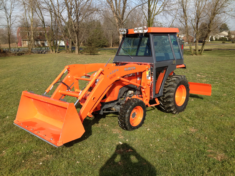

Finally got her home and put in some seat time today. We had a project at the church that involved taking wheelbarrows of clean stone and dumping them into an areaway. There was no machine access, but the guys welcomed the big orange shovel to load the 14 tons of stone so all they had to do was drive the wheelbarrows and not shovel the stone into them. It only took about 1-1/2 hours start to finish and about 10 minutes drive time each way.
Whe I got back home I washed her and took a few shots. One problem I discovered is that the trunk paint I was so happy with is WATER SOLUBLE! Splashed some water around the inside of the doors and it loosened the speckled paint. Looks like a little scrub-off and touch-up work will be done in the spring.
Anyway, here is the finished product:
