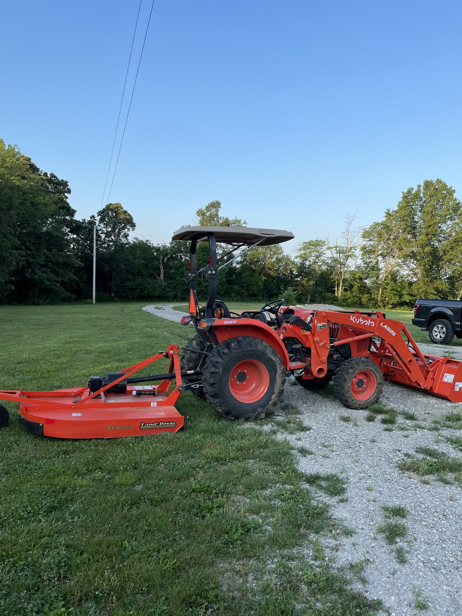

mine... find a golf cart top that will fit and build it under your ROPs

/ DIY Canopy. #11
Nice, rounded edges and looks like you can still fold your ROPS.

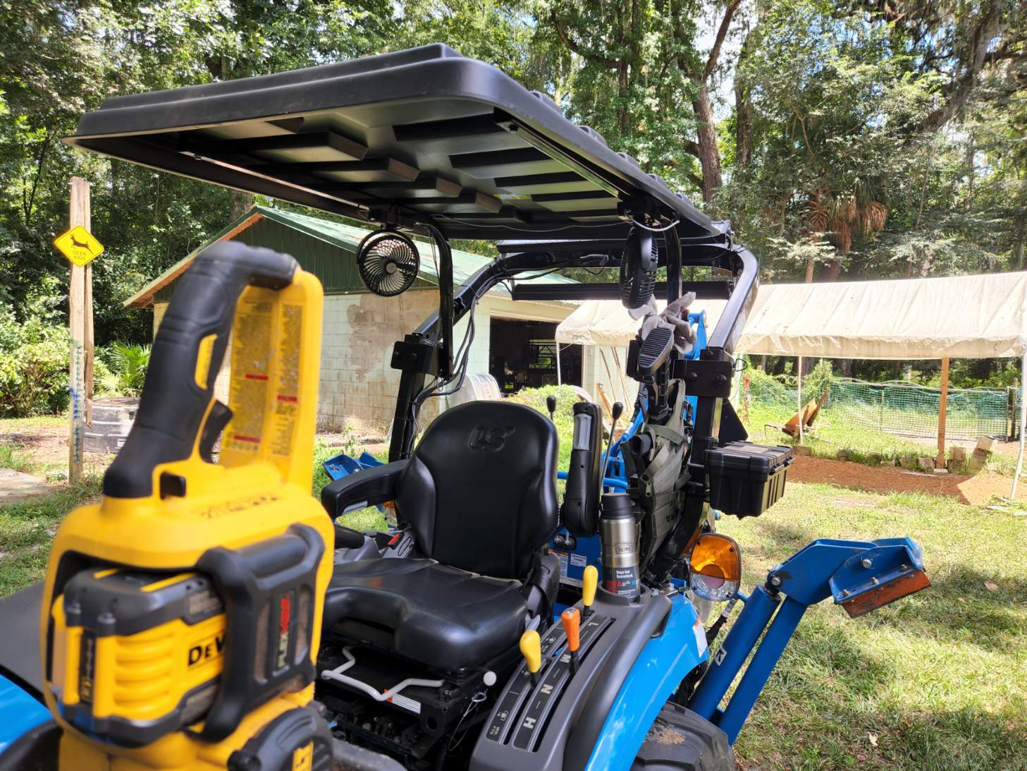

50.00 Golf cart top.Scrap steel brackets I welded myself and painted.
SO MUCH cooler in the Florida sun-wouldn't be without it.

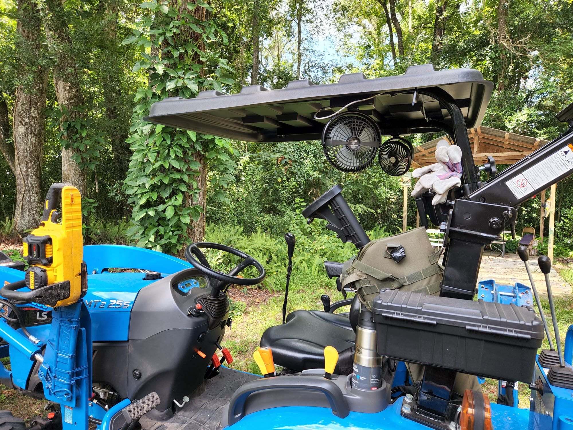

/ DIY Canopy. #15
Golf Cart canopy-50 bucks. Hardware / scrap metal for the mounting braces I had laying around was free. A little welding up the braces and bolted right on. Just bought the tractor new a few weeks ago (TYM 394) and did the canopy project within hours of owning the machine and would NOT be without one here in the Florida sun!!
