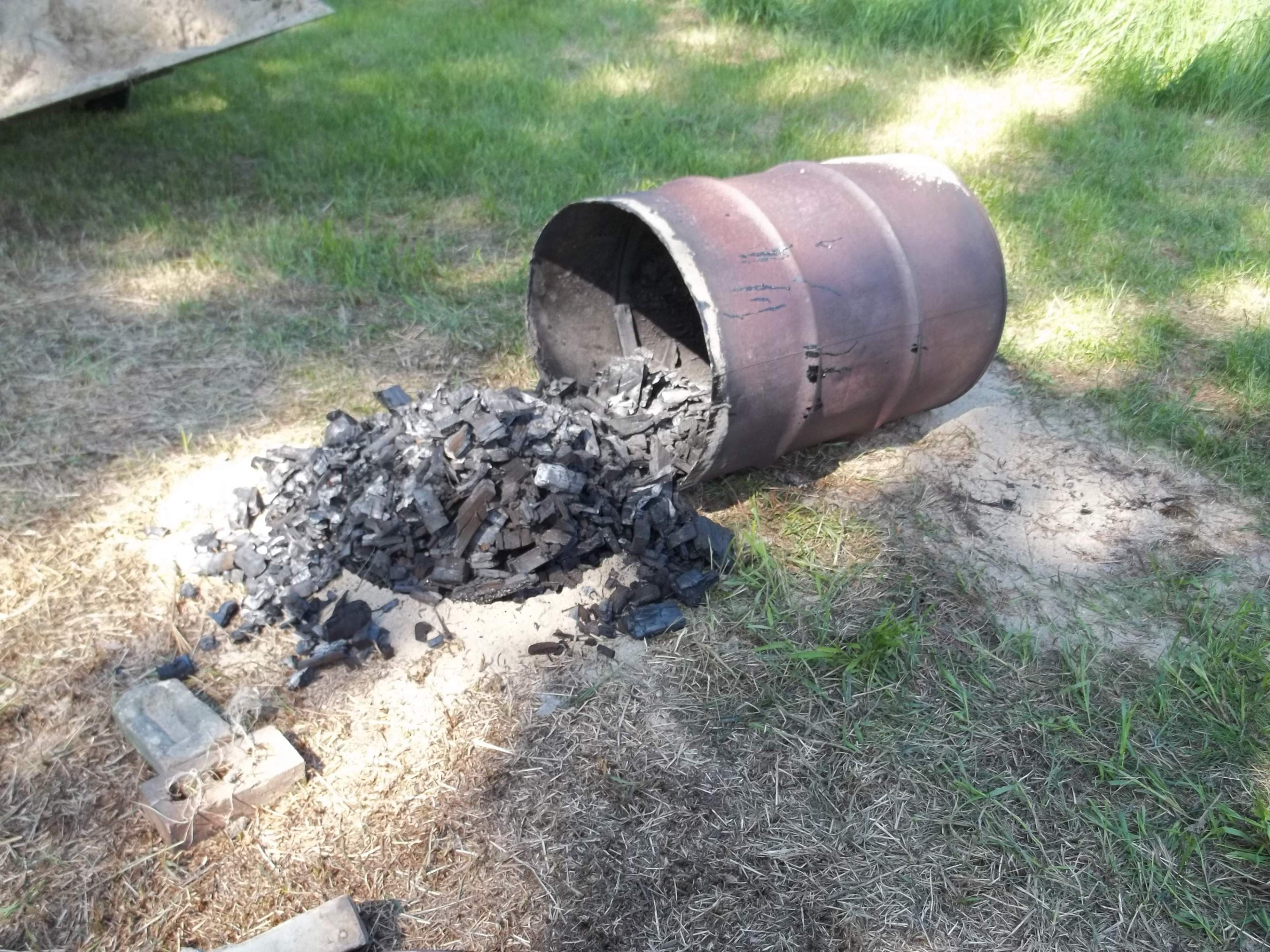

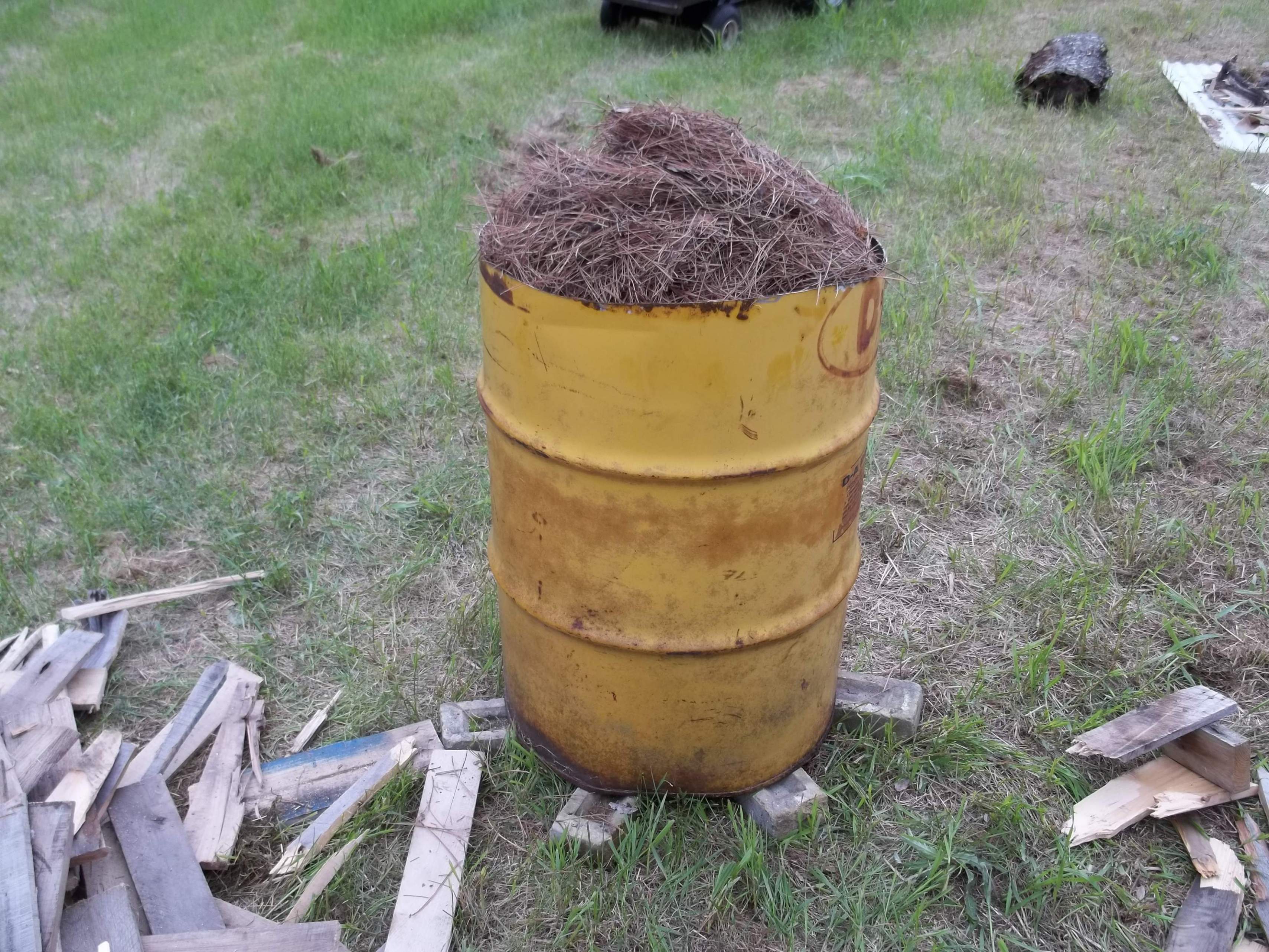

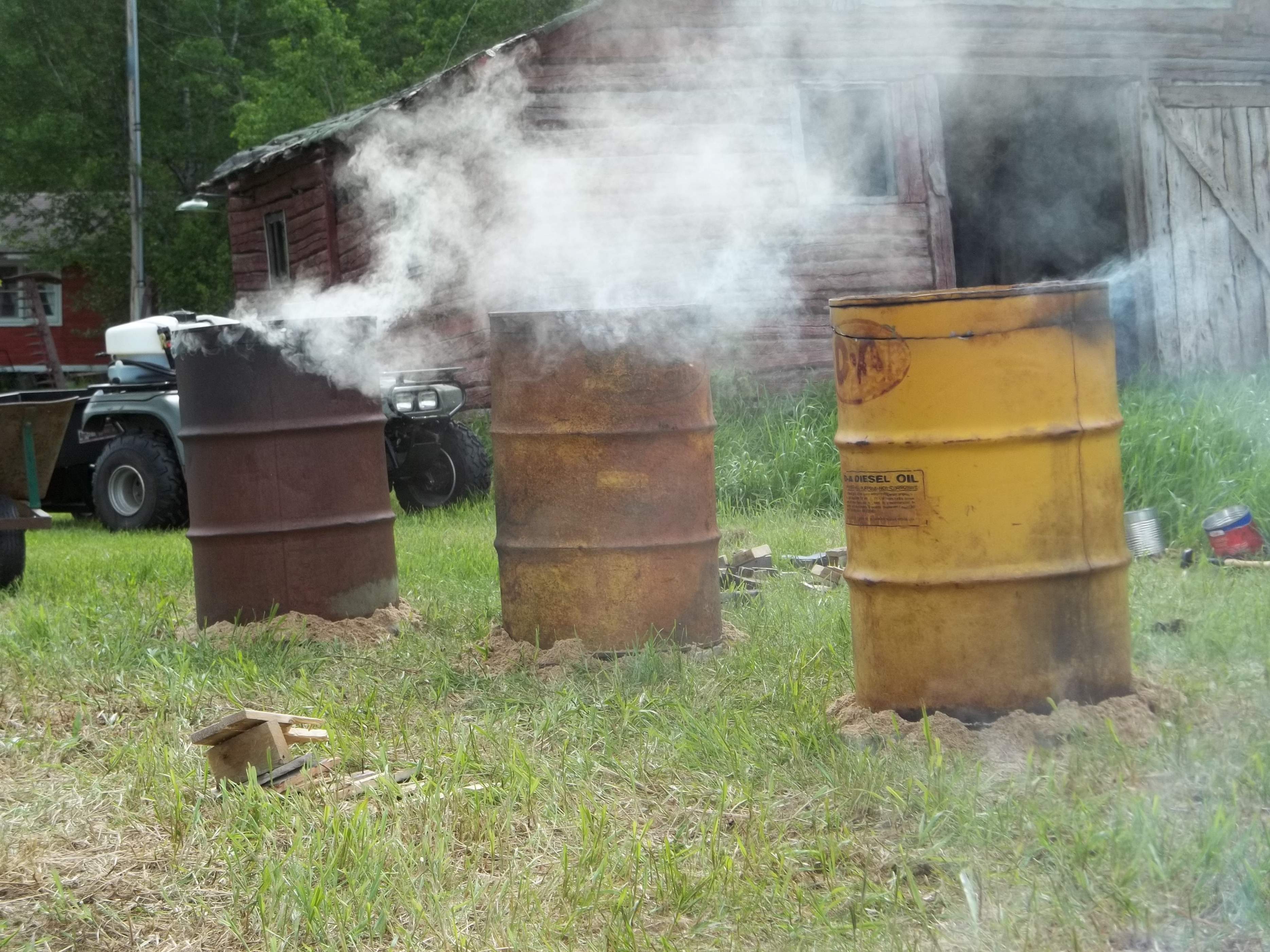

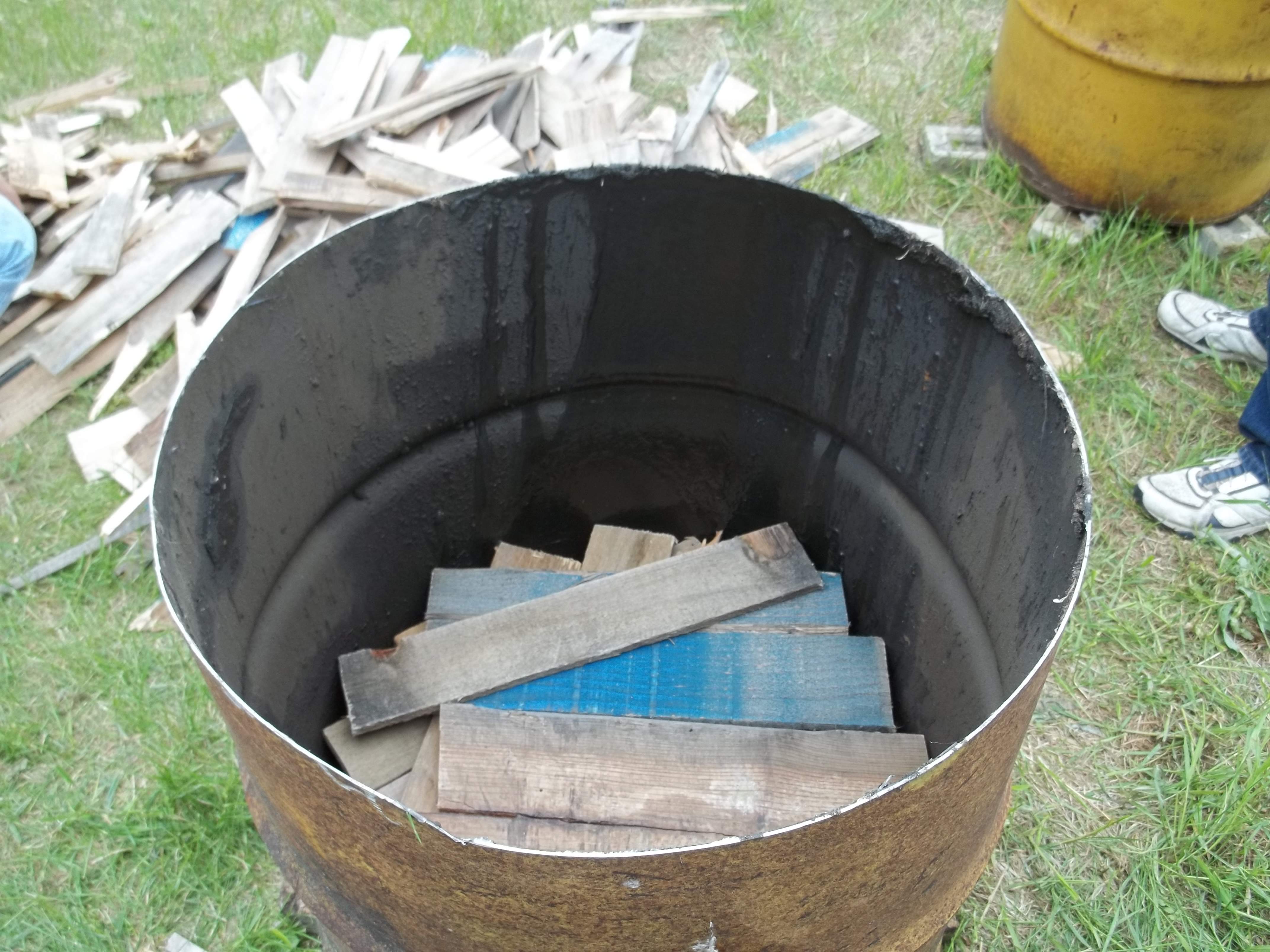

No marketing for me either, but I did make my own charcoal for another project. Old hardwood pallets, 55 gallon steel drums and pine needles were all I needed for materials. We packed the drums with the wood, heaped the dried pine straw on top and lit the needles. The fire slowly burned from the top on down. Once the wood was burning, the tops were put on the barrels until the smoke was the right color and consistency, then the barrels were turned upside down and the holes were plugged. We let them smolder overnight and emptied them in the morning. Worked surprisingly well for a first time attempt. Got lots of good charcoal, but I don't think I could make enough money by selling it to pay for the labor. Just a fun learning experience.
