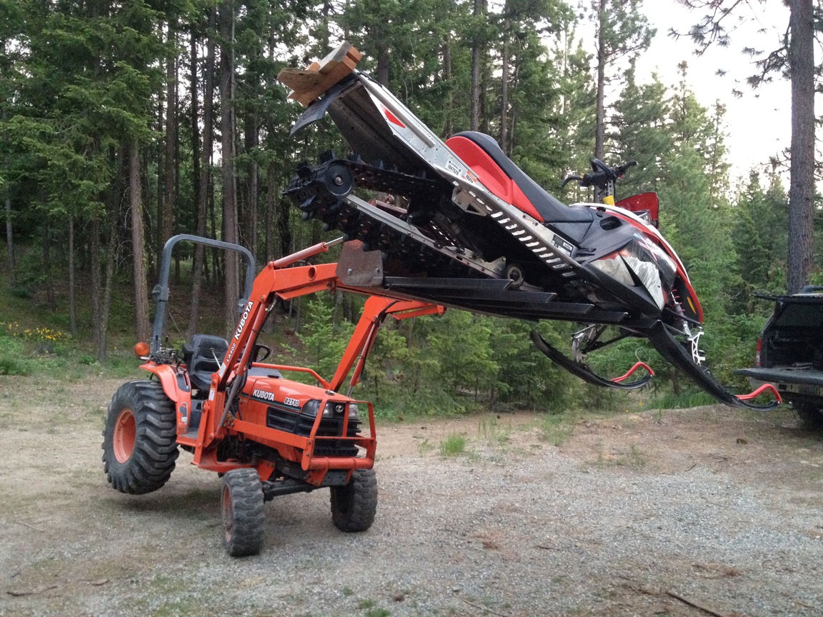

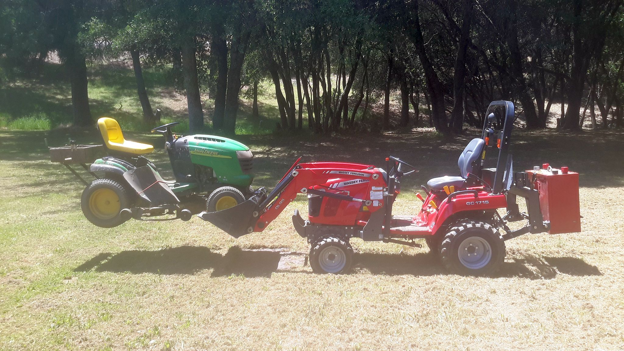

Including the weight of the operator, you're golden. Not too long ago a pic was posted of a skidoo being moved by an FEL with fork extensions, no ballast. When the operator dismounted the tractor, one rear wheel rose up off the ground.View attachment 636331
https://www.tractorbynet.com/forums/owning-operating/314547-stepped-off-almost-tipped-over.html
Yeah.....

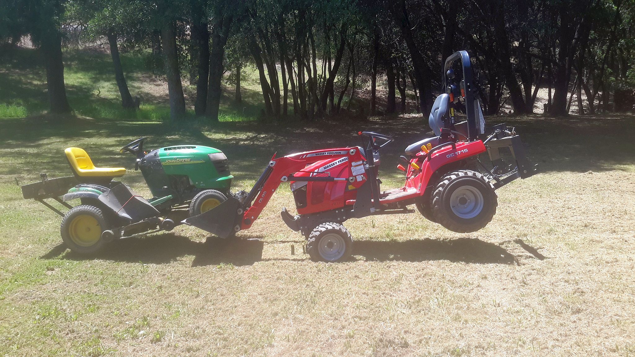

Guess what happened when I took my 220 pounds off operators position....

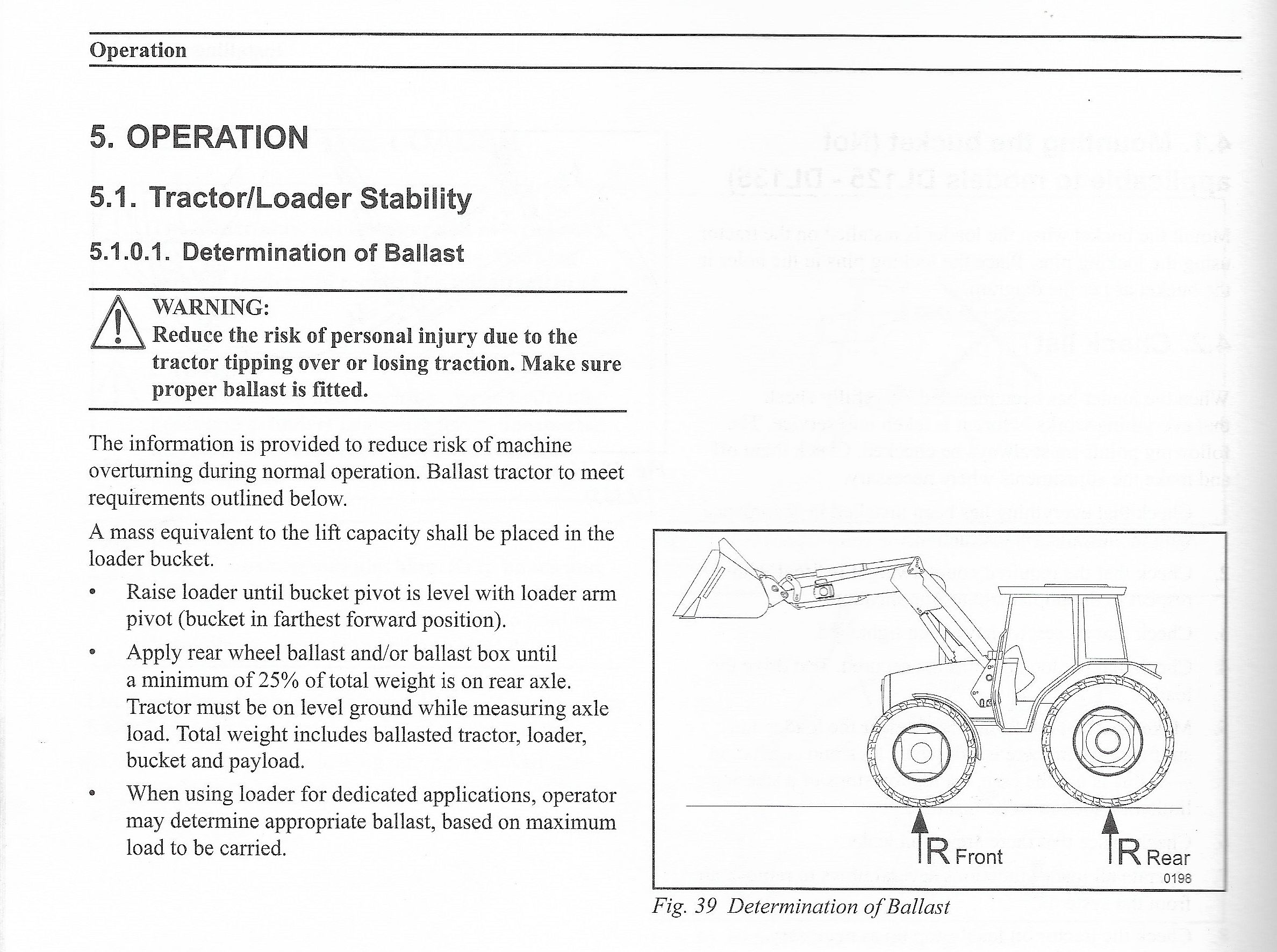

This started my adventure into ballast.... According to spec sheet the JD L120 weighs 520 pounds. A bit less than the FEL lift capacity- think about it... ...
Dale
/ DIY counter weight #42
Yeah.....
Dale
With that tractor hanging 4-5 feet off your bucket like that the effective force is far more than 530 pounds, probably more like 750 or more. 500 or 600 pounds in the bucket won't do that.
