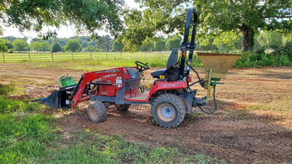

The other day I got out my tractor and planted some grass seed.
We finally got some rain and the grass seed has started growing.

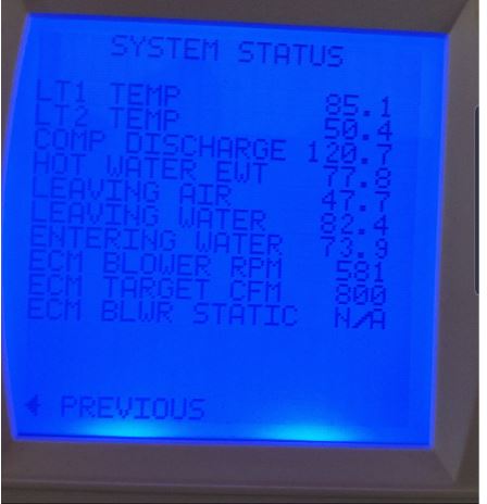

If you have section on copper on the in and out you can put thermometer each then insulate and you should see about 10' difference.
   / DIY Digging trenches for Geothermal
#135
I have a two-way communicating thermostat that gives me all the system info.
No need to connect up anything else.
   / DIY Digging trenches for Geothermal #136
I am no expert, but everything I have read, and everyone in the HVAC business I have talked to, said 2-4 degrees is about the norm.
You won't see a huge difference in supply and return loop temps, because of the shear volume of water flow. If the flow is slowed waaayyy down, then maybe you would get a 10 degree Delta.
   / DIY Digging trenches for Geothermal #138
My loops are currently 5, 8, 7, 7, 7 degree different.
   / DIY Digging trenches for Geothermal #139
Early into either season the larger differences is understandable. Early into winter the ground hasn't cooled as much and more heat to be had. Same in the summer. Later into a season the differences diminish.
Are you guys running one pump or two? Pressurized or non?
#140
I have one three speed Grundfos UP2699FC pump. My system is pressurized. 4 loops one pump.
I dropped the pump down to medium speed for the summer. The winter it needs to be on high.
We just went through a couple week heat wave much higher than normal (for this time of the year). 97-89 degrees.
That raised my loop temp some but this is my first summer so I really don’t know what loop temps I will see.
