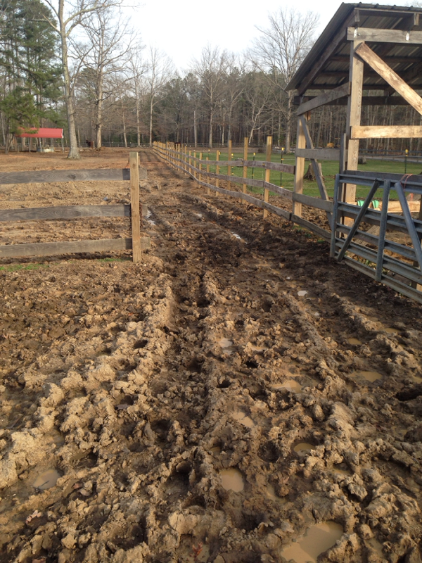

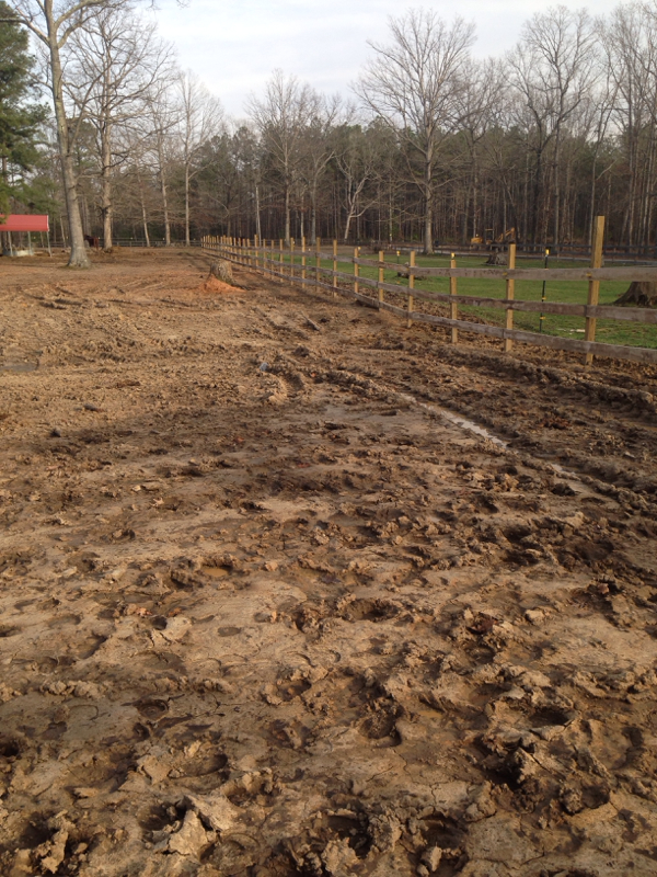

Here are some pics I took tonite. 3 days of sun and it's drying up good.
I was just making humor when I said leave the degree at work. I recently took a load of firewood to a woman who's husband is a civil. Selling firewood is not something I normally do. But their furnace had broke and he couldn't afford to fix it. I had it almost stacked when he came out to empty the trash. He looked at it and said that's gonna fall. So I pushed it over for him.
I have a friend whose a surveyor. He came by and took a hand level and found the high spots. Gave me a little advice and the rest had been hydro grading and watching where the water goes. But I can also understand your concern of not screwing around and watching where the water runs to.
