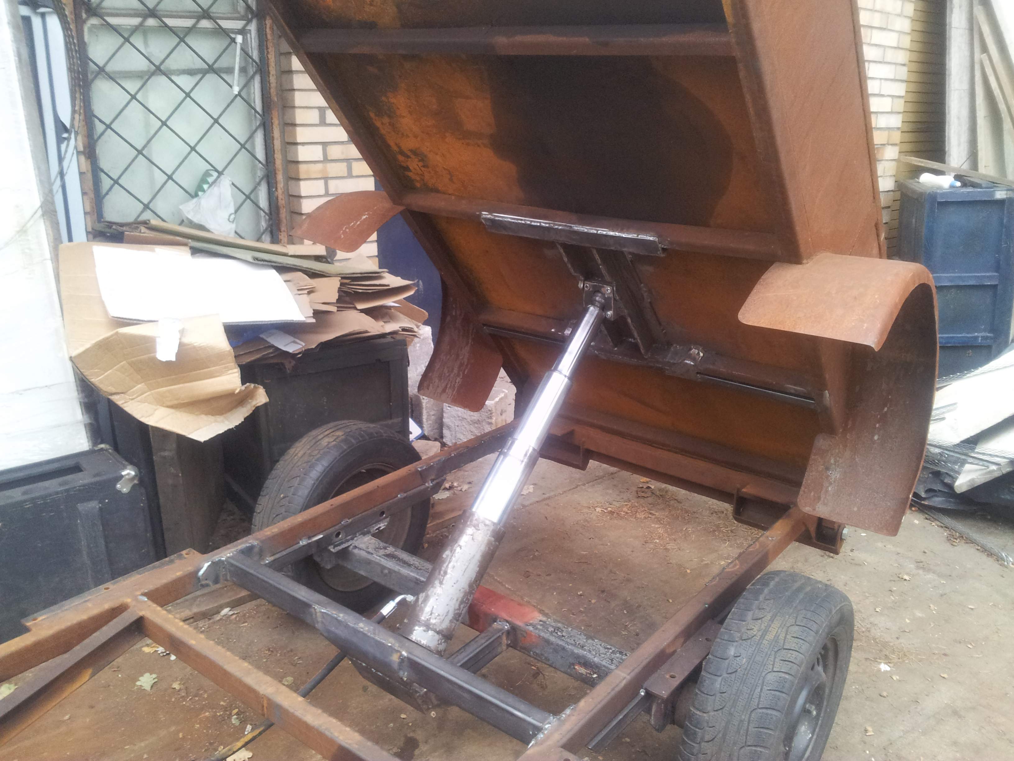

Thanks guys for the very kind words and suggestions. I have enjoyed using it already and believe that I will for a long time. It has worked as well as I could have hoped and without a sign of problems.
that frame looks way to light to handle those loads. I think a pintle hitch would also have been better
When I had a full load I raised the bed about a foot and then dropped it, then I reversed and started raising again. The test was to see if anything flexed or showed any movement. Nothing did--everything was solid. You can make it bounce on the suspension and on the tires, but the frame seems rock steady. I did box in the c channel in a couple of areas and I added an extra piece of flat stock to the insides of the frame in the rear of the trailer. The axle point is spread out through a box section. Time will tell but I think that it will hold
I would say to add a safety chain at the hitch not only to keep it behind you while towing but the weigh pulling up would ruin your day if you or someone else was standing over the unit and it came unhitched.
I would add centering guides so when the main body is all the way down it will not want to move left and right over the frame, the rear is fixed at the hinge but the front is not

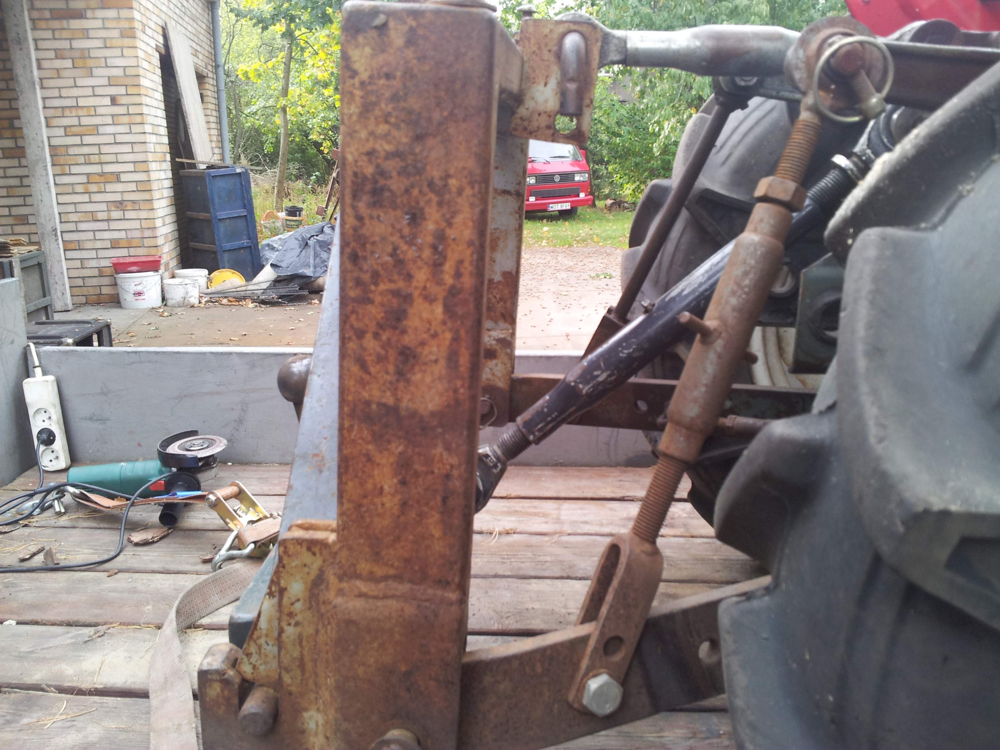

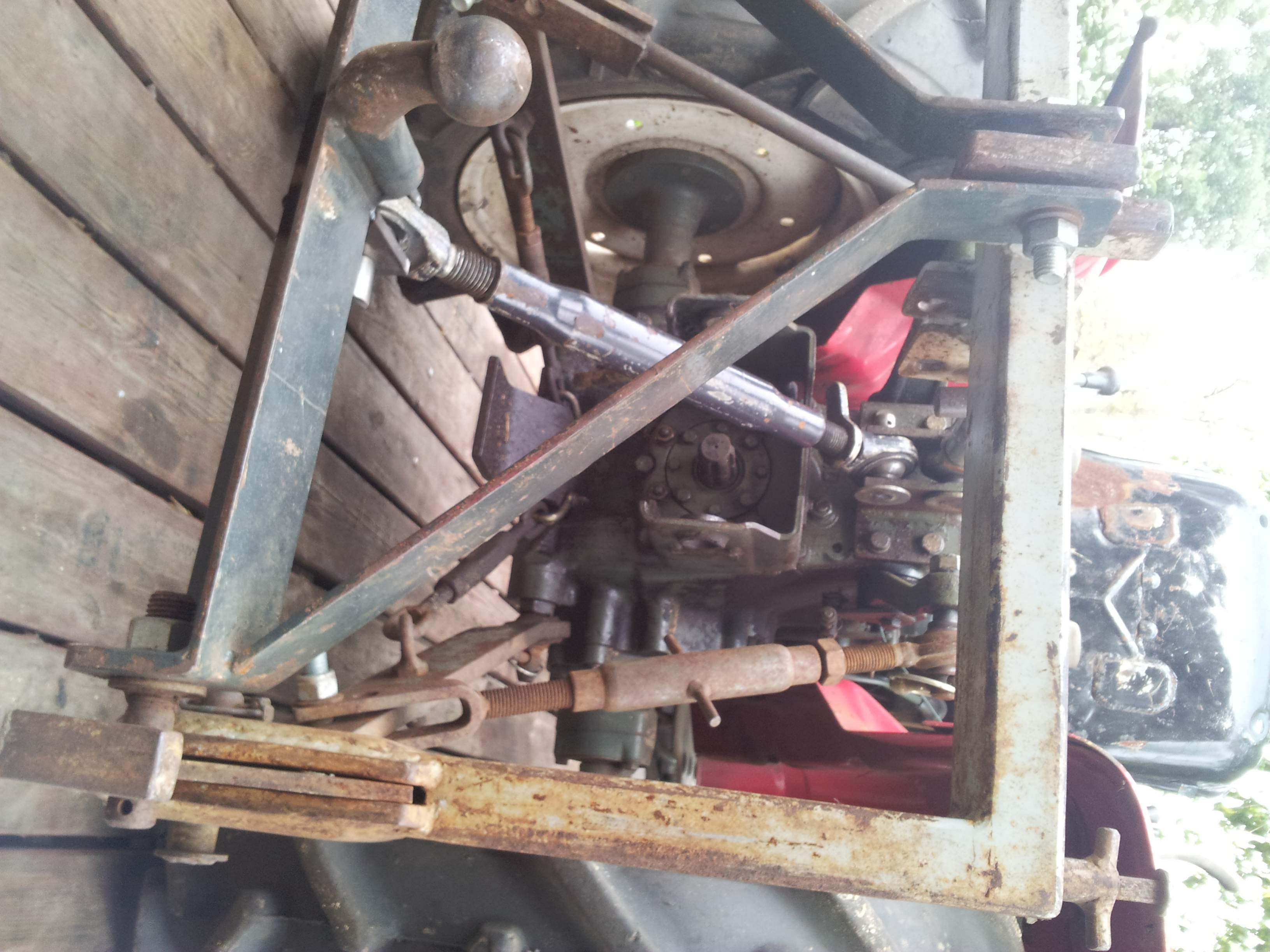

I used a standard ball hitch because I can see making this trailer street legal and pulling it with my car too. There is the chance that it could pop off, but I have not seen a hitch come off IF it was in good condition, put on properly, and properly secured. Safety chains are already in the planning as are centering guides, which will unitize the whole structure.
Only pull a dump trailer off of a fixed draw bar!!!!
I considered pulling it off the fixed draw bar, but the convenience and versatility of the 3pt won. I do want to immobilize the 3 pt when the trailer is used. This would have several advantages for me too. I could have the trailer at a set tongue height rather than as low as it goes. As the weight distribution sits right now, there is a constant down pressure on the hitch in all positions of the bed. Unless you raise the bed without first opening the tailgate. There is a balance point beyond which the hitch will jump up. But remember this is not a large tractor and the cylinder is large so nothing happens fast. :).
Thanks for looking and making suggestions.
Mike

Just be careful when going down a hill and only dump on flat ground or pointing uphill.
   / DIY dump trailer for my tractor #16
Just wanted to add that I use a small chain from the draw bar up to the 3 pth part to hold it from jumping upwards.
