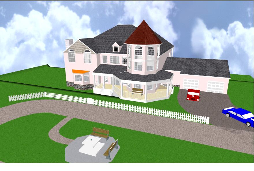

I used the Punch program. Took some time to figure it out but I was able to do some good planning with it. Going to use this to have an architect make some official working drawings. Many things don't work like I'd like but have found work a rounds. I don't like the estimator for big projects like this but for a small garage it would probably get you a pretty good idea of how much wood you need. Really wish they used engineered trusses to since they add the rafters to your estimate. It also won't figure out if your plan is even feasible, it will let you span how ever far you want without any support. Like I said its a great program to do your initial planning but you'd need to bring it to an architect to get something the city and contractors could use

I use TurboCAD v8 all the time & am designing our upcoming house with it. Got it on clearance at Office Depot for $5 :thumbsup:
It has lots of functions/ capabilities, including 3D rendering, but that's pretty complicated to me & never interested me enough to learn how to do it, so I just use it for drawing lines, curves & dimensioning.

gocards1177 - We used H&G Home Designer Suite also - very happy with it.
I'd suggest getting the latest version you can buy (usually $99 or so) as each new home owner version is more capable that the last.
I used version 7 then 9 to get features that 7 didn't have that we needed to convey our ideas to contractors for quotes.
We went with a specific modular company which also used the Chief Architect software and that allowed us to exchange files for editing and quoting purposes.
I didn't have to be "perfect" because they could easily tweak my files to adjust dimensions that were suitable for the modular construction techniques used by the factory for production software!

I'm torn between the Chief architect and Punch programs. I played with the demo of the chief architect last night and it seemed do-able. I can't find a demo of the Punch one. However, I can use the punch one on our Mac without booting it into Windows (which is more annoying than it sounds)

Beppington, Yep that's exactly what we've done for the past month (only with 1/8" scale). Now I'm at the point where I want to see what it looks like and how the roof will come out.
In 3D or just a top view? All hip, gables, or hips & gables? What roof pitch? All the same roof pitch?
Scan or make a pic & I'll draw a quickie version with TubroCAD if you want.
