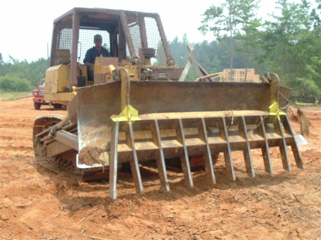

The size of the trees make a dozer a good choice because it can easiyl push them over and pile them up. The problem with a dozer is all the dirt you get mixed in with the trees while building your burn pile. Each tree will hold some amount and after a thousand or so of them, you can have several dozen yards worth of dirt in your burn pile!! Spreading it out after you burn is an option, but no burn is every 100%, so you always have a mess to deal with. I like to bury my burn pile debris after it's done, but a dozer isn't very good at this.
The excavator with a thumb is the ideal tool for taking trees out and piling them up in the burn pile. With the trees being so small, a mid size excavator should be fine. Some of them even have a dozer blade on the front of them. I don't know how well they work on that much land, but if you do a few acres at a time, it might be the right thing for you. The big drawback to an excavator is it's very slow at moving material from place to place.
Your tractor with a dedicated grapple on it would do this very nicely. I put one on my backhoe have increased the speed and quality of my land clearing by a huge margin. What I would have expected to do in a week, I'm getting done in two days with better results and less effort. While the grapply thumbs that attach to a bucket are fine for light use, they are not the same as a commercial grade grapple. Get the strongest one that you can find for your tractor!!!
It's a two part job, taking the trees out and getting them to the burn pile. In my opinion, a full sized loader backhoe with a grapple on the end is the best all around tool for this. Tires are way better then tracks for getting around, but tracks will go where tires cant. Tracks are also a nightmare to work on, while a tire goes flat on you and needs fixing all the time.
With the size of your tractor, I'd buy a mid sized excavator in the 80 hp range with a thumb. I'd put a grapple on the loader and buy a big disk to smooth out the land after it's cleared. After you disk it, you can drag it to make it good for mowing and maintaining it.
