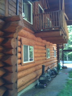

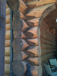

   / DIY Log Home #13
This is one side of my house. I love the way the corners were done. :)7

   / DIY Log Home #14
Log homes are beautiful, and yours is no exception. Thanks for the pix.
How do you deal with rotting and termites and the sort? I would be nervous about my house crumbling over time!
   / DIY Log Home #15
Most houses are made of wood. Wood is wood to termites as far as I'm aware. I don't think they care if you cut it into sticks and sheets or leave it whole.
You are supposed to seal the logs inside the house and out every few years to help preserve them but it's no more work than repainting a house would be. I also do a perimeter spray for the pests once a year but I've always done that in every house so no difference there either.
