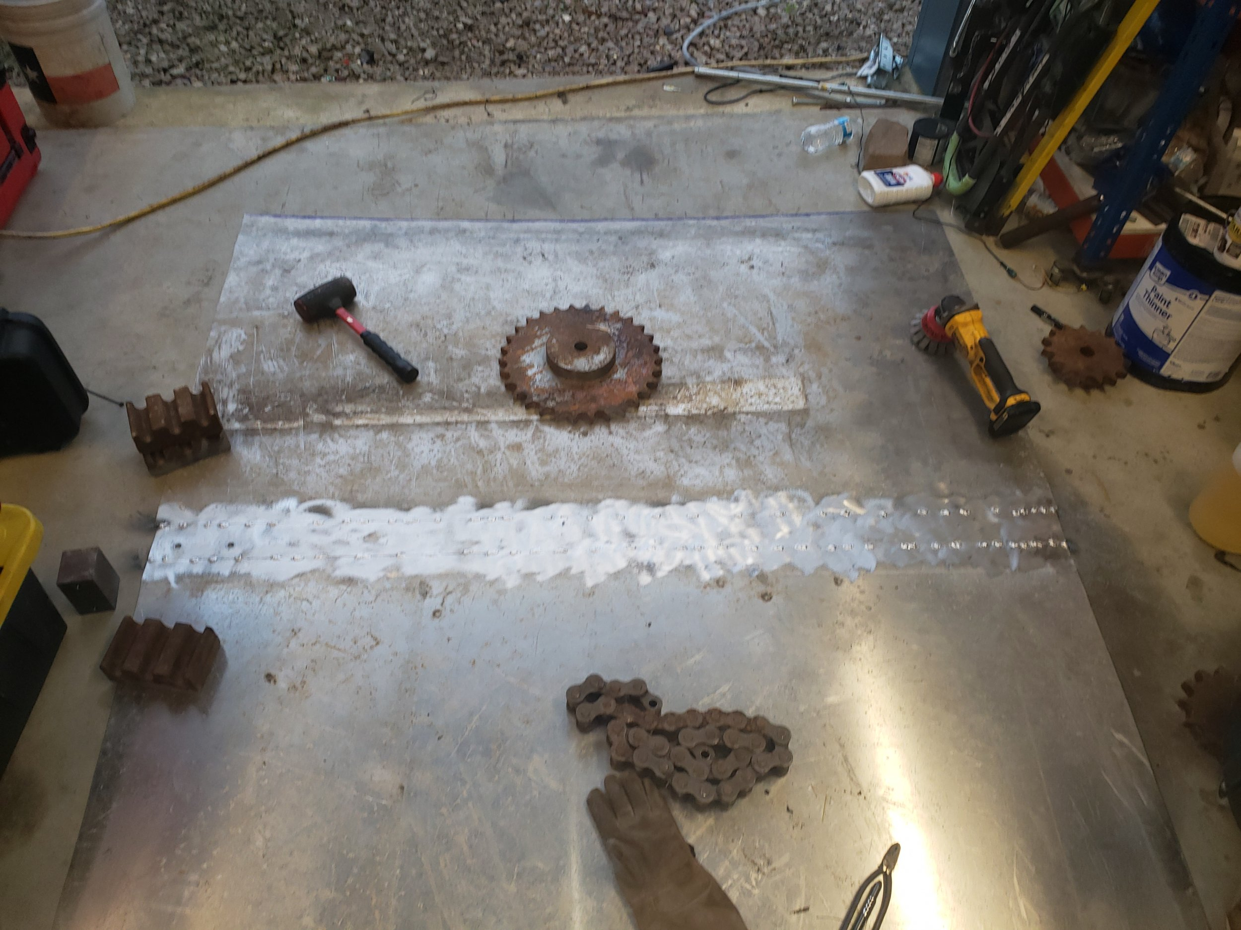

High praise! Too high, I'm afraid. I'm a novice fabricator at best. I just have a habit of biting off more than I can chew and then being too stubborn to spit it out. There's a reason I didn't post any closeups of my welds. They're... "functional."
Here's my first attempt at stitching together the aluminum sheets for the deck; I made an aluminum taco:
I guess you can't really see it in the picture but there's at least a 5 degree angle between each of the sheets.

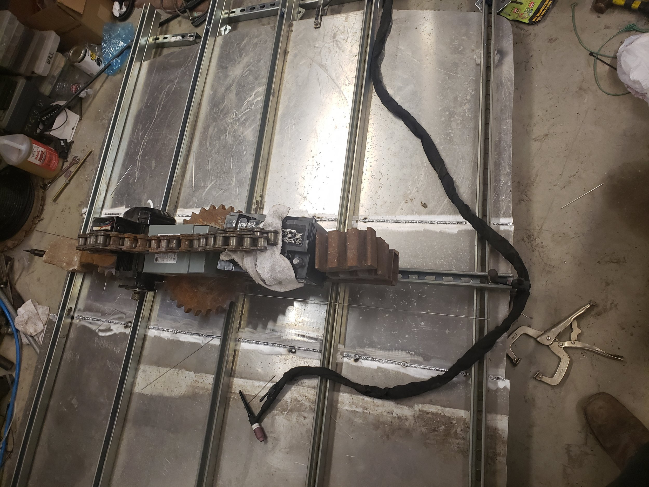

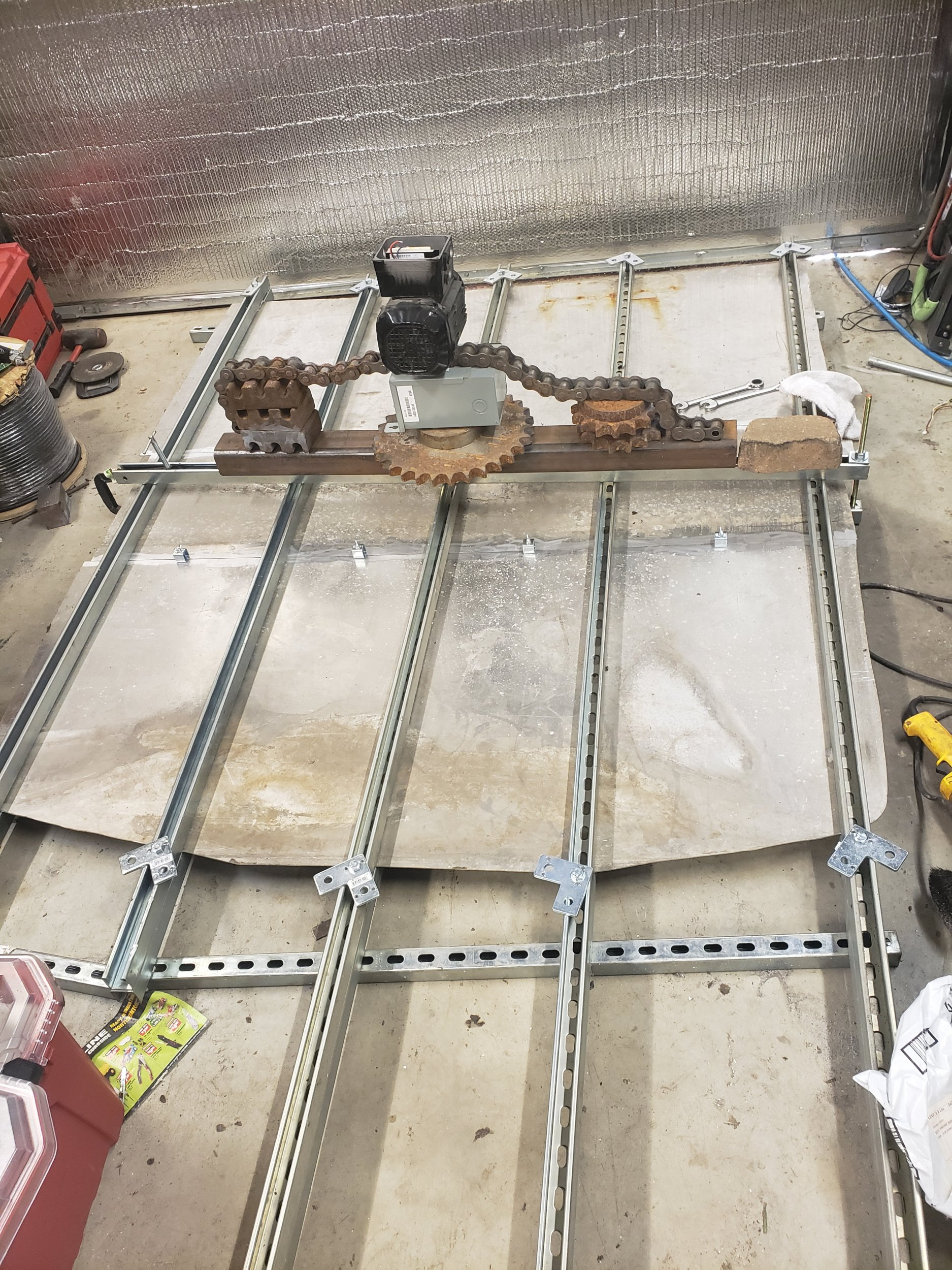

After my failed attempt at welding the aluminum sheets together with the MIG/spoolgun, I decided I would cut that warped middle section out, make a new middle section, and I would not try welding them again. I would just silicone between the edges. Well I did all that (minus the silicone) but after putting the sheets up on the frame and walking on them I was not happy with it. The cut lines of the aluminum do not line up with the lateral supports on the frame so there are edges of aluminum floating freely with no support, and they bow when you step near them. So I had to choose between welding in more steel support under the edges of the aluminum, or try welding the aluminum again. I tried welding the aluminum again.
This time I used the TIG machine and I clamped the sheets tightly between unistrut to hopefully keep them from warping. Not sure if it worked but I will find out in the morning.
