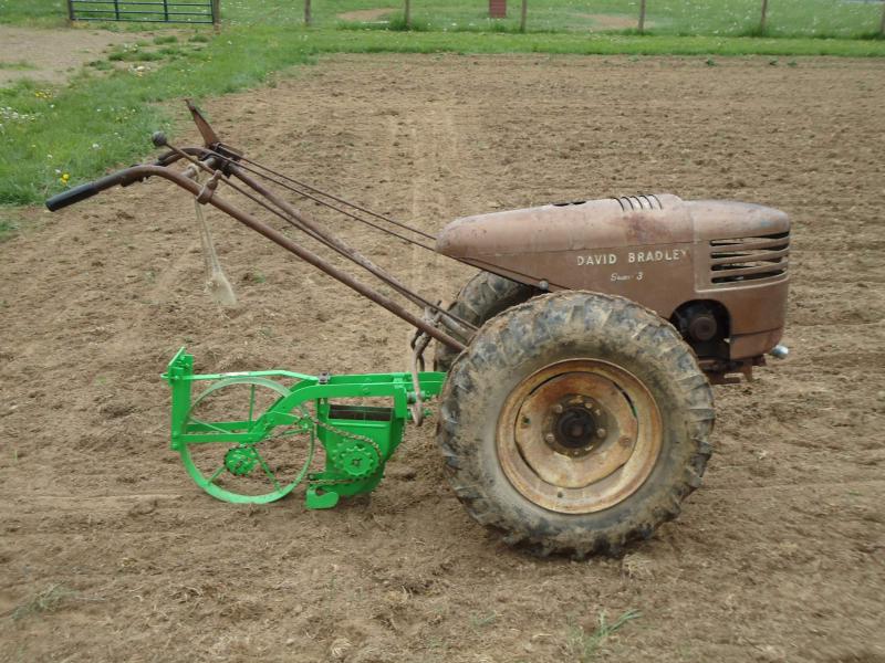

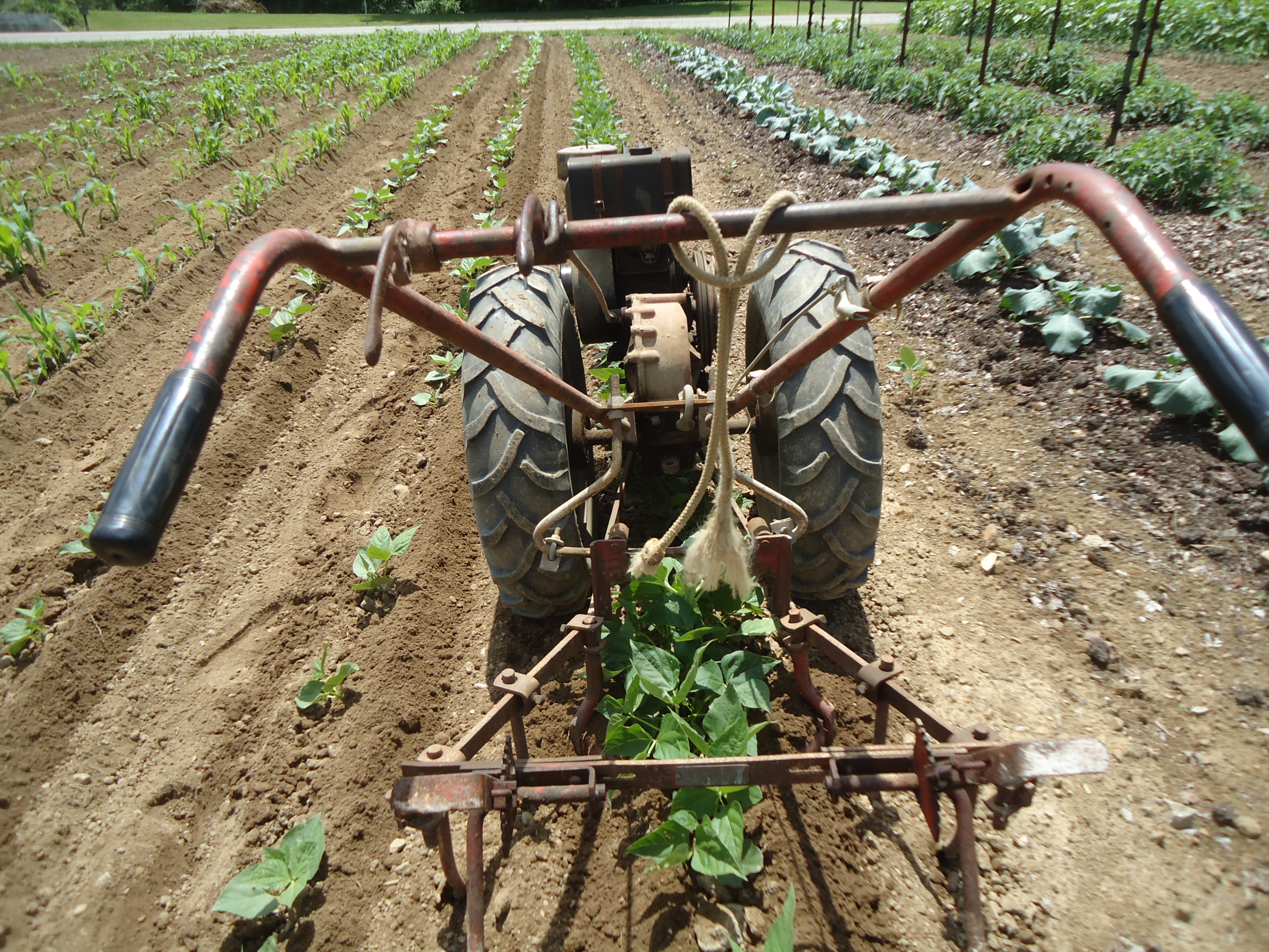

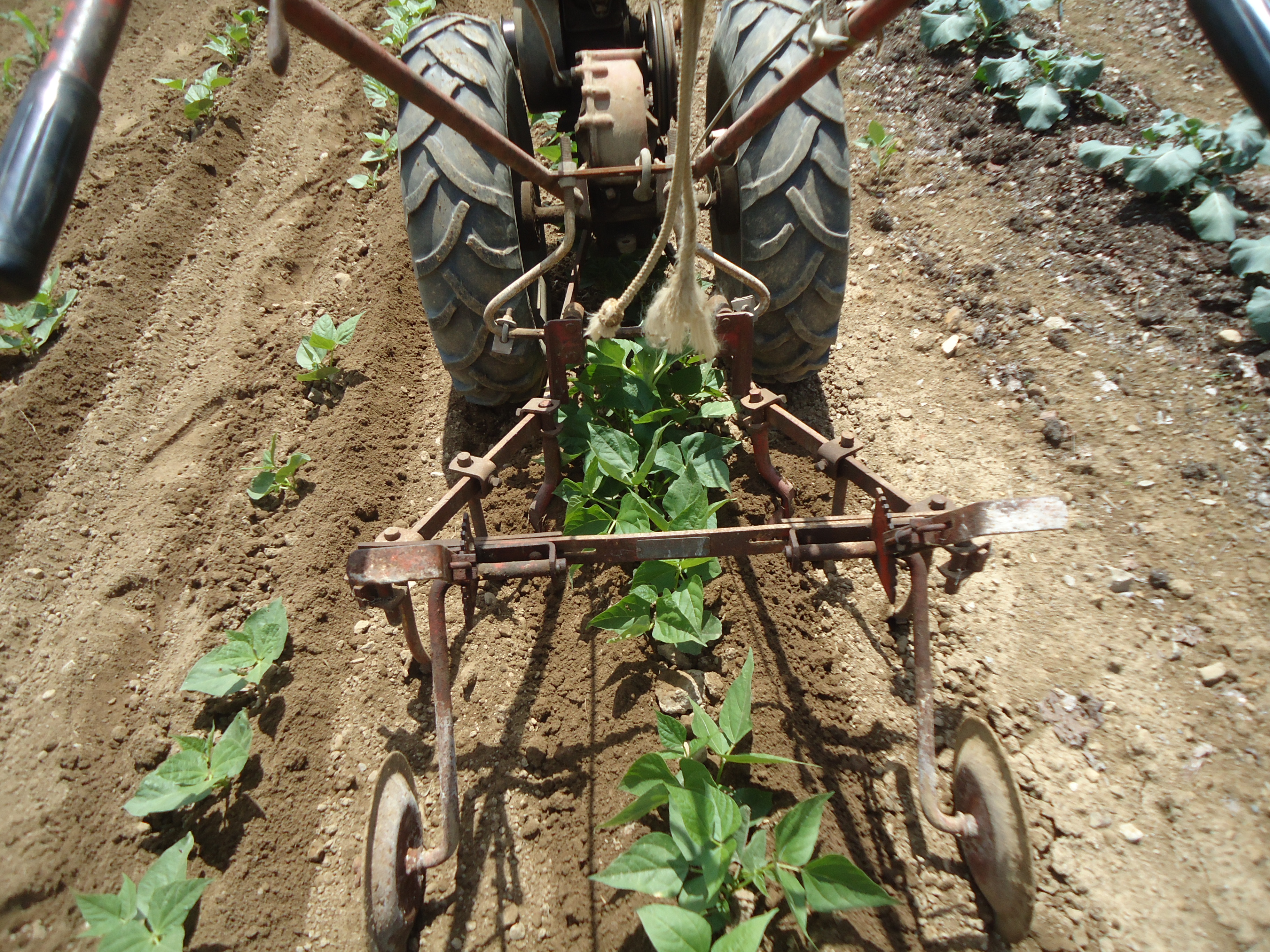

I use the David Bradley 2-wheeled garden tractors in my garden. We've pretty much used them, since Dad bought his first brand new one in 1954. I actually have 5 I use, with different set ups for cultivators, for various plants, and plant height. I can cultivate corn up to 10-12 inches tall, providing it hasn't rained recently, and the stalks have toughened up. Most have been bought at auction for under $100, most with at least 2 attachments. They can be easily re-powered with a good used, or new if you prefer, 3 hp Briggs engine, and a lot are using the Preditor engines from Harbor Freight. I've picked up 6 hardly used gas powered edgers, with Brigs engines, for cheap power, if I need an engine. Many can be bought this time of year for $35-
$40.
Many Market Garden growers are now re-discovering the smaller tractors like these, and some farm as much as 5 acre fields with them. I space my rows at 30",so as to get more bang for the buck out of my garden space. Double that width, for tomatoes.
2 years ago over the winter, I took a spare chassis, bought a home made wood splitter for the hydraulic components, a hydraulic motor off ebay, and fabbed up a frame, to make a plant setter. I works amazingly well, and was able to set 14 dozen tomato plants is just under an hour. I know my old achy knees sure did appreciate that. Below is a youtube link, of me trying the transplanter for the first time. I should have ran over that spot with a disk, to loosen the crust, but it still did a decent job.
My garden is approx. 1/4 acre, and with the 30" row spacing, can grow huge amounts of produce.
MOV2153 - YouTube
