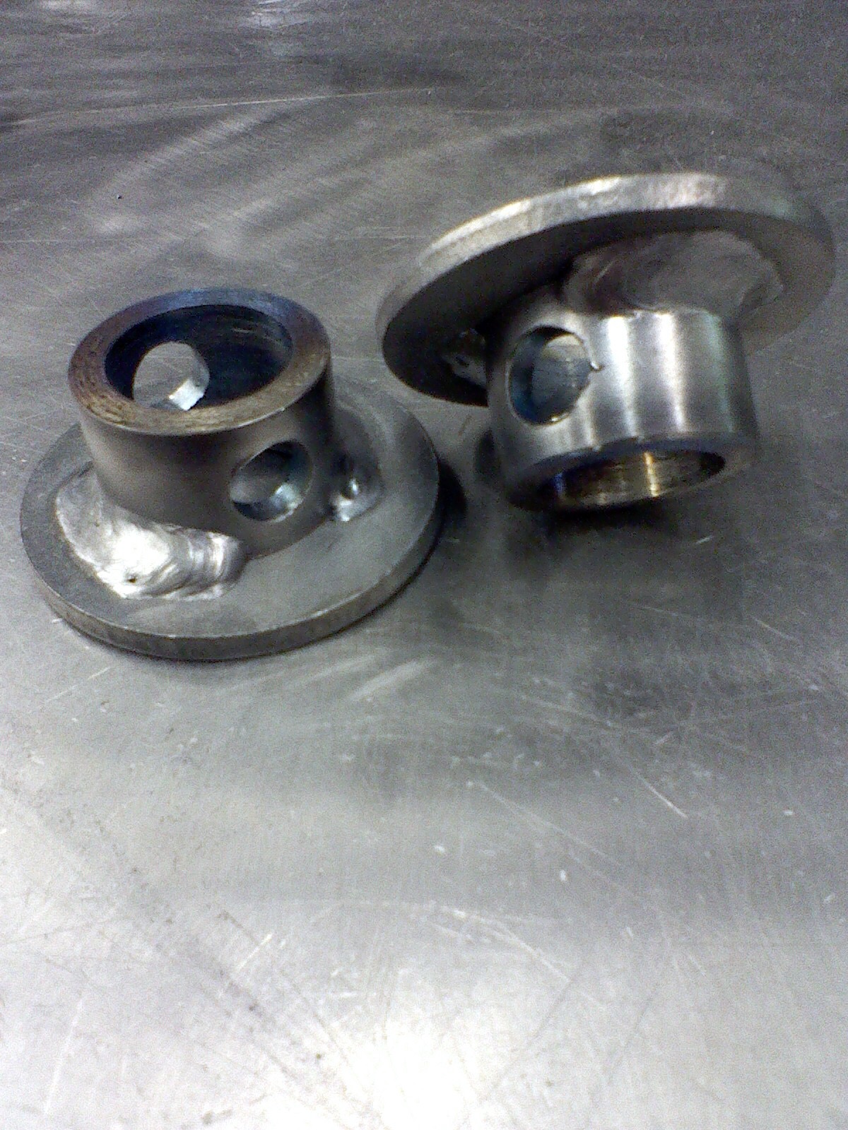

Since I was bored and had the time though, I made mine a little fancier in case anyone wants a different idea, heres a pic

I actually saw those when I was searching. They're nice! If I had the stuff to build those easily, I would in a heartbeat. Sadly, I don't, so I'll just sit here and smack washers with a big hammer. :laughing:

Thanks Dieselmh - I've been wanting some. Somewhere I got a price of $5/each. Can't swear it was from Pat's, but I can't think of anywhere else that price would have come from. Anyway - it's TSC for me tomorrow. I need about 2 dozen. But just for kicks, I'm going to make a set like LD1 made. Except I'm going to paint my set with fluorescent Kubota New Orange; hehehehe
I sure can't believe LD1 showing us all up so bad.. But heck - he's aren't even PAINTED :)) Congrats to you both; fine job.

LD1,
Did you use one inch round tubing to make these I assume?

I really dont remember now it was so long ago. And dont have them anymore because I upgraded tractors and quick hitch.
Since the pins are 7/8" diameter, I doubt I went with pipe. I probably used 1-1/4" or 1-1/8" roundstock and drilled it out to 7/8" ID on the lathe If I had to wager a guess.
