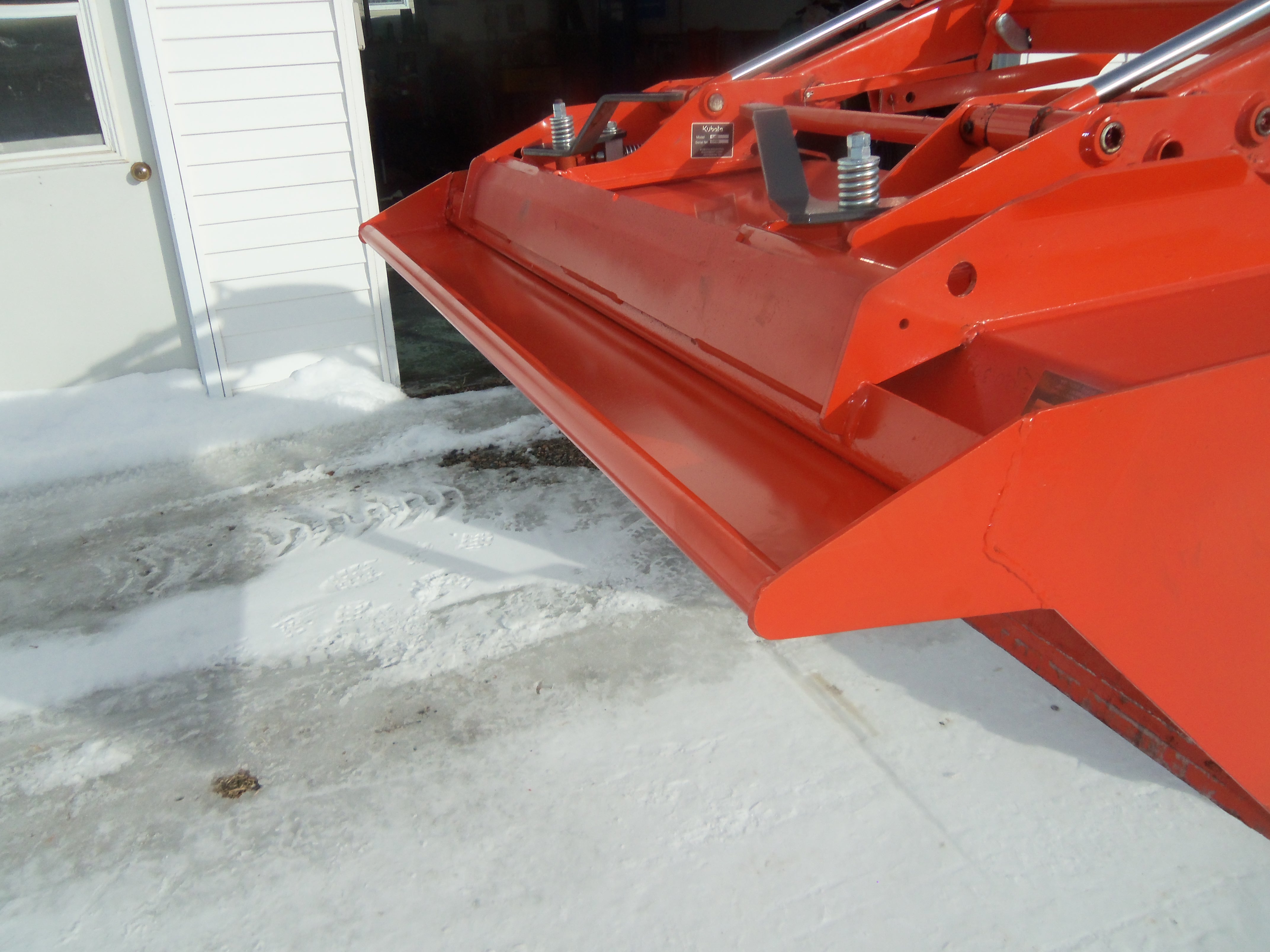

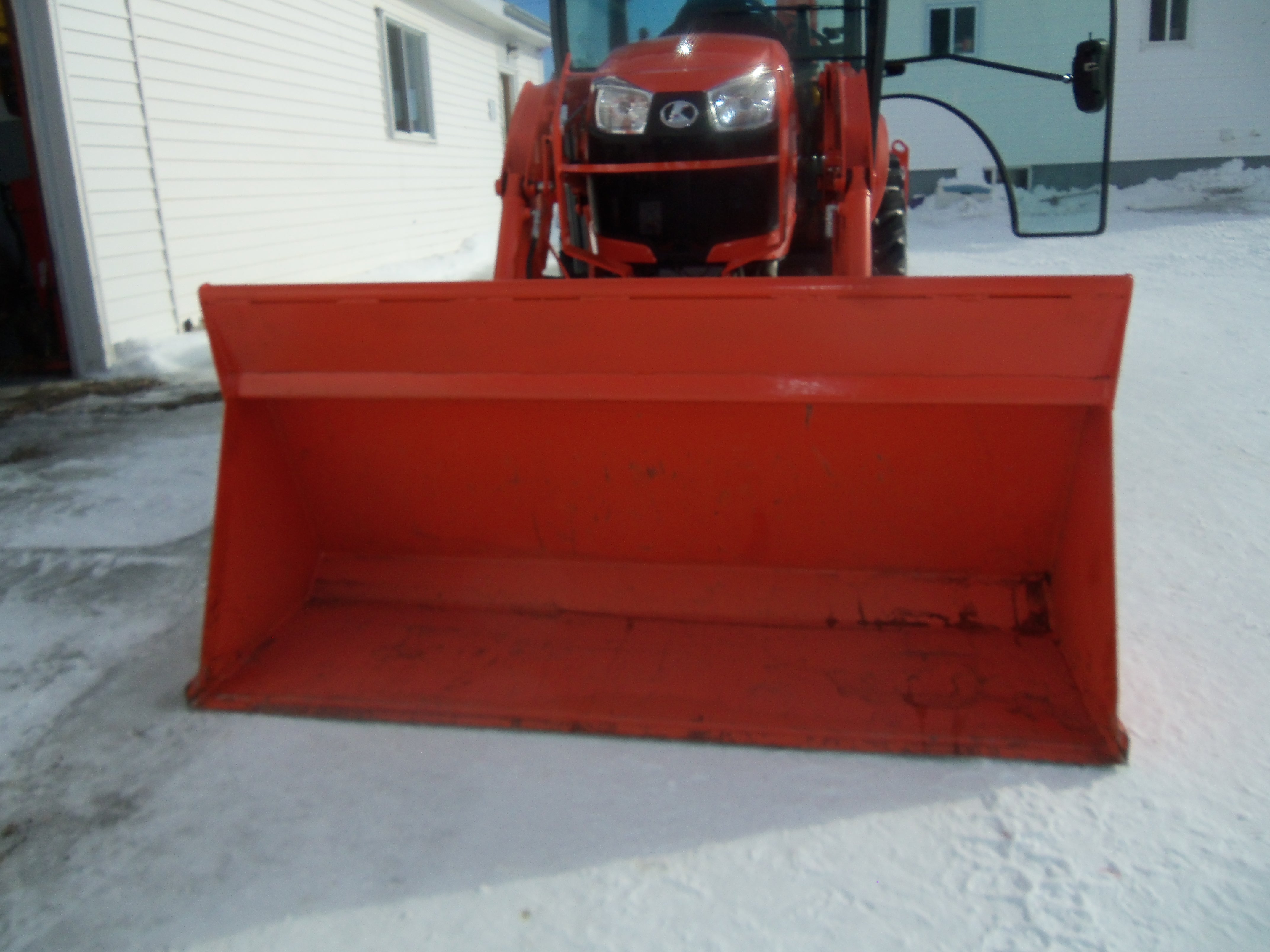

Now a L4060 had B2650
Was looking for a way to get a bigger bucket whit out going to big .Saw this on and had to make one of them spill gard I love to fabric my stuff I hate paying for shipping and waiting .This is what I made today in about 5hr . I try it out it works great to and looks like a beast lol .

   / DIY spill Gard for my B2650 #5
I agree, very nice work. Would do well with snow.
   / DIY spill Gard for my B2650 #6
It looks like it came from the factory like that. Nice work.
   / DIY spill Gard for my B2650 #7
It's nice, and gives you ability to move more material in one pass. Just have to be cautious when rolling the bucket down (like in the 3rd picture) you're reaching out further than you're use to when back-dragging.
   / DIY spill Gard for my B2650 #8
Great looking spill guard,,, :thumbsup:
Is that a "skid steer" bucket ,,, the bucket does not look very deep,,,
I wonder if you would like a deeper bucket,,
My bucket has about double the depth of that bucket,, I can carry a huge volume,,
(the bottom of my bucket is twice as big,, making the bucket "deeper")

Thanks guy , it was very easy to do and cheap to make 65.00$ for steel,20.00$ primer paint and welding .
The bucket the one that came whit my b2650.no very big but whit the spill gard I cane move more snow whit out dropping some on my hood it work great ..
