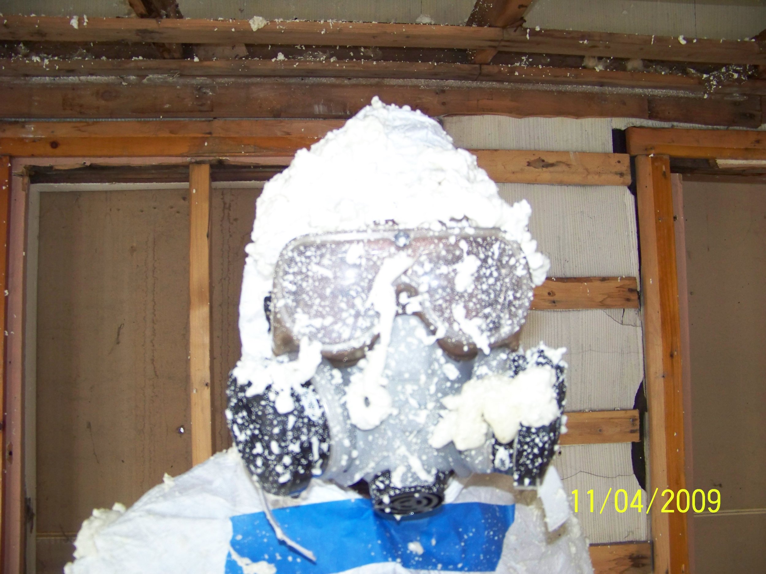

Ya, I did the ceiling of a 11x20 room a few years back!
I think I've seen that look before. See the resemblance?
We may have a new SciFi franchise...
Creature From the (Now) Insulated Quonset Shed.
