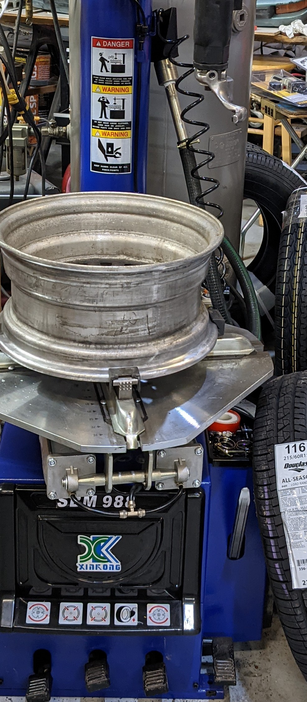

Got "Tired" 😄 of paying someone else to install fix or change my families tires.
Burned out on sitting for hours in a tire shop waiting, and paying a major mark up on tires.
The final straws were when they lifted my 3500 RAM on the Body mounts, and not the frame.
8700lb lifted through the body mounts because they were to lazy to place the lift points under the correct frame positions instead of lifting 0n the running boards.
Then also denting the trim rings on 2 of our muscle cars by banging away with oversized hammers and finally using an air impact to do the torqueing sequence.

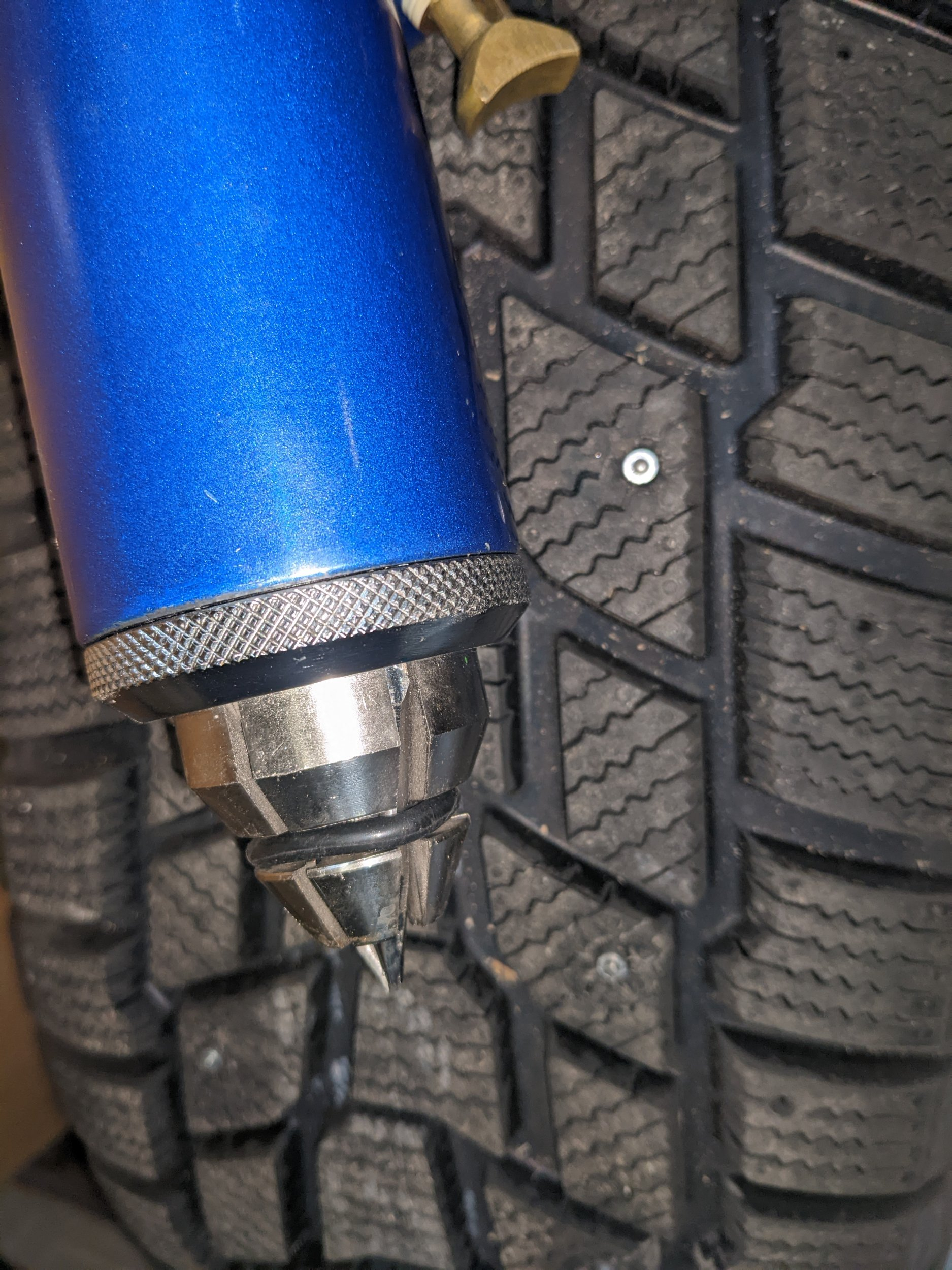

I must be nuts but have finally updated my old air assisted Coats tireman tire changing machine and also added an electronic tire balancer. I even bought a stud gun and studs for winter tires.
If it isn't done right I will only have myself to blame.

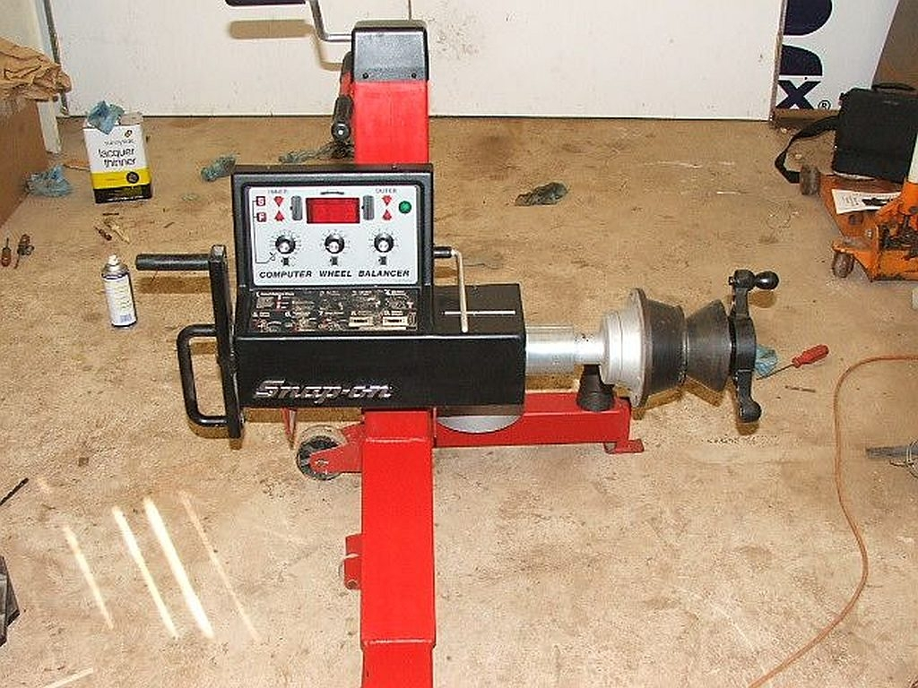

I still have a Snap-on portable wheel balancer. I haven't used it in years but it worked great. It's in a storage shed now so the battery is most likely toast. It has an AC adapter you can use to run it and/or charge the battery. Turning was done with a hand crank but it only took a few revolutions to get the tire going. It was automatic after that.

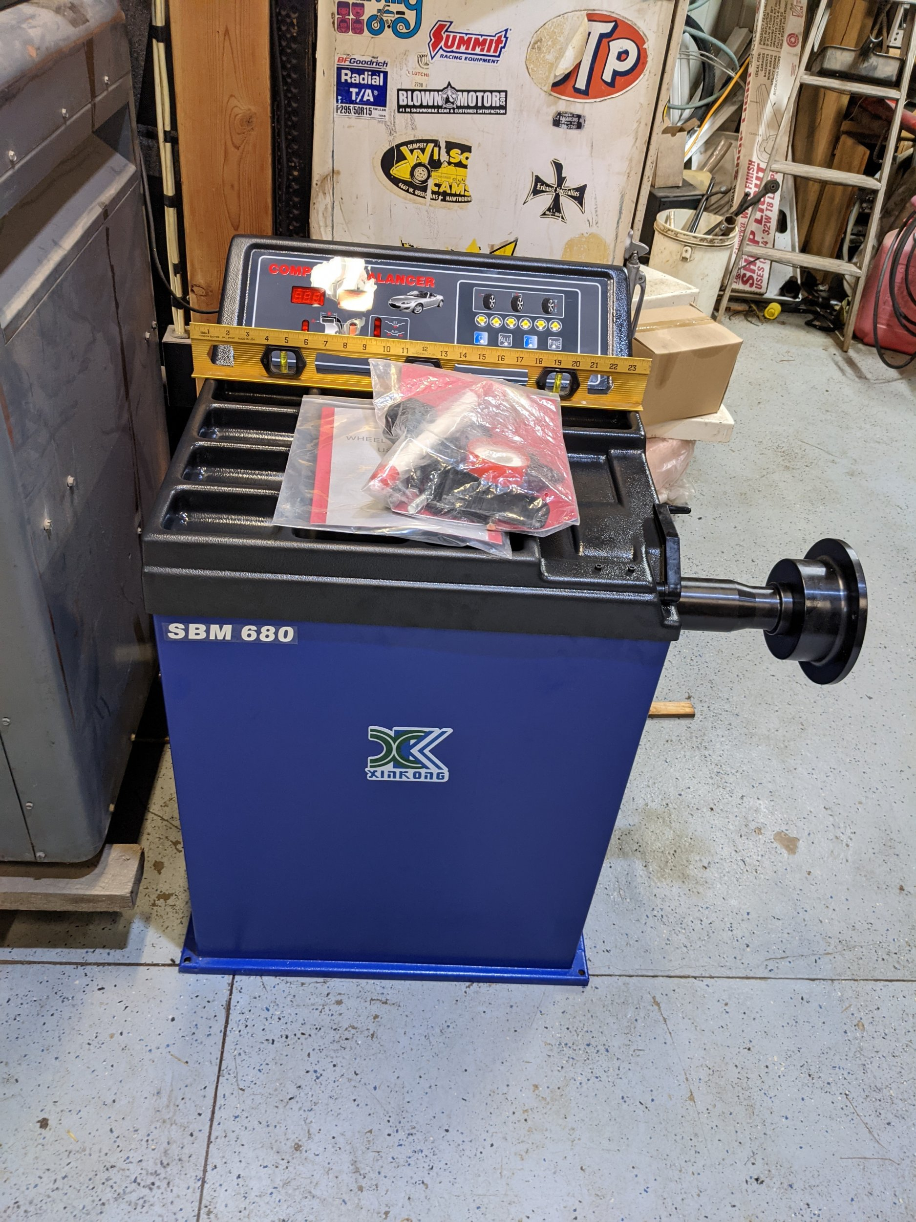

Wow our stories sound similar. I have a 10k 2 post lift, 8 vehicles 2 trailers 2 rider mowers, 55hp tractor and lots of family and friends that I am "usually" happy to help.
Used the manual machine with air bead breaker assist for about 10 years.
I promised myself when I could justify 1/2 of the cost by what I had already saved doing my own tires I would spring for new - if there wasn't used equipment reasonable and close to me.
Never found any used deals locally and looked hard for a couple years now.
Finally ordered what is called a 988 rim clamp tire machine with 2 assist arms and the 680 electronic balancer, It is china equipment, but actually has good reviews and is decently made.
What has surprised me is just in a few months since buying, the price has gone up three times to buy the same machines.
If I had bought in 2018 I could have had them for $1850
I bought 2 months ago at $2050 delivered. Thought I overpaid.
Today the price is $2700, same exact machines, from the same seller.
I have been really happy with how well the dynamic balancer works . haven't had a shaker yet after balancing.
Just bought, mounted, studded, and balanced new Cooper Evolution snow tires for the wife's Grand Cherokee, new tires for the grand kids travel trailer Waiting on tires to arrive for my converted boat to utility trailer. Still need to replace tires on my 10k load rated trailer, it is weird get to re"tire"ment age and kind of enjoy what I did as a high school and college student to make bills.
