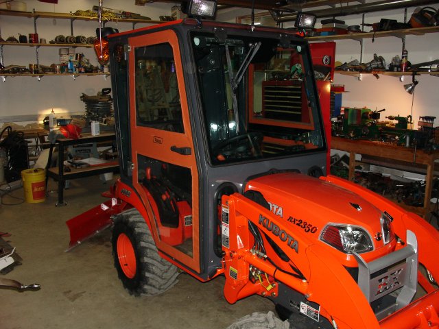

   / DIY Tractor Cab - Best materials and practices #12

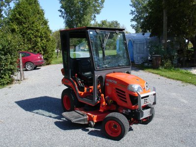

I've also started with a factory softcab, as skippy.
I've use lexan & aluminum.

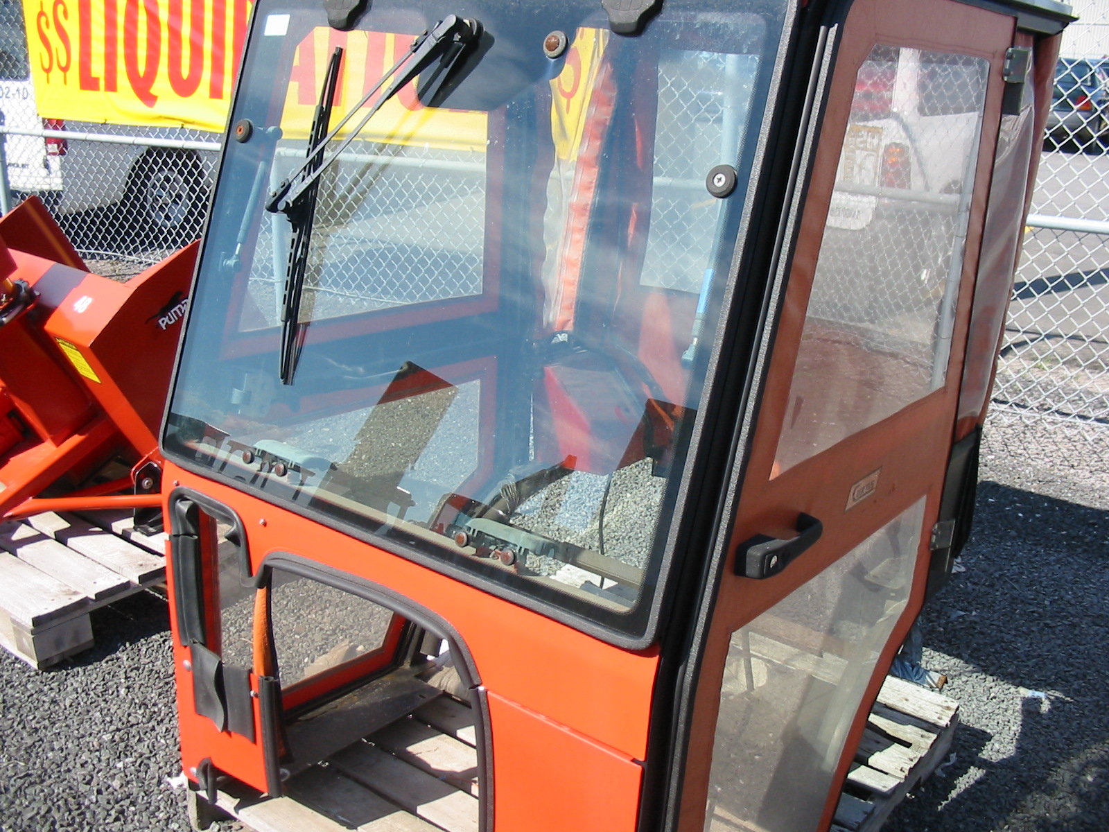

   / DIY Tractor Cab - Best materials and practices #13
There is the cab that I start with.

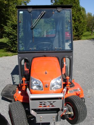

   / DIY Tractor Cab - Best materials and practices #14
outside vew.

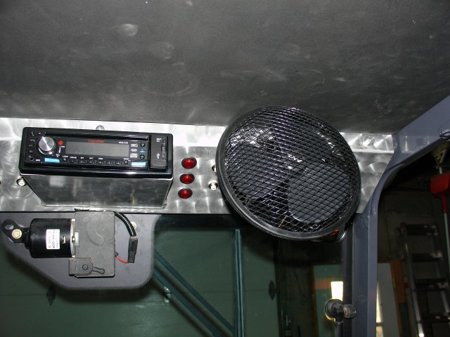

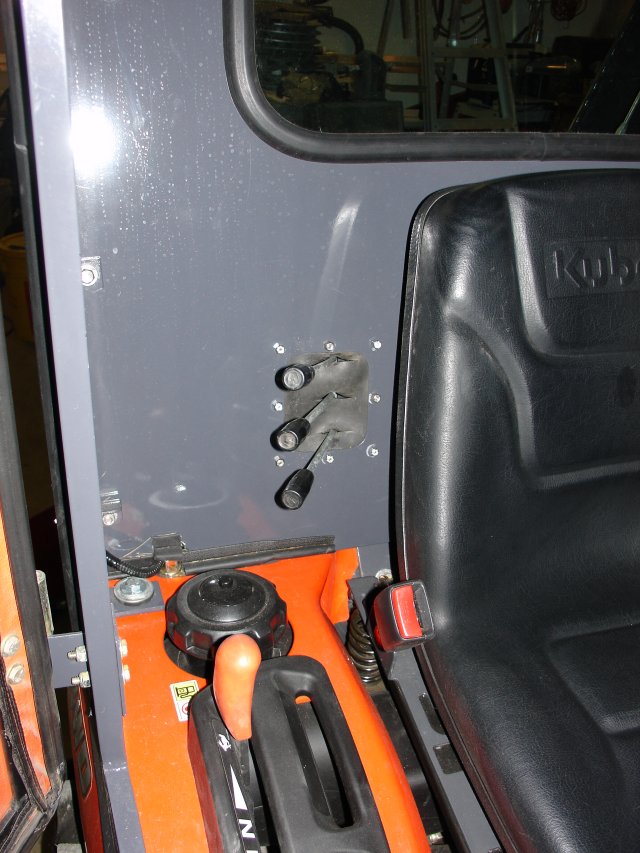

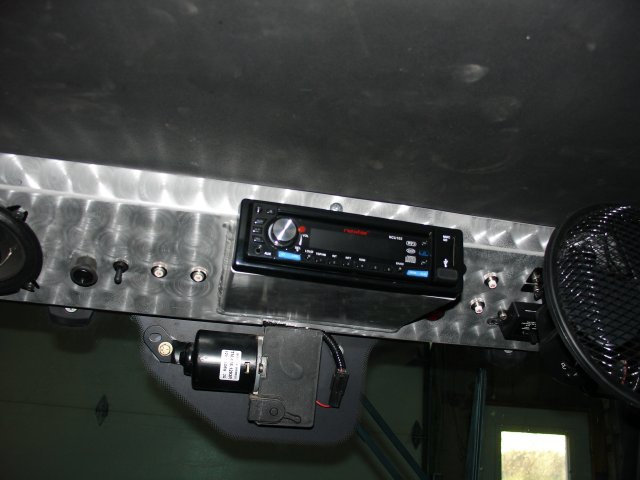

   / DIY Tractor Cab - Best materials and practices #15

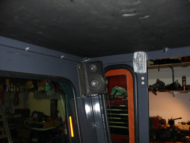

from inside.
cd player, fan, cab heater, light...
