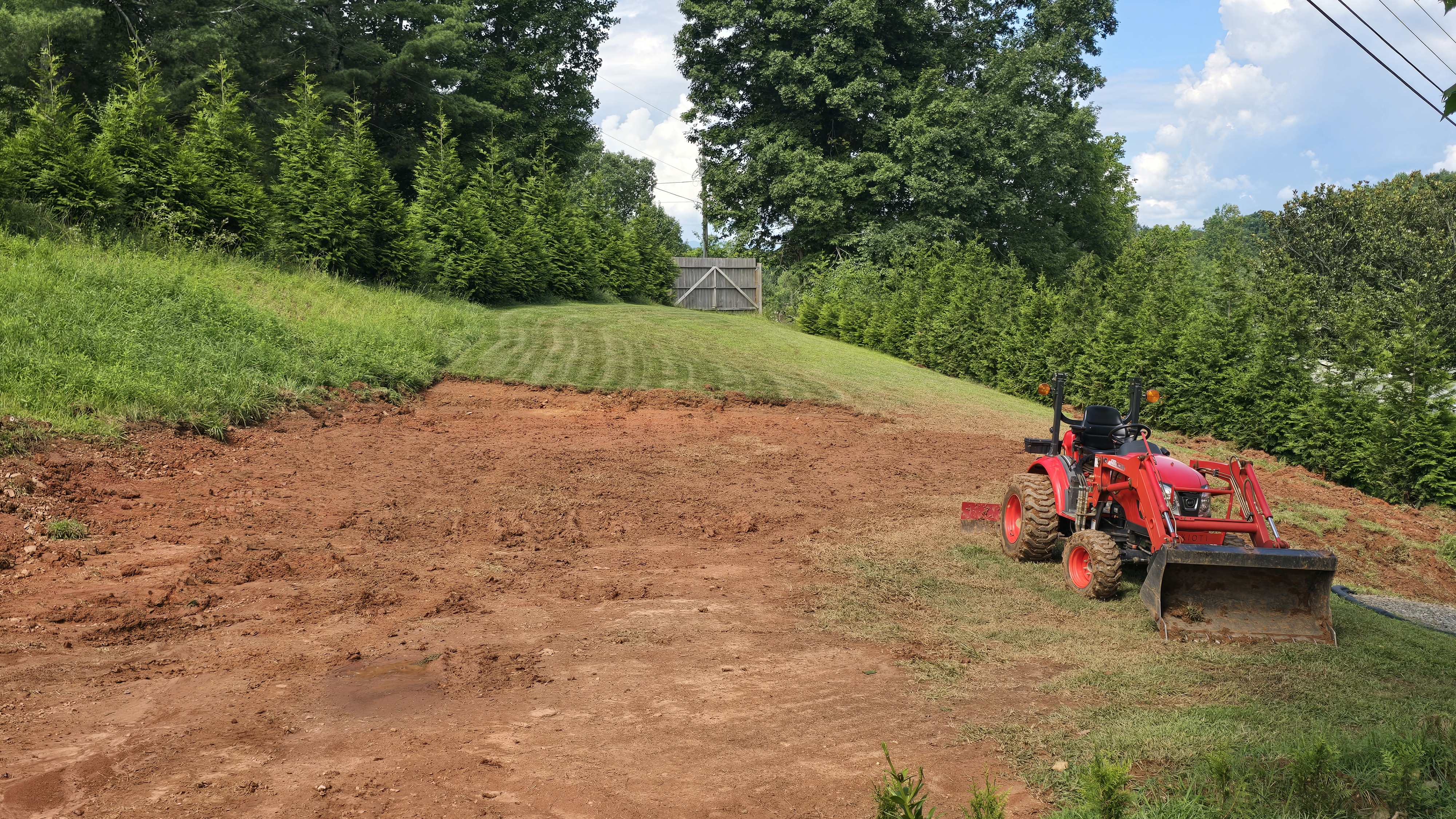

Thanks for the reply 5030,
So far I've put about 70hrs on my tractor since turning the fuel up without any issues. The pyrometer was more of a gauge to measure how much it increased in temps from stock. The stress test of going up the hill was as hard as I've ever used it. At the top of the hill the hydro bypass is being hit and that grade of hill I would never normally go up in high. Under normal usage no temp change, moderate load is +100F, and under prolonged heavy load is +150F. I can say I haven't noticed a difference in fuel usage but it's using more.
After 70hrs I can say that normal usage of digging and moving dirt I am super happy I turned the fuel up. I'm currently grading/leveling a pad for a metal building 😁
