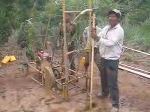

My Father and Grandfather used to drill water wells with a "Baptist" type rig. It was slow compared to a rotary but very simple and cheap to make. They could probably go down to four hundred feet or so. It doesn't require large horse power or a water pump to circulate. It does need out side water to flush he cuttings but this water is recirculated and the bit has a ball and seat which do the pumping.
[video]http://www.geocities.ws/h2oclubs/[/video]

Egon has the right idea. The method he is talking about is called balling in some circles. The method I would recommend is the cable tool method. You could buy used tools reasonably priced. All the rig has to do is spool cable (5/8") or so to allow the bit to go up and down. A walking beam is needed to drill with. This is what gives the up/down movement that does the chewing up of the material your going through. Once the material gets into a gooey slurry, you drop a smaller line down with a thin wall 3" pipe with a poppett on the bottom to bail out the material. Then repeat. Driving casing as you go. PVC casing won't work with this method. The drilling tool is simply a long 3"+ bar of solid steel about 18' long with a bit on the bottom. These rigs can be mounted on trailers. Here is a you tube link: Lifewater Drilling Technology model LDT 36 Cable Tool Drill Rig - YouTube
