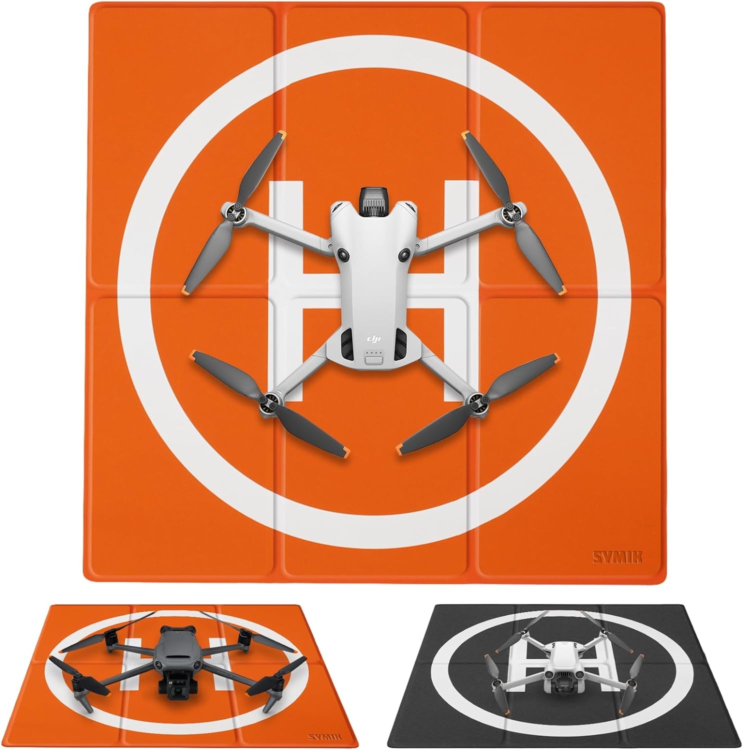

When these drones return home, how precise is the landing spot. Can I fly one off my 14' x 20' elevated deck and have it land on the deck safely?
I've seen these drone "landing pads", do they help?:
I use a pad mainly because of the grass, after take off I give the drone a couple of seconds to update the home point, which it will tell it has, then it is off to the races. When it returns home if I let it self land it will usually be within a foot of where it took off from. If I do not give it those extra seconds to update at take off it will usually be within a couple of feet.
