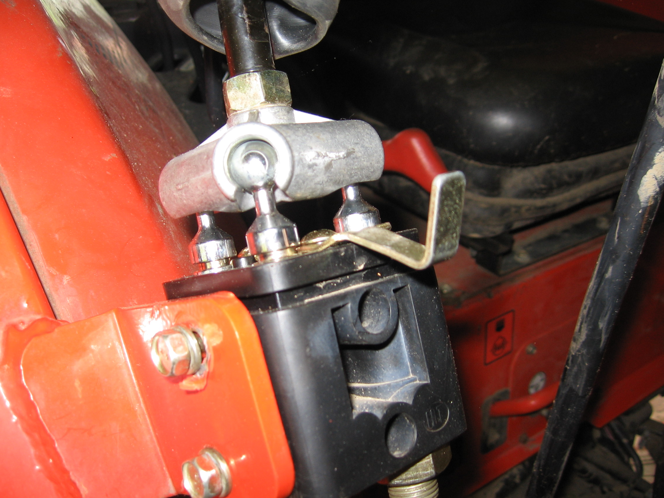

The bucket on my loader went up and wouldn't go back down.( Fortunately, it's only a couple of feet off the ground, so the tractor still works for everything else.)
When I push the joystick forward, there's no resistance, so it feels like a broken cable. Oddly, when I pull back on the joystick to raise the bucket, it works. Since pulling back pushes on the cable and pushing forward pulls the cable, I wonder if the cable could be broken, but the broken ends will push against each other. Naturally, they will separate when I try to pull.
Now the problem is how to get the cable out. At the joystick end, I can't see how to get the ball ends out of the slots in the controller. (Mine came with the metal balls, not plastic) I gather from the discussion on this forum that the ends are supposed to unscrew, but I'm not sure if that applies to my tractor, since there doesn't seem to be any way of gripping them. The cable sheath unscrews from the block all right, but that doesn't seem to accomplish anything.

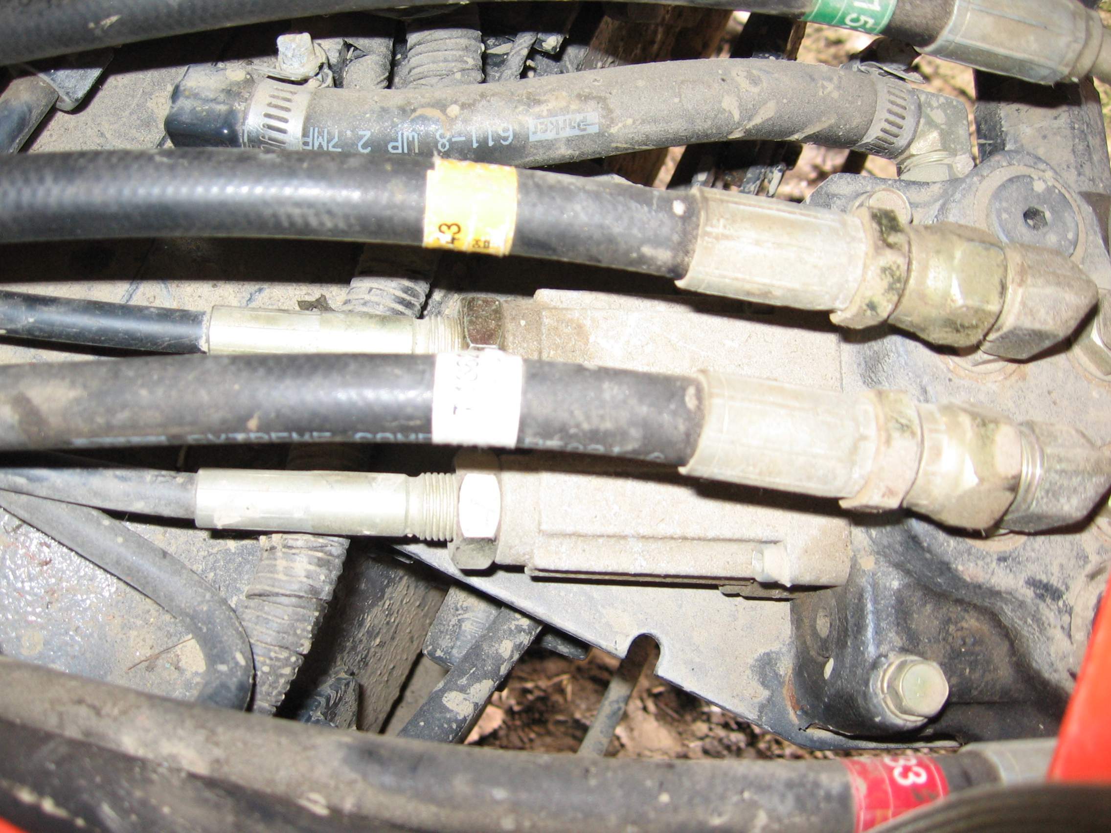

At the valve end, the valve looks a little different from the pictures on this forum which I gather are for another model. The pictures show the cables threaded into caps on the valve. The caps are held by 2 capscrews and are removable. On my tractor, however, the caps are held by 4 capscrews and at least one of them is inaccessible.

003.jpgMaybe a picture of what I'm up against will help.
At the joystick end, the cables look like the ones described elsewhere on this forum. I just can't see how 004.JPGto get them loose.
At the valve end, things are a little different. It's hard to see the valve n the picture, and almost as hard to see it on the tractor. Disconnecting a hose or 2 might help, but probably not enough. It looks like the caps that the cables are threaded into have to come off the valve body. The problem is that the screws that hold the caps to the valve body are inaccessible. If I can get the caps off, is the cable connected inside the cap? I have the shop manual for this tractor, and it has a nice picture of the valve, but no information on how to disconnect it.

before you go removing anything have someone move the joystick and see if cable ends are moving, may only be missing a pin or something else loose. if you have to take them off they should attach under the joystick, not at the top like in your picture
/ dk 55 loader control
The cables move at the joystick end. The balls and plungers go up and down. At the valve end, the cable ends appear to be hidden inside the caps that the cable sheaths are threaded into. Are you saying that there is a way to see them without removing the caps (barely visible behind the hoses in the first picture)?

you should be able to get plungers off with pair of channel locks on bottom of plunger, might try taking top side loose and see if you move cable by hand, if its easy it might be broke

I got the cable off the valve and found that the clevis end on the cable (it looks like Kioti calls it a "joint") had broken and partly crumbled. Hardly surprising, since it was made of "white metal" ( zinc). There was water in the cap, so corrosion was doing its thing. Now I know why it took a few minutes of running on below-freezing days, ever since the tractor was new, to get the valve warm enough to allow the loader to operate. It wasn't just thick oil.

I don't know if the cab model is different, but on mine there's a plate in the floorboard that can be unbolted once the floor mat is removed. The valve is accessible, but the cable end caps are hidden behind a couple of hoses. On mine, each cap is held by 4 screws, and some of the screws are pretty hard to reach. There is another thread on here somewhere where someone posted pictures of his valve, and the caps were held by 2 screws each, and they looked easier to reach.

I got lucky, I guess. My mechanic came out last evening and had it fixed up in less than 1/2 hr. My cable was still connected at both ends (ie, not broken anywhere), but had apparently somehow loosened enough so I couldn't use the dump function. He had me push the lever all the way to curl while he tightened the cylinder adjustment on the backside of the valve (ie, thereby pulling the cable tighter), the caps for which are accessible via the left side just behind the leading edge of the rear tire. I'm glad he knew this trick, since I would otherwise have been tearing things apart that didn't need to be. I'll be using the loader a bunch tonight so I'll see if this fix is really totally OK.
