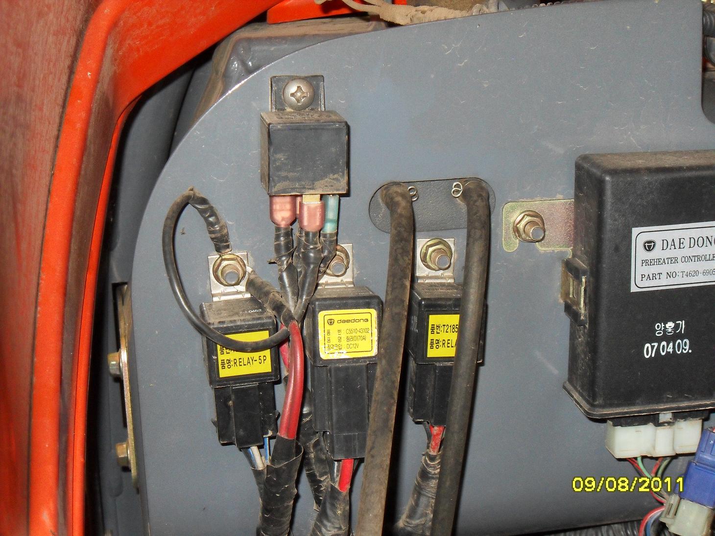

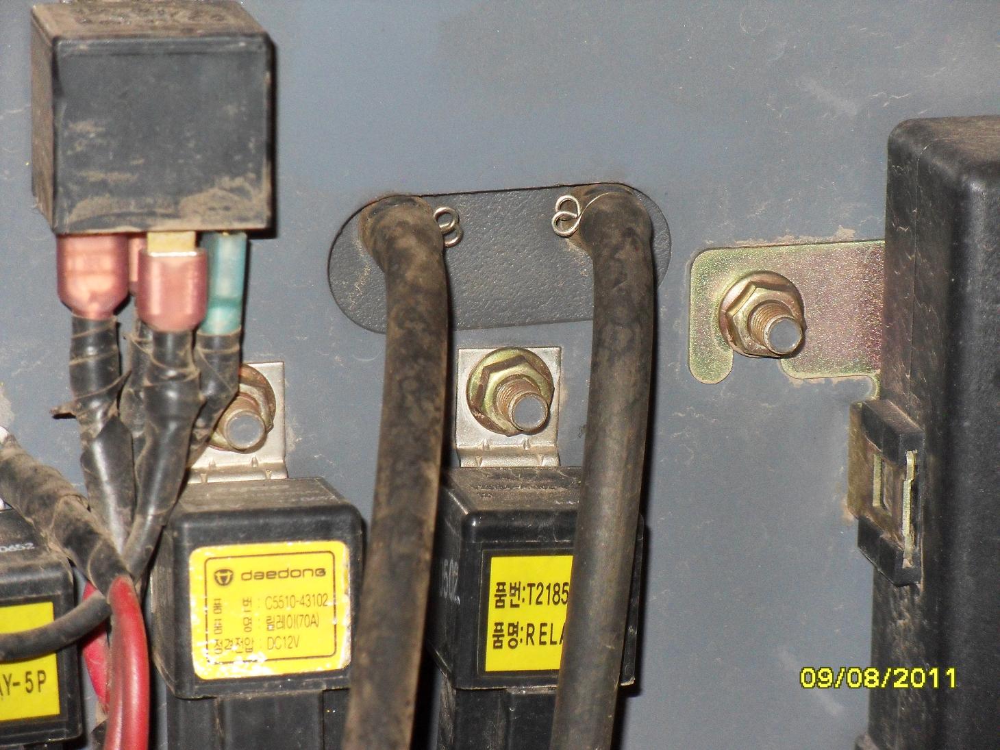

Hey MotorSeven,
I just checked my lines this am, and sure enough they are VERY close .. I can see where this will rub through given enough time .. I have about 120 hours on machine now.
Thanks for the heads up! I'll get my die grinder out and fix this.
Tractor on and THANK YOU again!!

Cow, I looked at your photo and it looks to me like you have had contact....there are lines on the top of both hoses where the metal has already touched. I bet if you check all the bracket bolts they will be tight but the tank moves up and down when the hood is raised all the way(push hood all the way open, pull down, push up, pull down), so I actually thing the tank is settling/moving in it's bracket over time.
Hey, I am glad this has kept some of y'all from having diesel spewing everywhere!
I agree .... Houston we have contact! ... hehehe ... Did you have to pull the tank out to get the die grinder in there? Or can you just loosen the shield bolts and pull it forward?
   / DK owners check your fuel tanks:
#20
No, I stuck a large screwdriver down behind it to pull it away from the tank, then I gently grinded the metal away(too lazy to loosen it all up).
