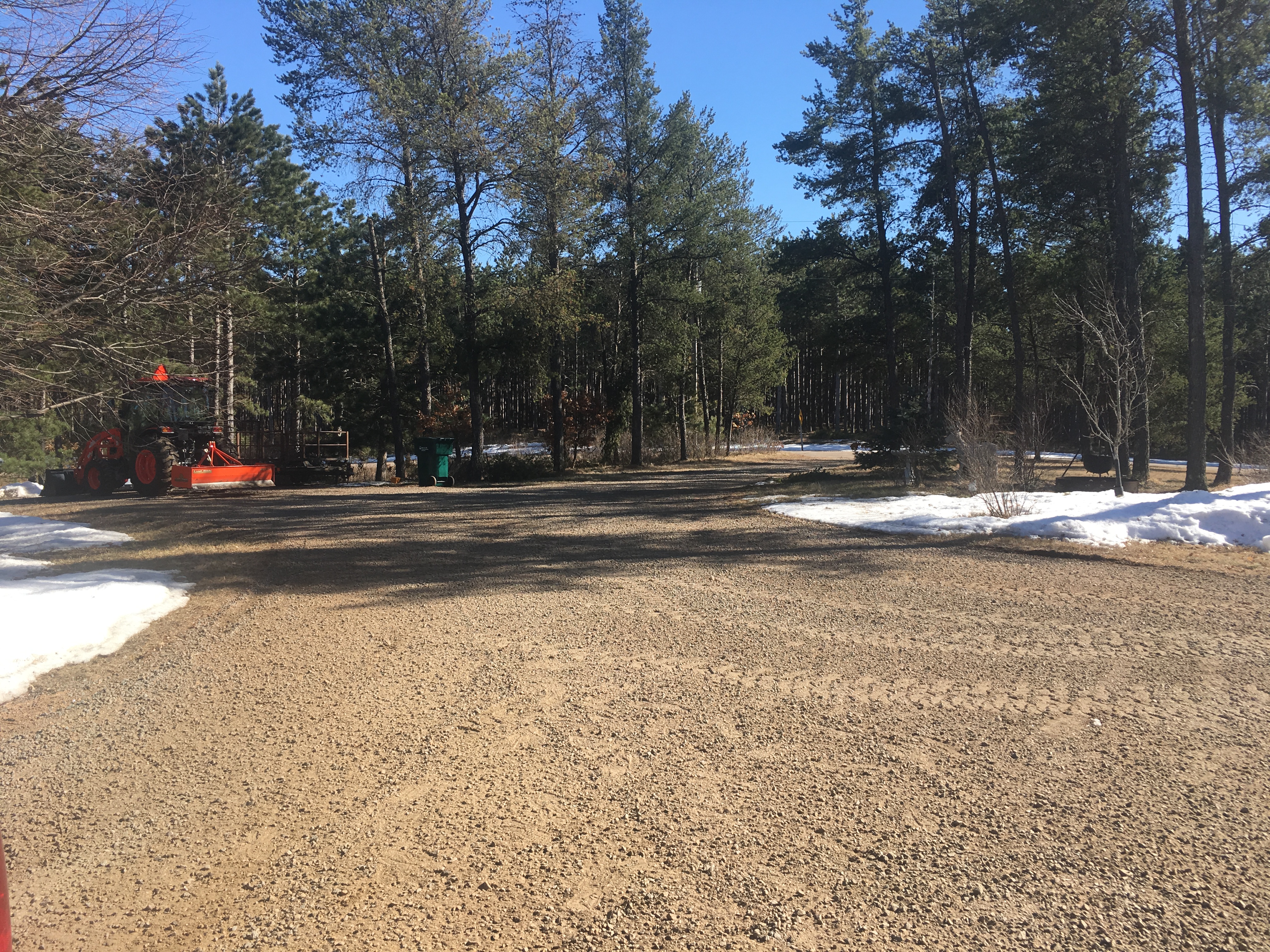

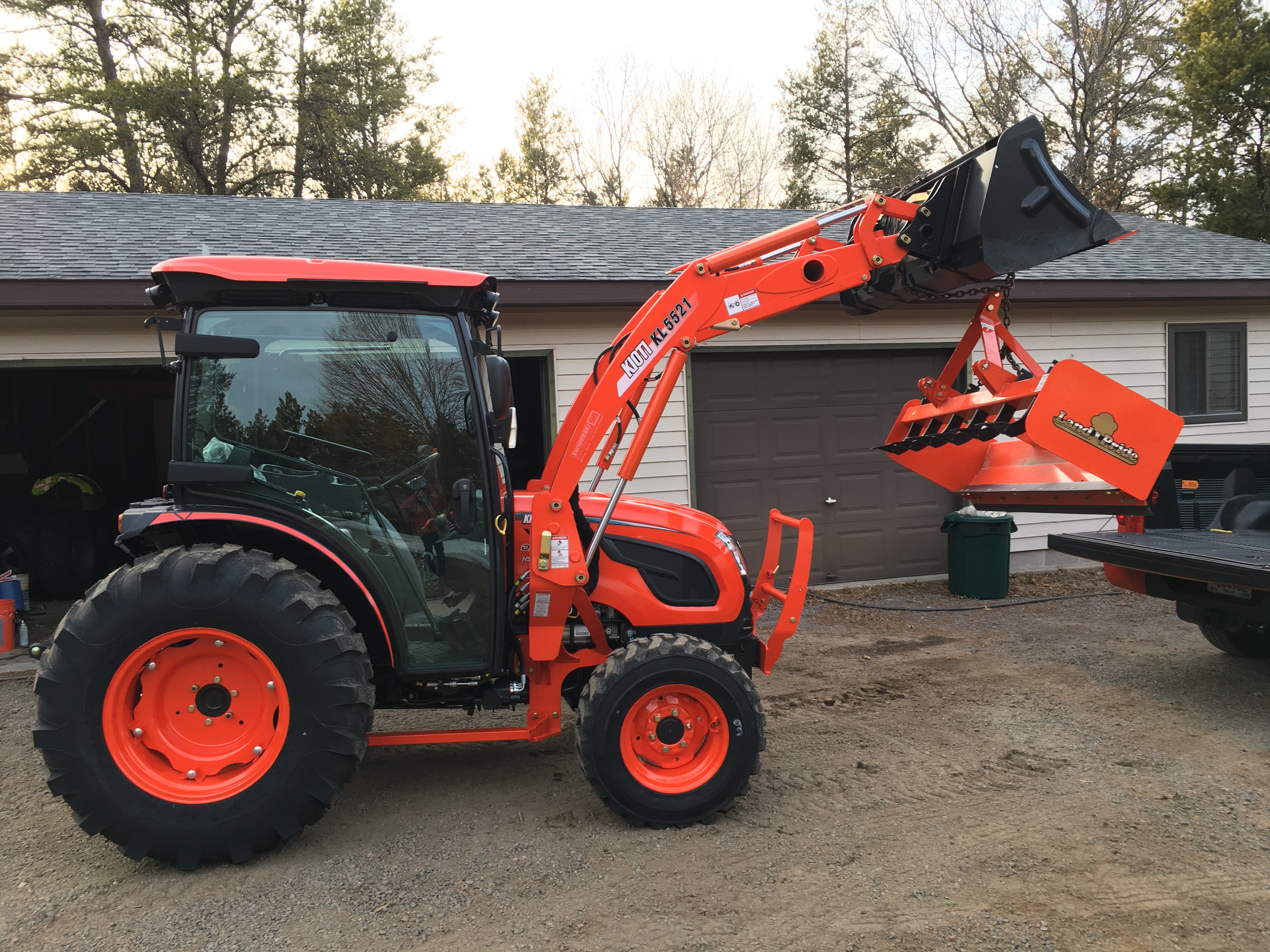

I recently had my DK4710SE HC delivered. All finished, not including tax, I got filled tires, 72" LandPride box blade, block heater, kioti cutting edge for the bucket, and the 3 hats for 29,100. Pretty pleased I went with this model! I got the tractor 5 days ago, but the box blade came yesterday. Ground is still frozen rock hard but...here some pics!
