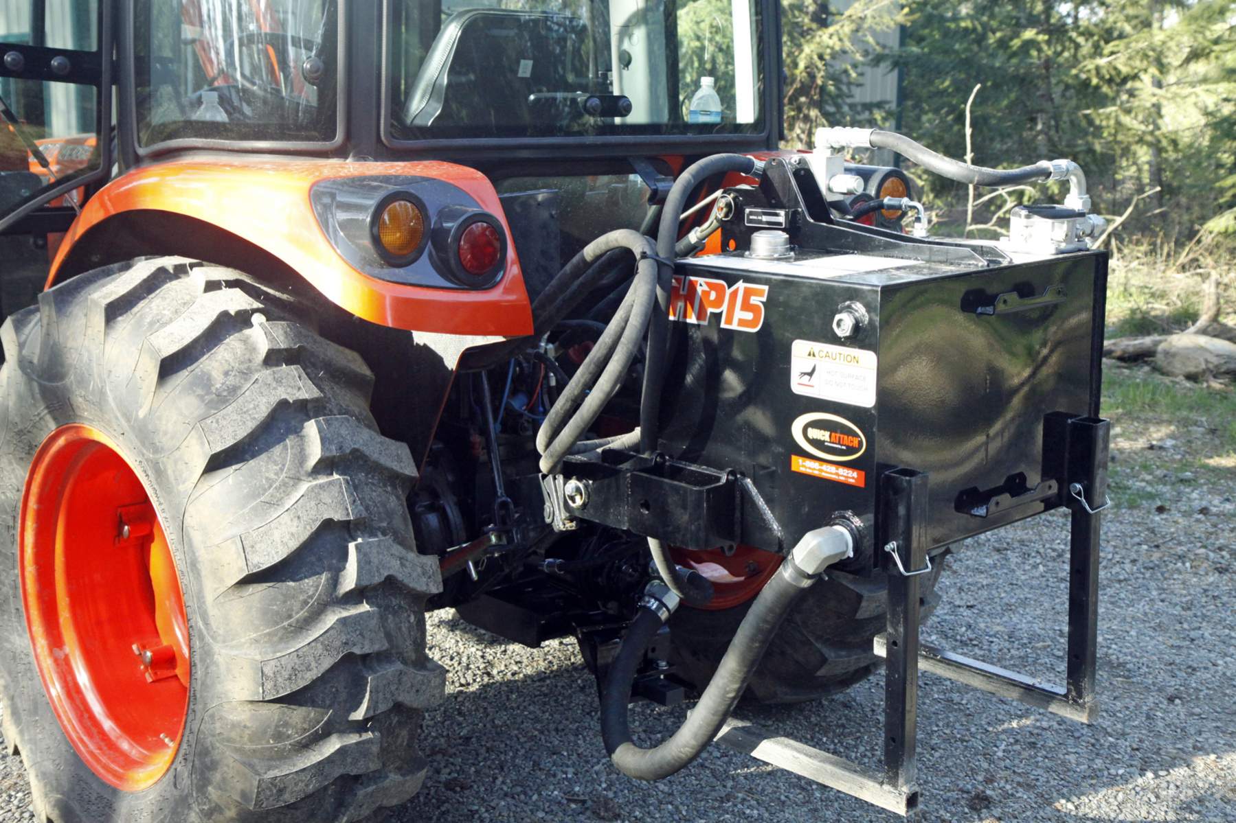

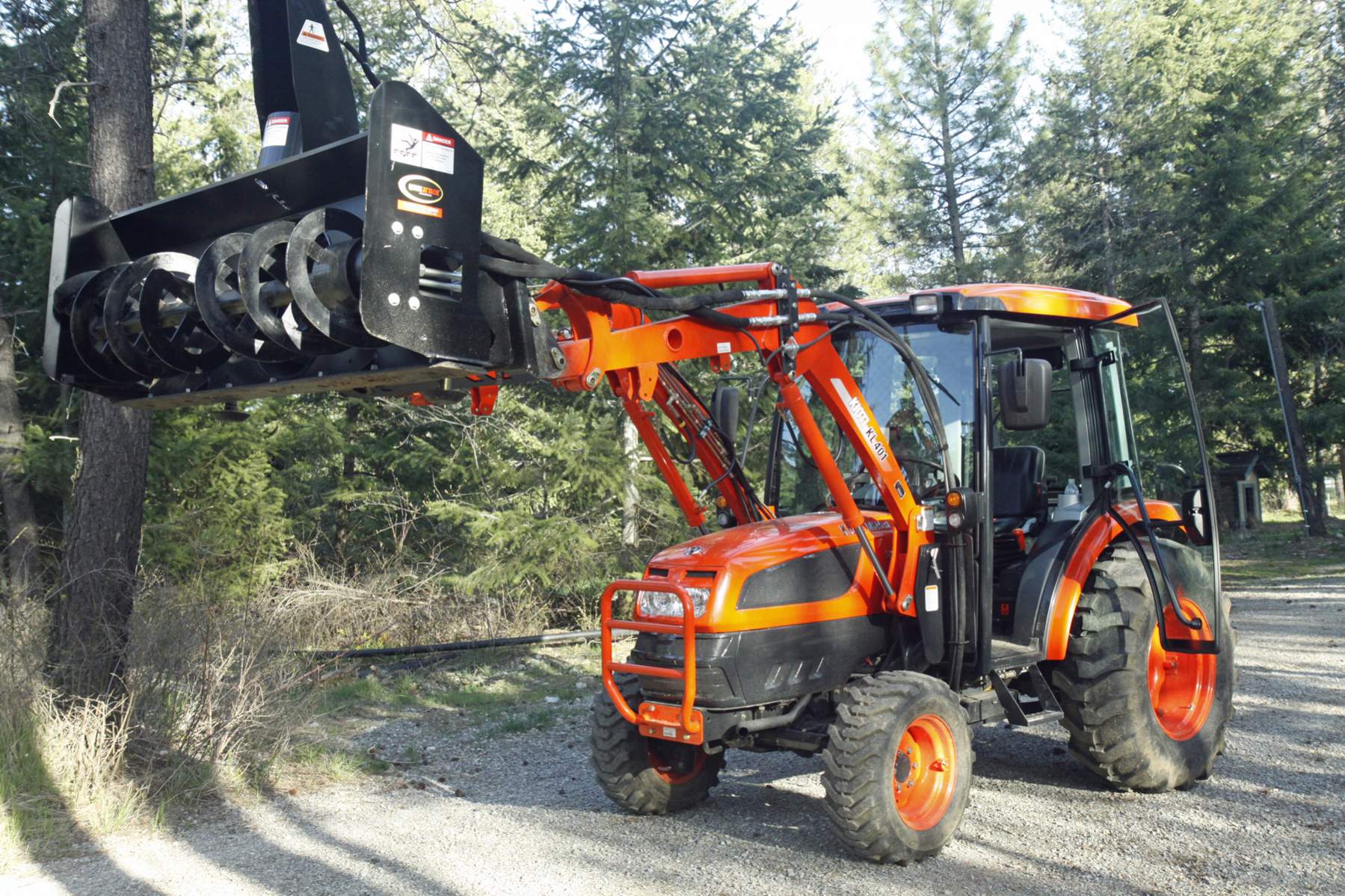

I didn't want to mess with doing it myself, but i applaud those that did. As posted in other threads i bought a "Quick Attach" brand loader mounted blower and rear 25 gal hydraulic power pack. Everything including all parts was somewheres around $10,995 . Not cheap by any means
But so far i have to say it was worth it. I have used it a few times this season already (purchased about 5 months ago) and it works as well as my old pto powered system, but no turning of my head.
Also, no shear pins. I leave the loader on so i can swap between blower, snow blade or bucket in about 2 minutes.
you can see it in action in the video section on this site under new videos.
http://videos.tractorbynet.com/video/1037/Snowblower-2011mpg
this unit is so stout i can see it lasting many many years.

Wow, You get snow drifts so high you have to use the blower at the top of the loader's reach!? AWESOME!:D:thumbsup:
